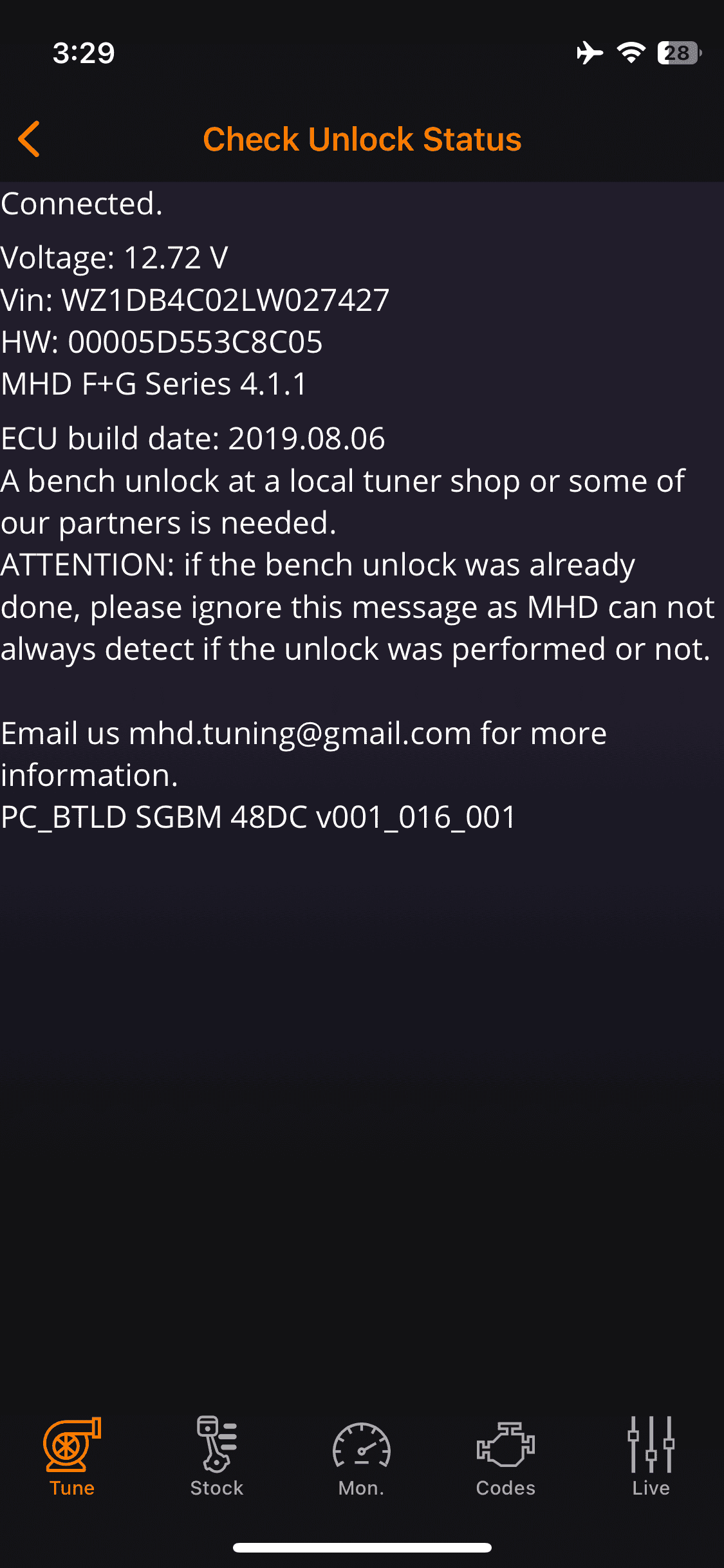

Just as stated. I have a build date of 8/2019. I tried connecting with MHD and it says bench unlock required but also that sometimes MHD can not see unlocked DME. Just wondering if you think I need to have it bench unlocked or try flashing it as is..
please see pic
Ruman
Ruman
Jan 8, 2023
43
52
2020 Supra 3.0 Premium
You will mostly likely have to get a bench unlock for this before tuning. Not really sure what happens if you try tuning without the bench unlock done, but you should be able to get a bench unlock done locally somewhere for a couple hundred dollars. You don't need to worrying about shipping your ECU off and getting a femto unlock since you have an older ECU.

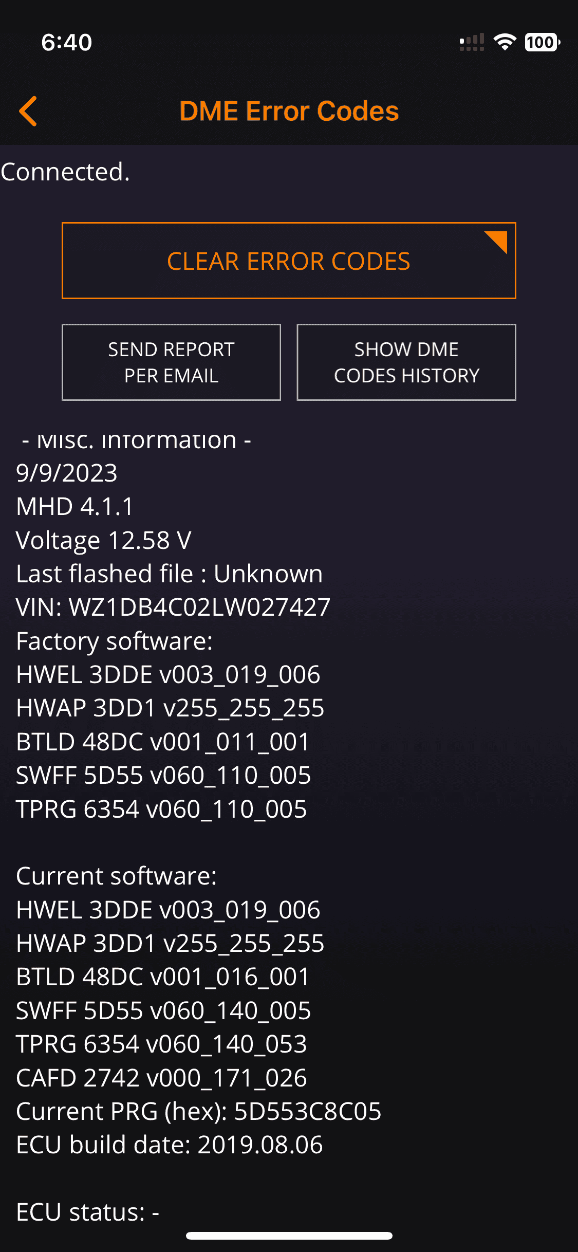

Bham_108
Brian
Aug 15, 2021
21
Connecticut
2021 Supra 3.0 Premium
Here you can see the original software then it looks like it has been updated. Let me know your thoughts anyone please. I dont mind bench flashing. Just trying to find someone around CT to donit
