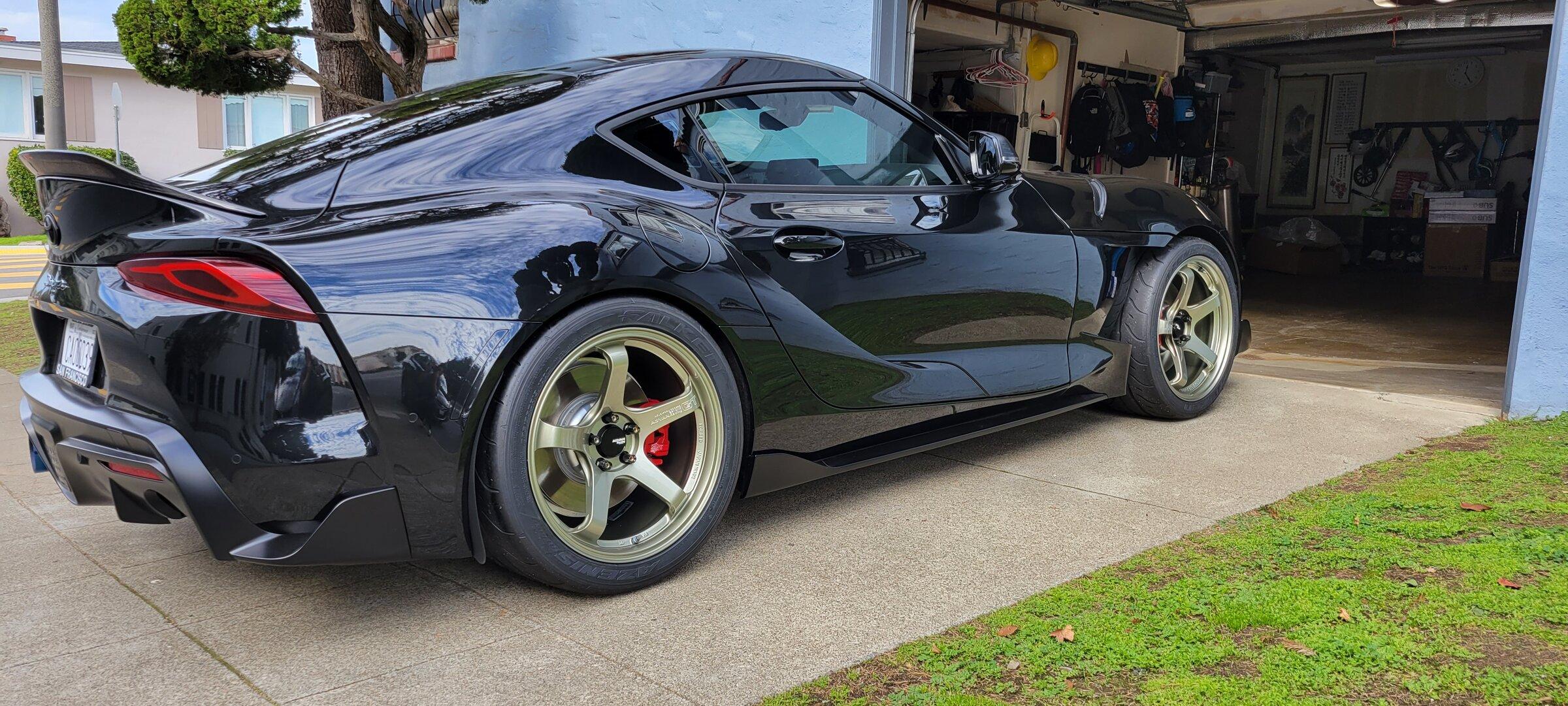

Does anyone have experience with these specs on stock suspension? Was there any rubbing at all?
19x9.5 +25 on 275/35/19-front
19x11.0 +35 on 295/35/19-rear

I haven't done squat to my Supra and seeing yours makes me super jelly.... Those look good, I would definitely go for some Advan GT's if i didn't get some for my little ol rx8.
I'm lowered on those tire specs and lowered. No rubbing but the tires sit pretty close to being flush.
How much was it lowered? Where I live I'd be buying a new lip every month if lowered.

What do you mean? I'm asking sojusoulja how much he lowered his car by to gage the space between tire and fender. I have the exact same wheels and tire specs.
Tires aren't all the same. The Falken RT660 for example runs pretty wide and they rubbed on my car with TEs. Lowered on HKS springs, 295/35/19 rear.
Not sure. I told the shop I wanted a 1.5 finger gap and left it up to them
