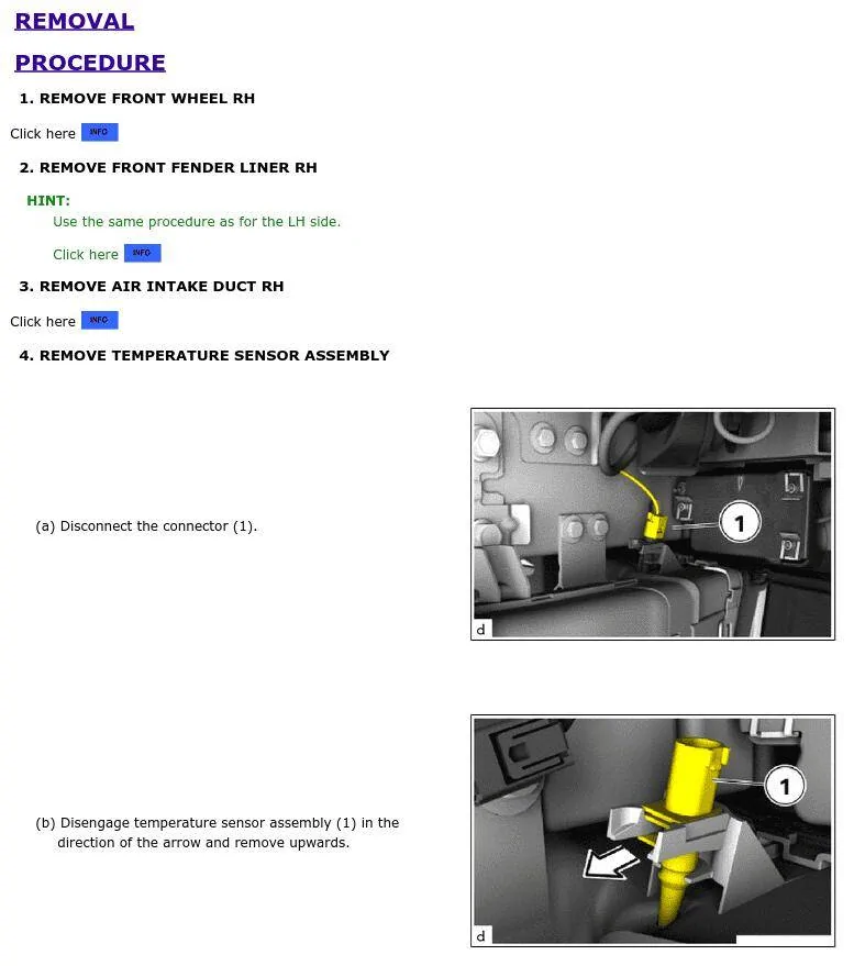

Can anyone from the experienced ones help me out locating the ambient temperature sensor? I am having a Code 10B106 - Information Outside Temperature Sensor: Short Circuit To B+

It's above the brake duct on the right side (passenger side for USA)
