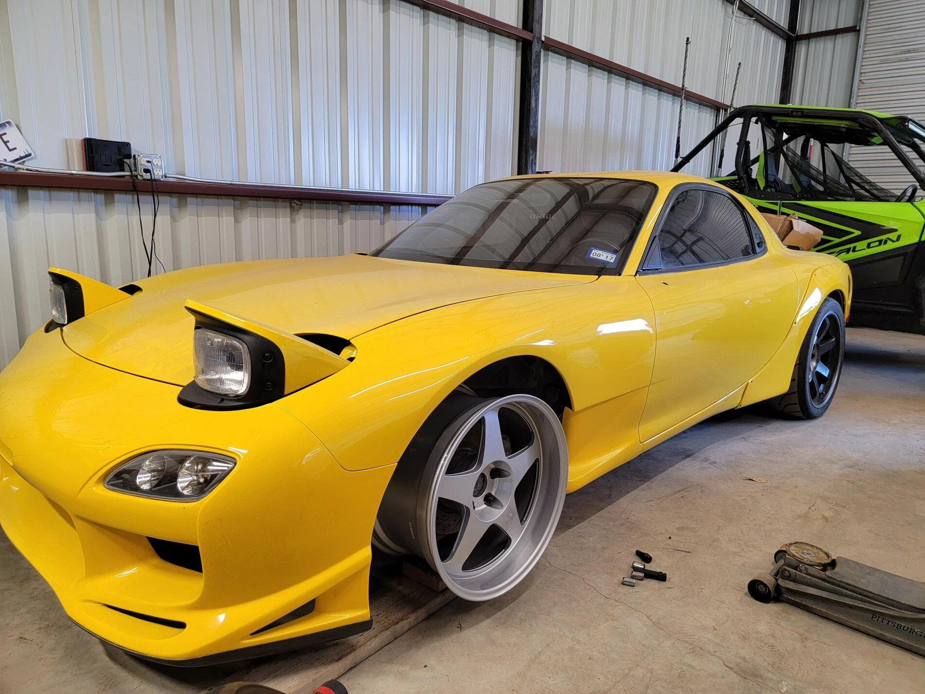

I have an extra set up wheels that I was going to run on my FD RX7 but now I'm curious if they would possibly fit the A90? They are 18x10.5 +25 (squared) Regamasters and the bolt pattern is 5x114 but I wouldn't mind getting them re-drilled or even running wobble bolts temporarily, just curious if 10.5 +25 would fit on the front of the A90.. My TE37's are 18x10 +22 and 18x10.5 +25 so I could possibly run those if the Regas are too aggressive for the front.
If you are running 18x10.5 +25 or similar to those specs, can you please post pics so I can get an idea of how it will look.. worst case scenario I will just wait and find some 19's in different specs.

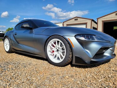

This is 18x10.5 +35 with an 8mm spacer in front (+27 effective offset)to clear the struts 295/35 NT05s were a little wider than I anticipated.
