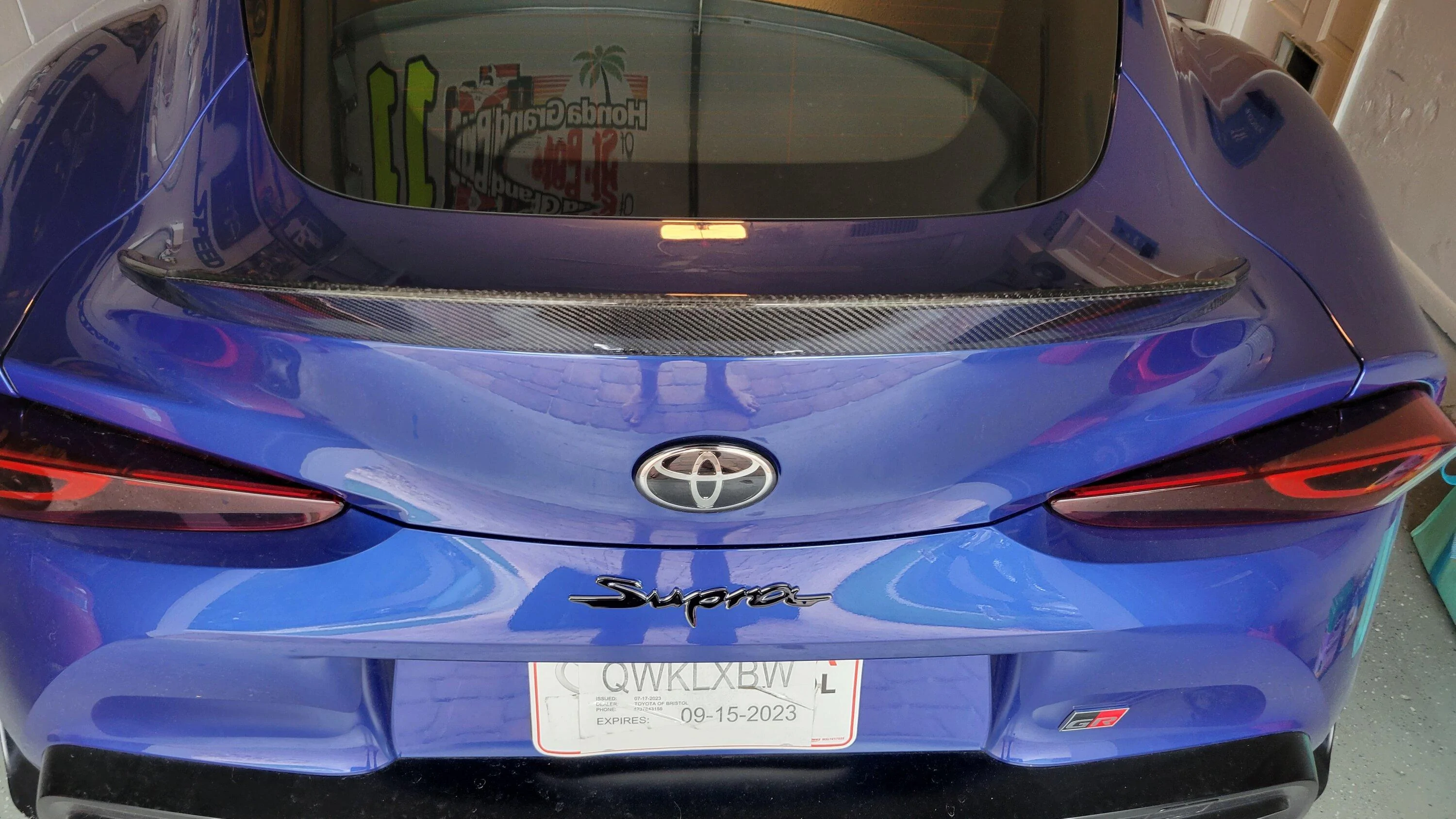

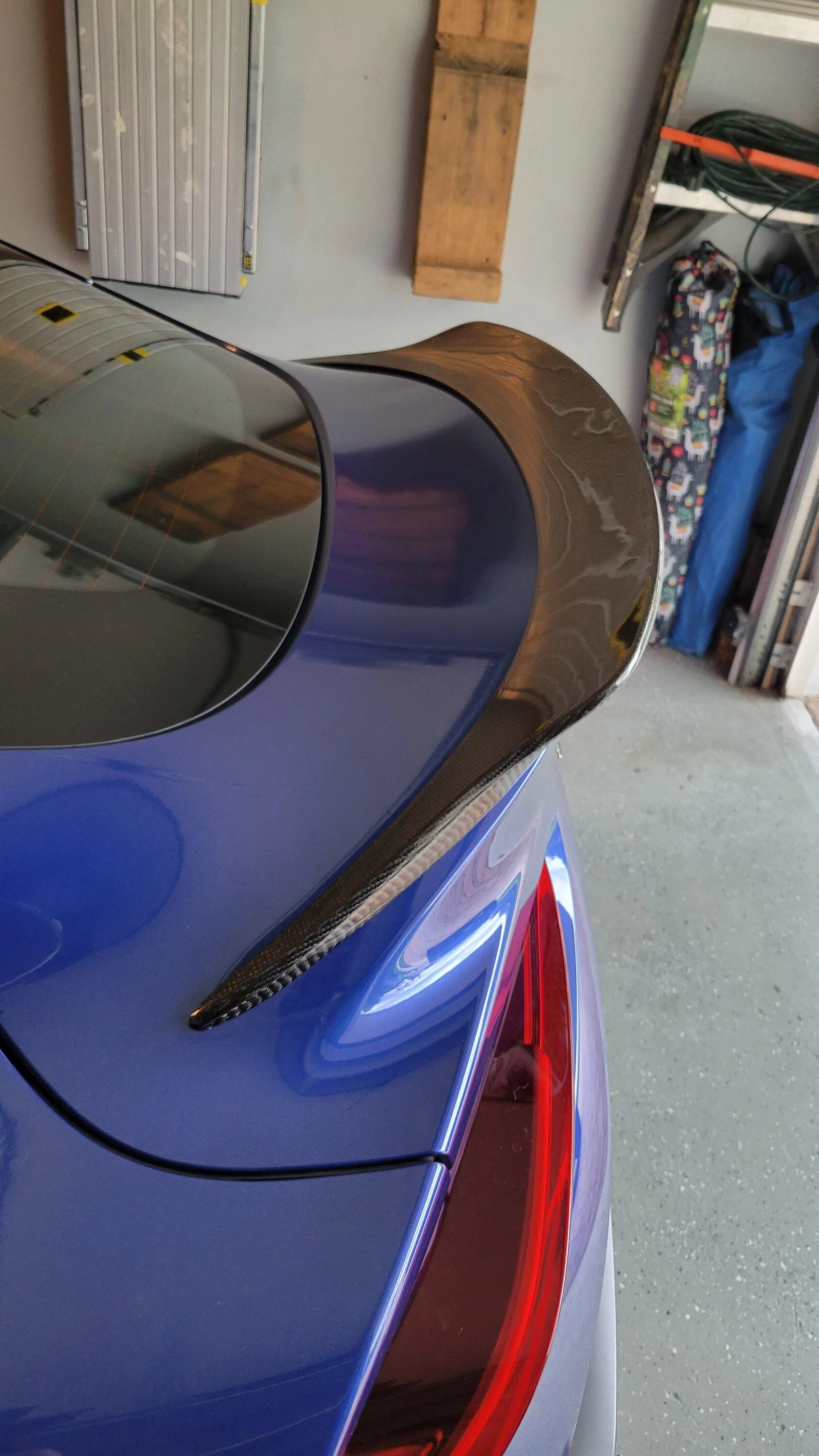

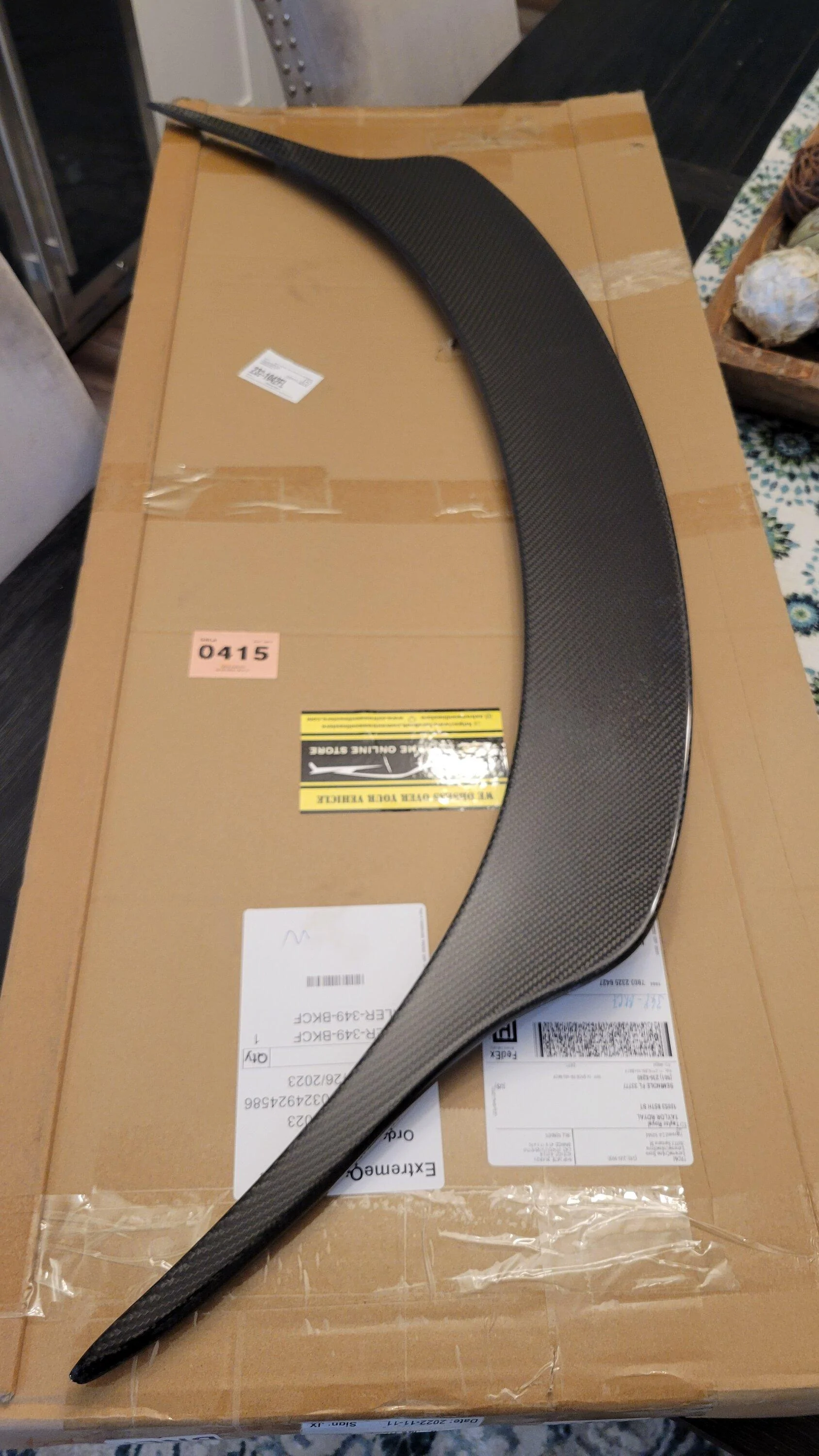

Curious if anyone else here has the EOS A91 style carbon spoiler and have successfully installed it. I purchased one and was attempting to install it with no real luck. Fitment seems kinda crap, especially on the ends. They don't match the body of the car and 3M tape doesn't even touch the body to stick. Seems like the channel on the back side is too deep and the 3M tape doesn't touch the body anywhere really.

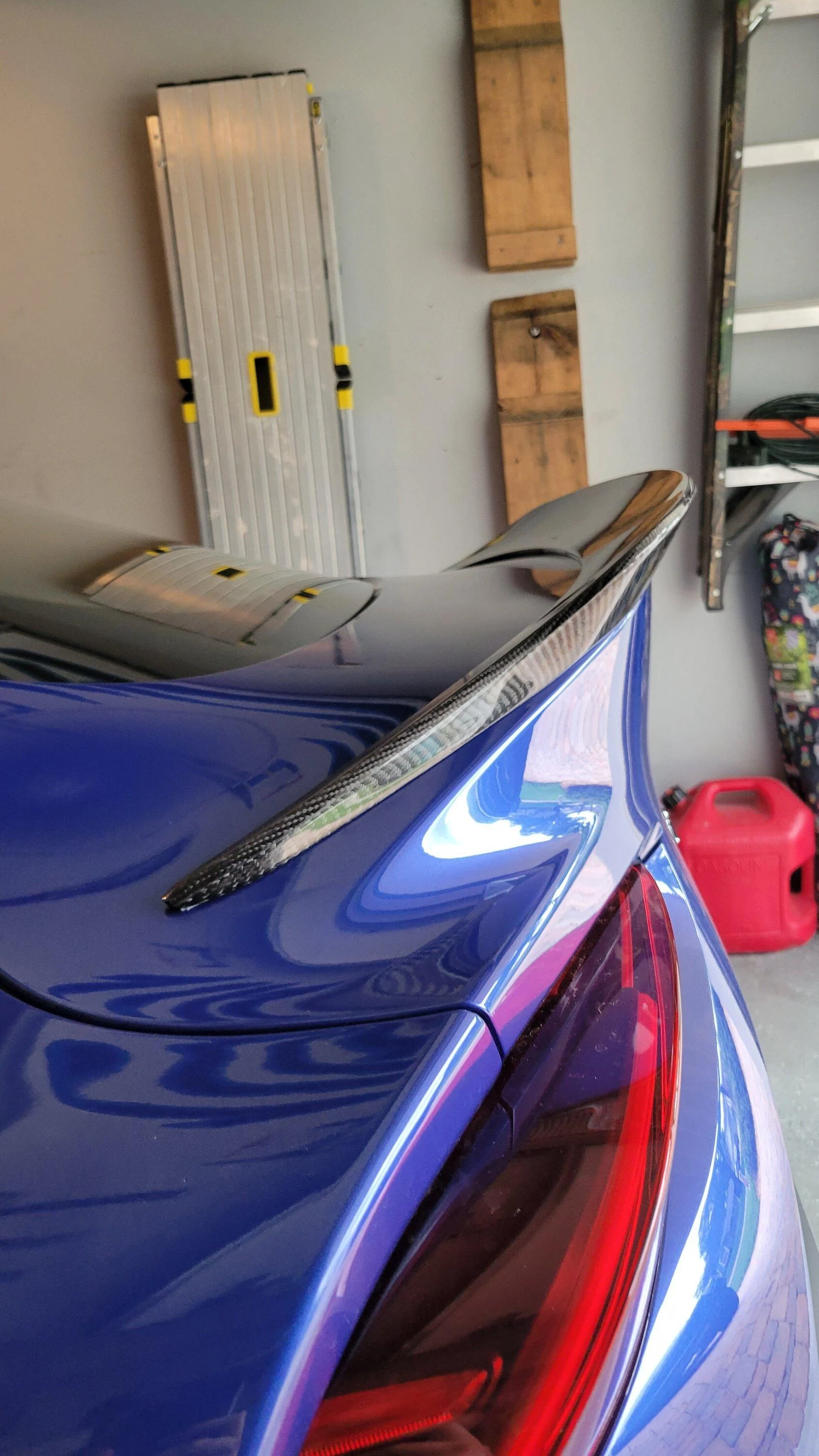

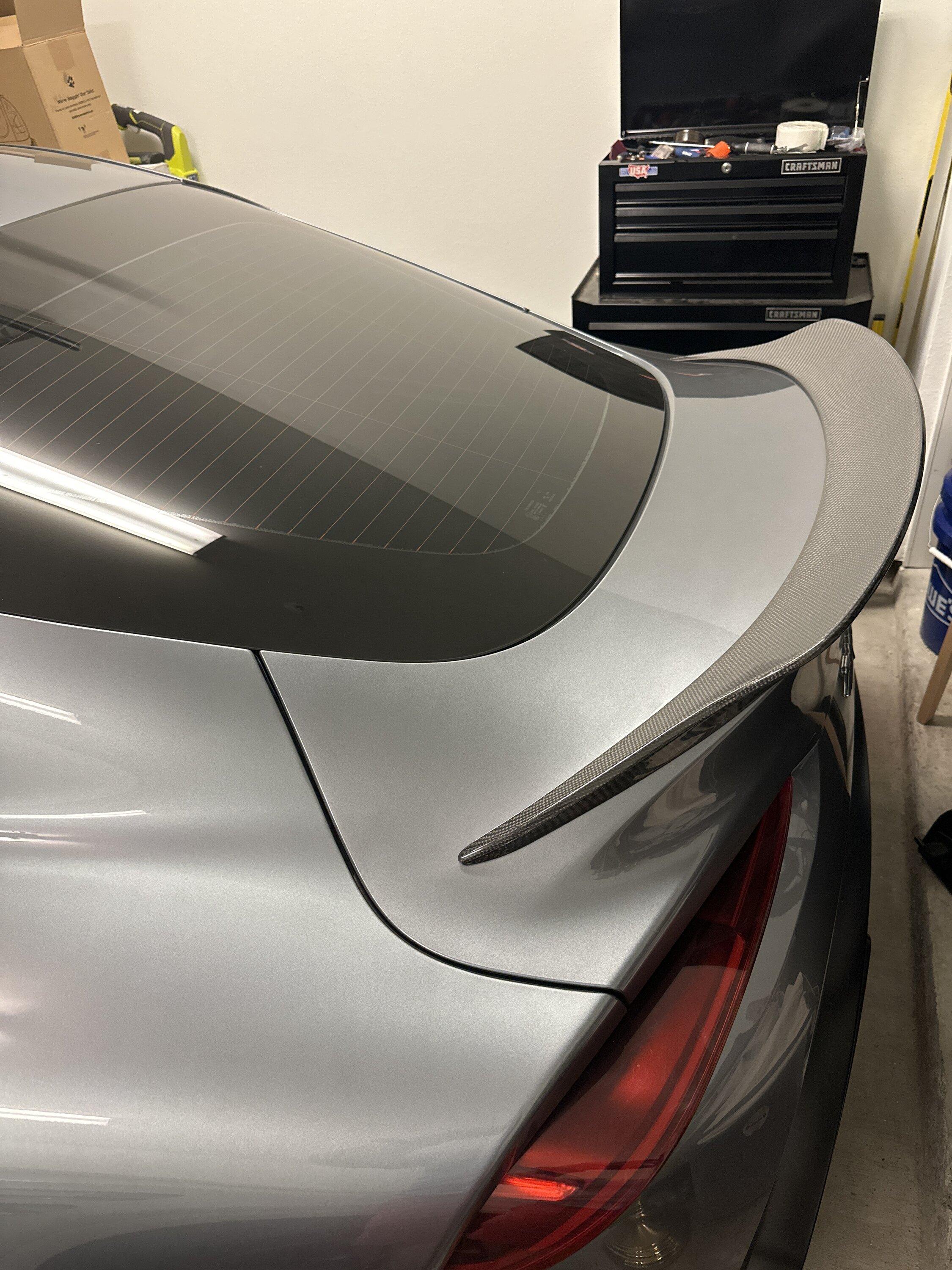

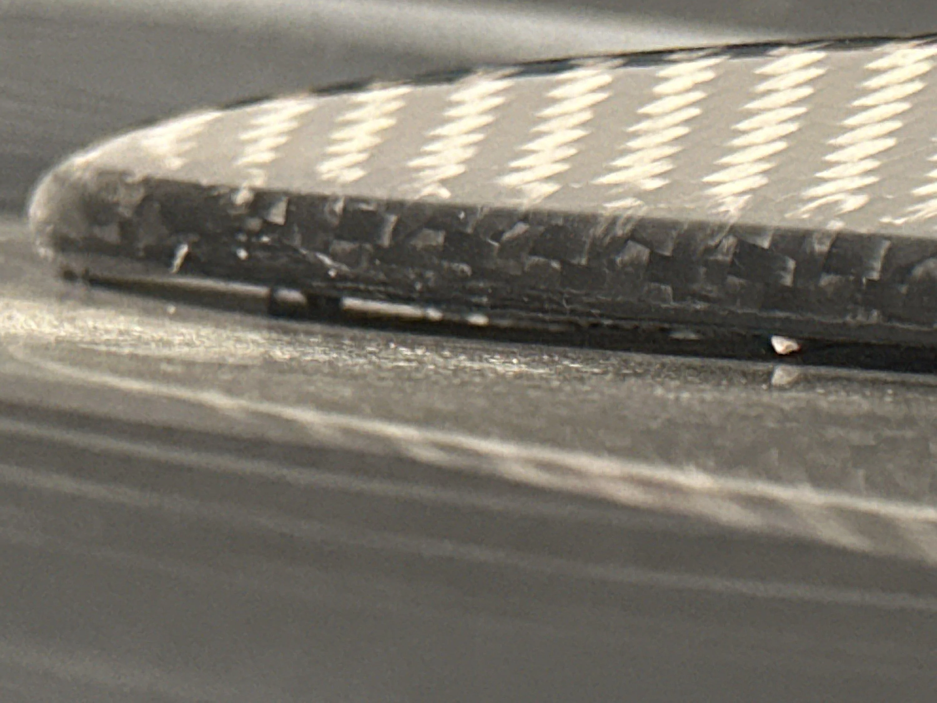

My fitment was, ok.. but definitely not perfect, especially at the edges. I left a meh review of the spoiler, but I think most aren’t as picky as me. Pictures and passenger gap below.

From what I’ve seen this just appears to be standard quality for them.

I have an original A91-CF. During the PPF installation, they removed all A91-CF pieces for install.
What we noticed that the skirts, rear spats, and front splitter were stamped with Toyota, however the duck bill spoiler was not.
We assumed that Toyota went aftermarket with the spoiler (during Covid supply issues) to assist with meeting demand.
The A91-CF spoiler fit perfectly upon receipt. However when reinstalling after PPF there was approx a 1mm gap/lift (very similar to the picture above).
We attempted a few fixes to make this perfectly flush however we’re unsuccessful.
In hindsight, we felt the culprit was the 3M tape we were using, wasn’t as thick in gauge as Toyotas.
If you’re looking for perfect fitment, consider the steps listed above, and if I can add:
° Let the dry fitment spoiler sit in the sun before full mount.
° Use a thicker gauge tape to avoid the gap/lift as pictured above.

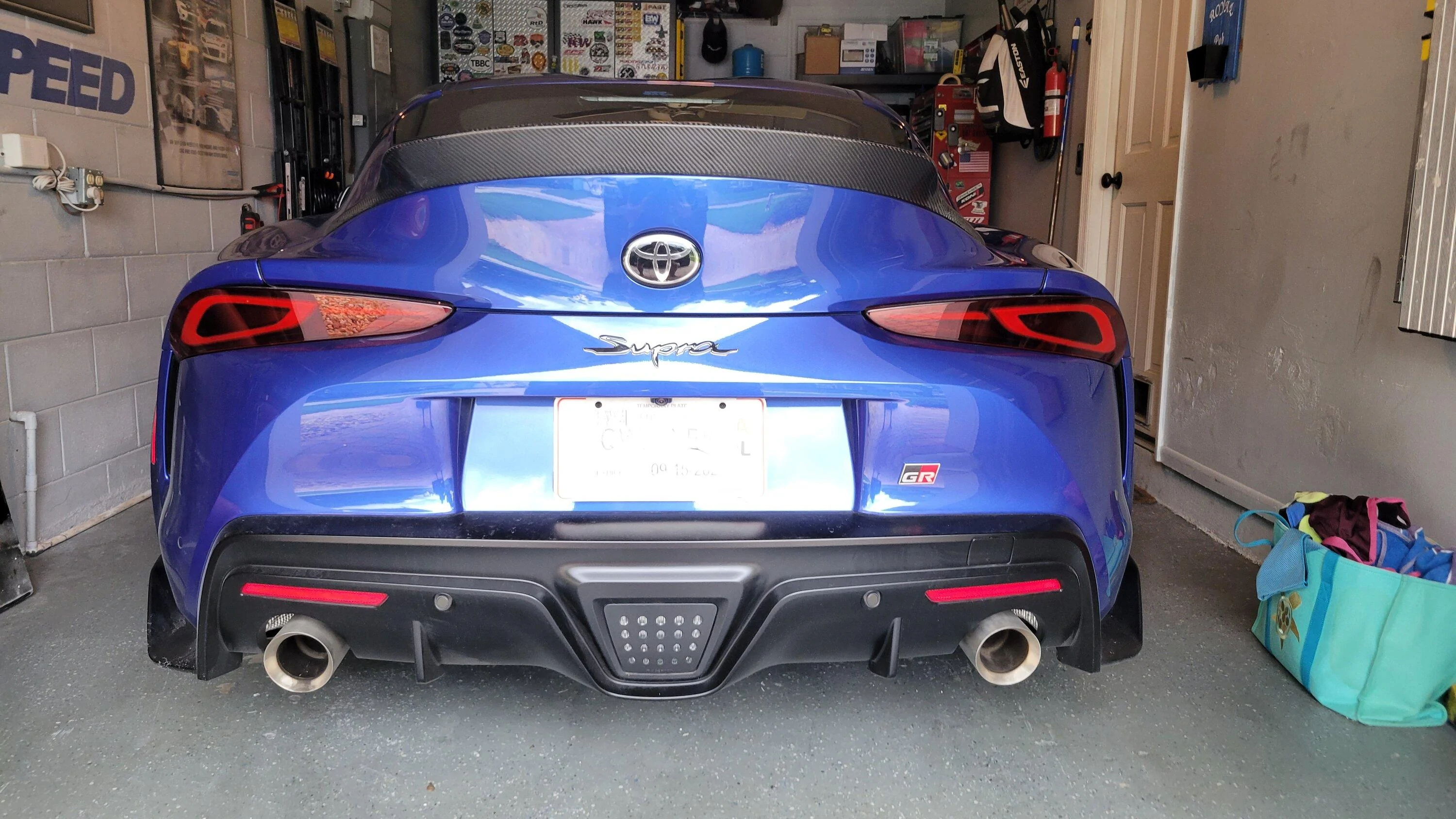

Took another shot at installing tonight using some better 3M molding tape and a better application method for the tape from @Kolme suggestion. Worked great this time. The very end of the tips could be a little better but they're laying pretty much flat to the body now after holding pressure for a bit. Love the look of it.
