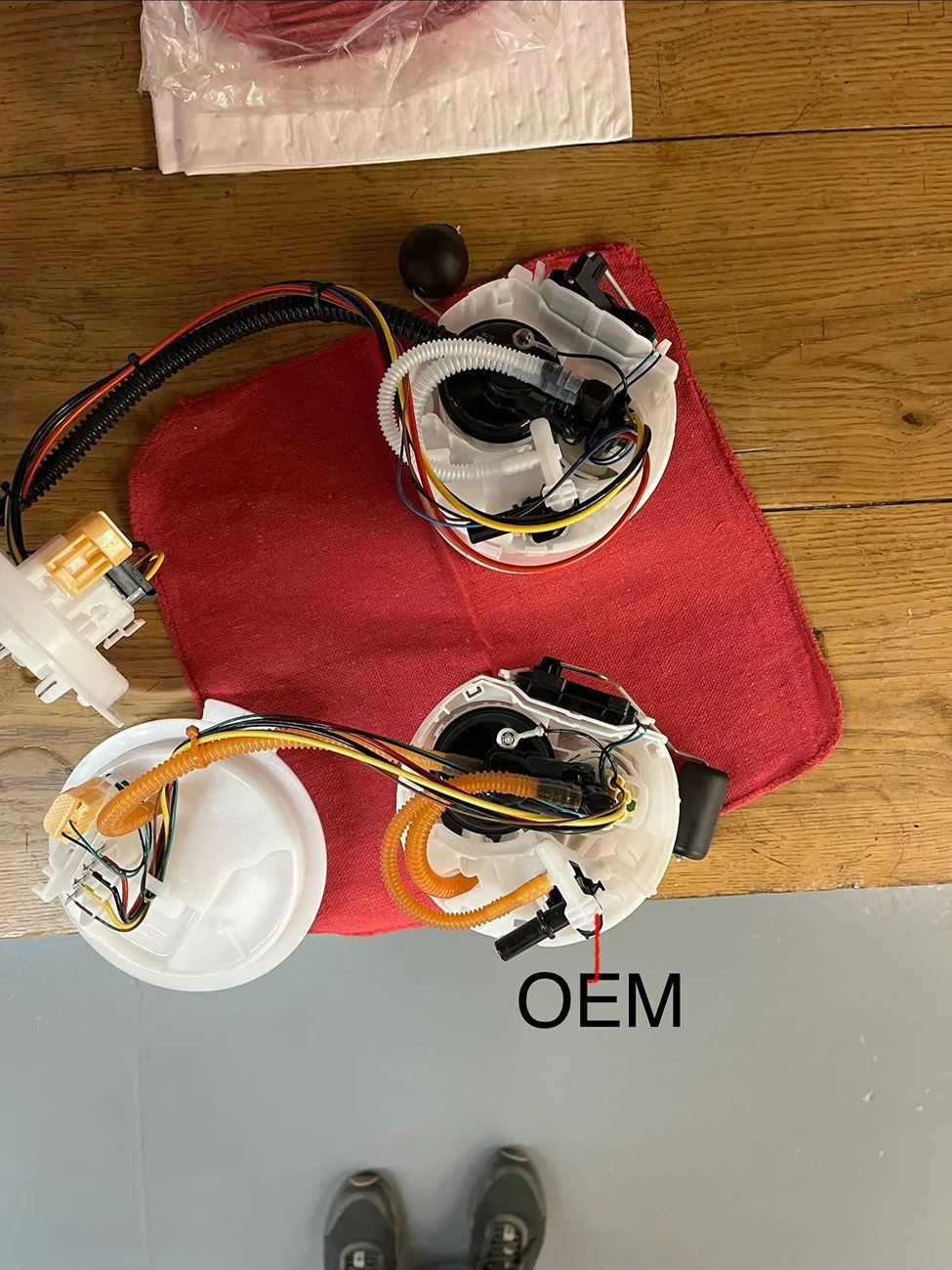

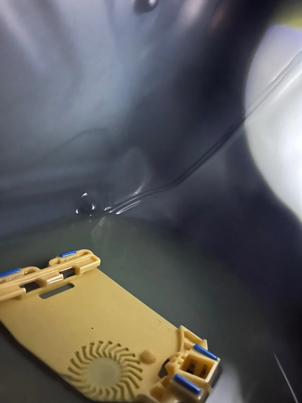

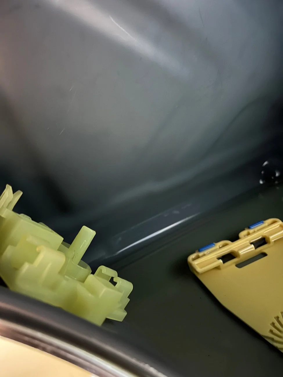

Figured I’d try the Fuel-It/BMS stage 2 lpfp as I figured I’d only need 5-10% more flow for the power what im shooting for. Install appeared to be going easy until I realized the float on the. Fuel-It pump is on the opposite side. No matter how I try to get it in there it appears to hit fuel line bracket inside the bottom of the tank and the wall if you lift it. Also cannot get it to sit and lock in correctly as the float always seems to bind on something. Has anyone installed one of these. I am able to uninstall/install the OEM pump over and over again with no problem so either I’m dumb or it doesn’t fit. I emailed them, but obviously it’s the weekend. Any ideas? Just curious if anyone else has tried this lpfp and remembers if the float was on the opposite side

****Update***** just have to swap float and harness as suspected. Not sure why they don’t note this on their site or in the packaging. Super though.
