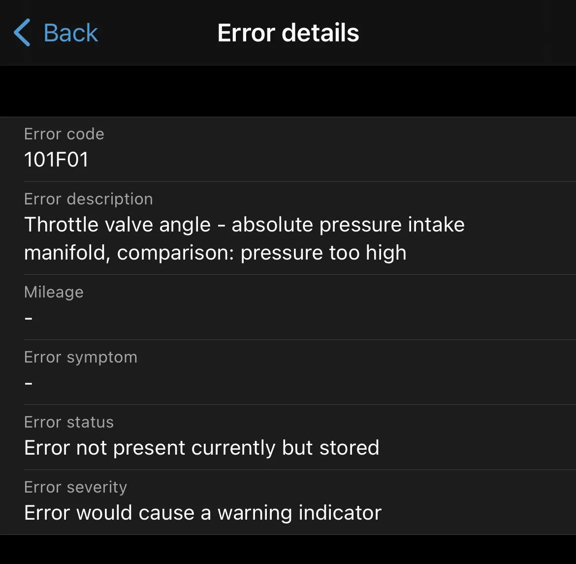

Anyone seen this error before? 101F01

2023 basic bolt ons; AA catted DP, MST V2 intake and a JB+. Scanned with BimmerLink and saw this code:
I did have a check engine light, car runs great. Would this be due to the JB+? Once I installed the DP I did increase the dial to Max (93 octane). Other mods have been on the car for 1,000+ miles, JB+ has roughly the same, however maybe 100 or so on the max setting. Cleared code and havenā€™t driven to see if it will come back, but would it be best to go to the out of the box setting on the JB+? Is it even related to the JB+? Thanks!

Ah, I see another post on here about the gas cap being a possible culprit? Weird for ā€˜pressure too highā€™. Reset code and re tightened the gas cap.
*also had an error for pulling the exhaust fuse out once I was in sport mode. Maybe that was the CEL? Was lazy and didnā€™t install the AWE piece to trick the valve motor. Installed that and fuse. Going to drive the car and see if any issues come back.

Did you ever get it figured out I have the same code
I emailed Berger and they told me this can happen with the JB+ turned up higher than the setting they set it on. I dialed it back to the standard (cant recall exactly, maybe 3psi?) and never saw the code again. Now on JB4 and didnt see the code on Map 1, 2 or the custom map6 from Jesse here.
