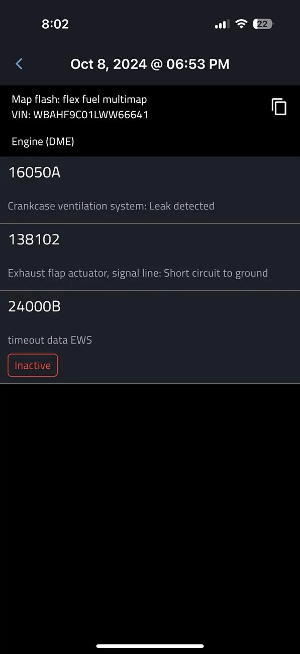

Recently installed a pure 850 which deleted the PCV heater element. As expected from prior research, I got a 16050A “crank case ventilation leakage” code. I double checked all the lines to verify they’re properly connected, and reseated the oil cap just to make sure there are no other outliers.

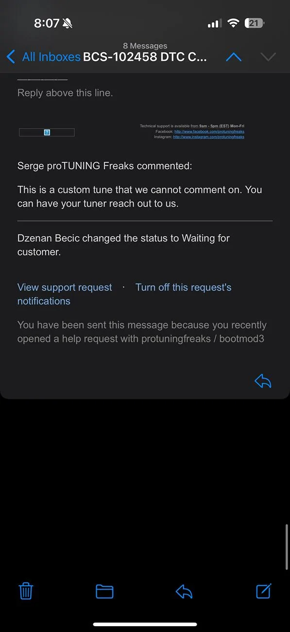

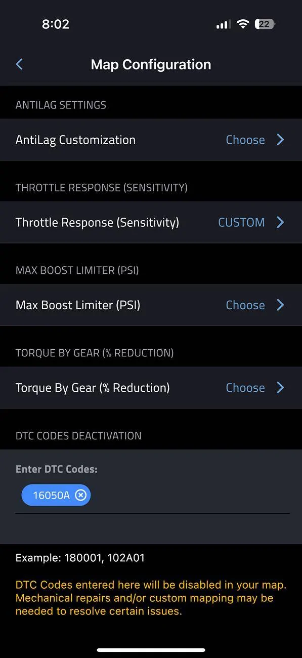

anyway, I had my tuner try to add this code to be ignored but the error is still popping up. I reached out to PTF and they said they can’t make any comments about it since it’s a custom tune. I tried reflashing the custom tune, and still having issues. Any other remedies for this?

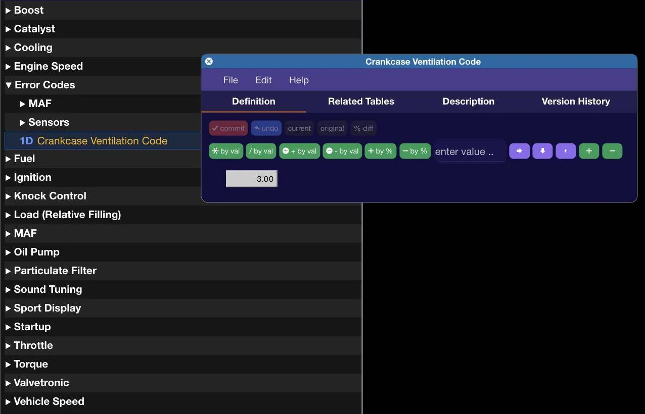

There is one 1D table in the DME to change. I did this with mine. I’m slightly concerned your tuner doesn’t know this.
I’ll add a screenshot when I get to my computer.

Thank you @razorlab! I’ll send this information to my tuner and refer back to this for anyone else having this issue in the future.
