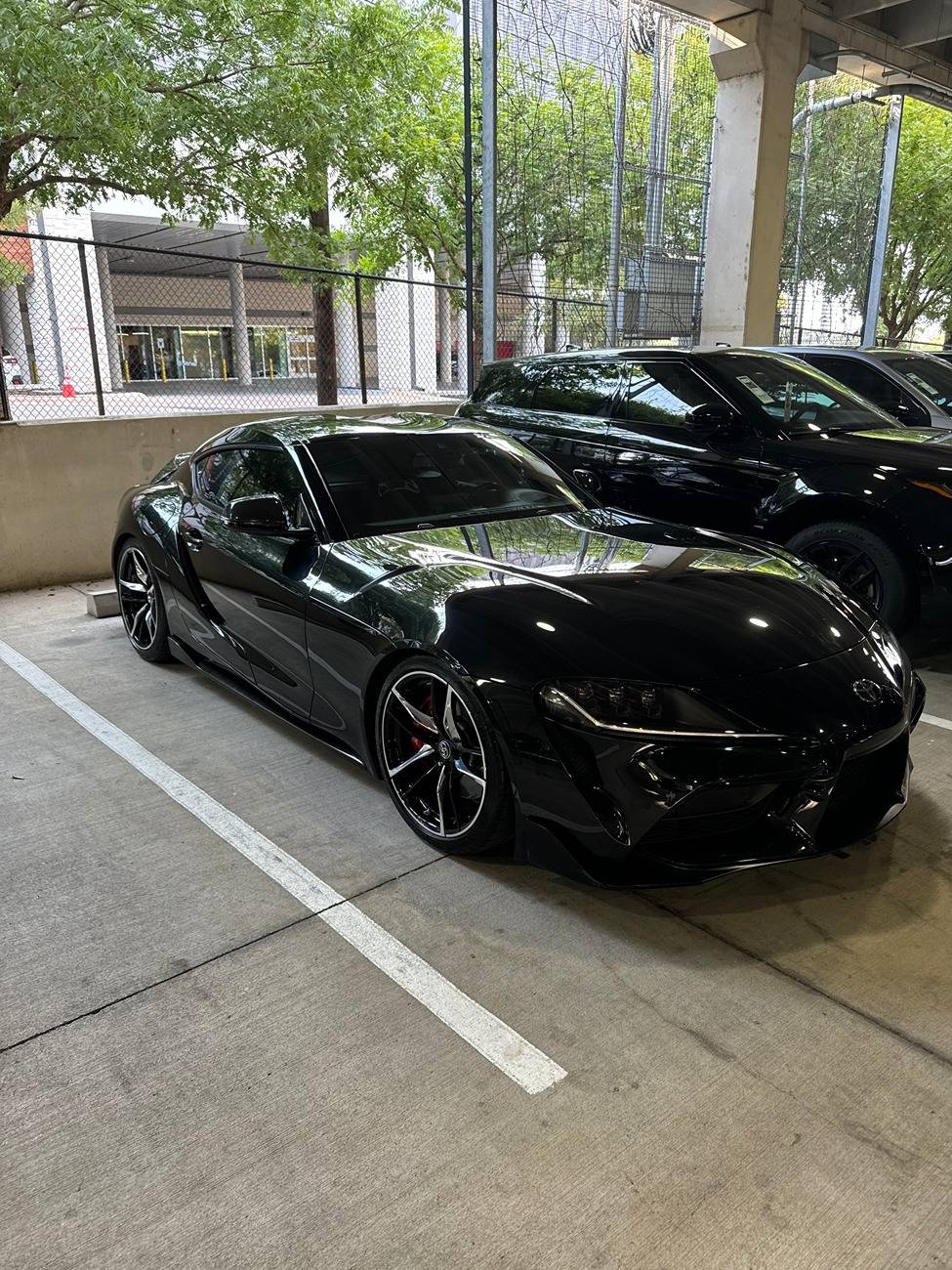

Hi everyone,
2 months ago I bought a new-to-me 2021 3.0 Supra. Right away, I knew it was modified but I had no idea the extent it was. At the dealership, I saw it was clearly lowered, aftermarket exhaust, and intake. Since I bought it, I think I've uncovered everything I can about the build and would appreciate any input in regards to things to look out for, maintenance advice, ect.

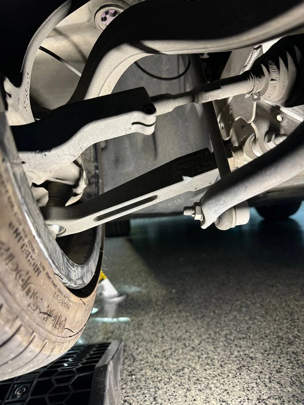

KW V3 Coilovers
SPL Front Lower Control Arms

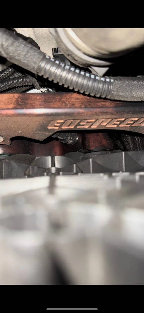

EOSpeed Port Injection Rail

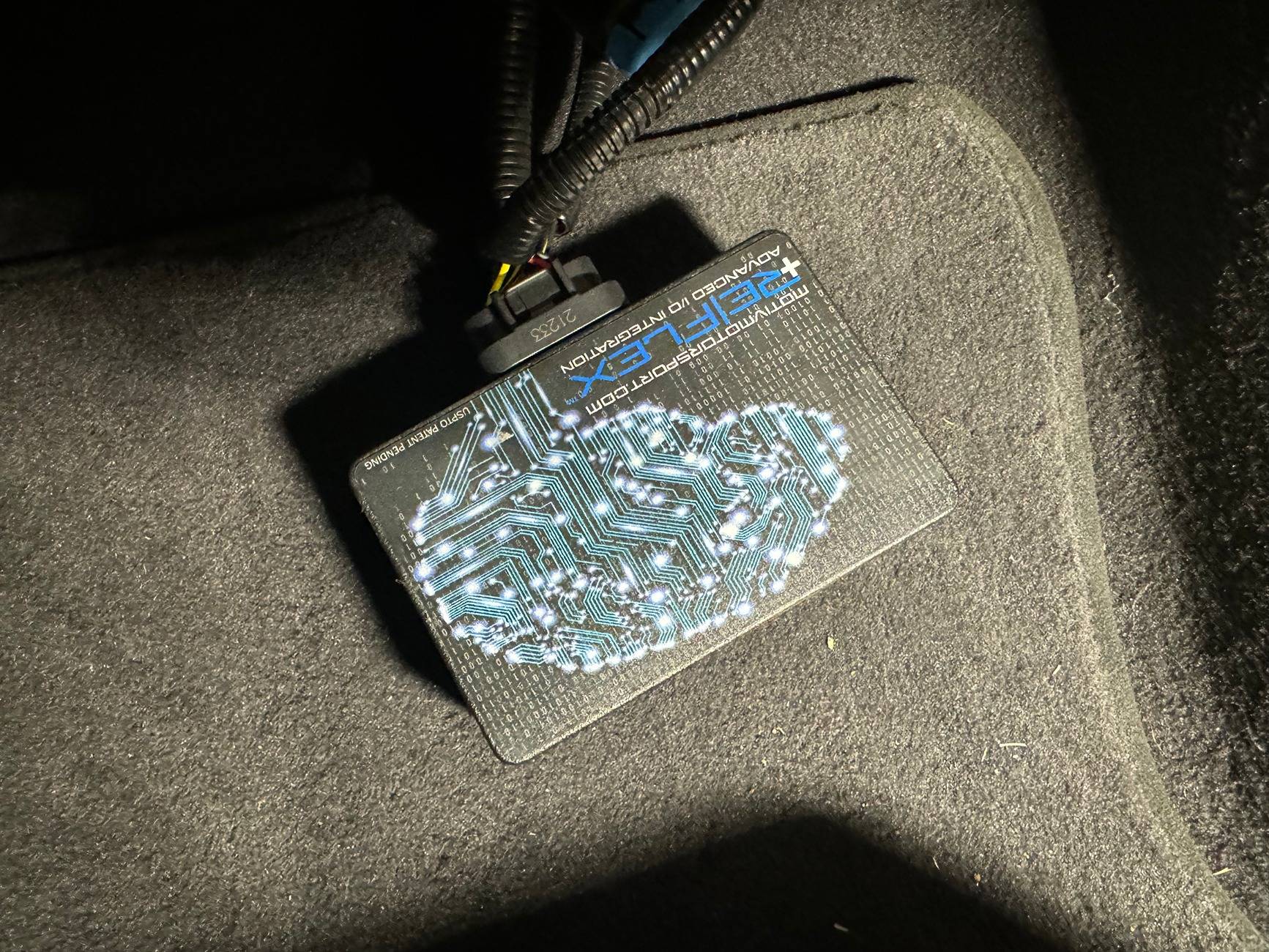

Motiv Reflex +

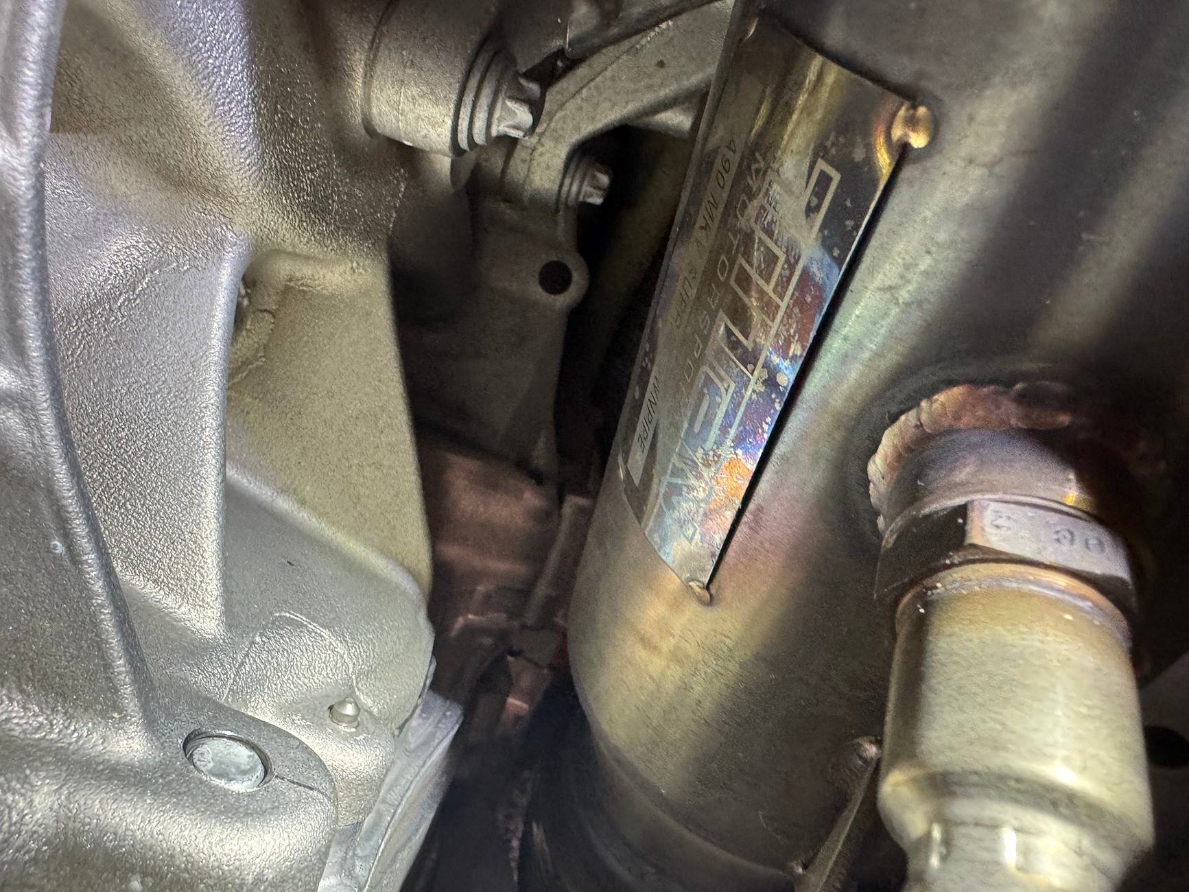

Titan Catless Downpipe

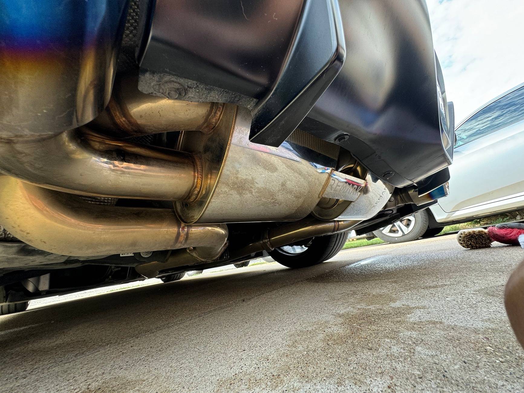

Remark Elite-Spec Catback Exhaust

Sounds like it’s time to find a good independent BMW mechanic in your area. If not doing the oil change yourself have them do it, check the coilovers, try to determine the miles of use since install, any other aftermarket suspension parts for wear, loose bolts, etc. Also have them run a proper scan tool diagnostic on it, if you haven’t done so already for a good piece of mind and an alignment.
And definitely don’t go to Toyota if you don’t have to. The car already has too many aftermarket parts. Not necessarily a bad thing. But not something that’s their forte.

The dealership didn’t know about the majority of the mods and it was sold as-is. As I’ve dug more and more into the car I’ve kept finding additional things. I don’t think it goes beyond port injection flex fuel tune.
The dealer actually had it discounted because of the mods they knew about so it was a pretty good deal.
The plan was to use it as a light fun daily - I work fully remote so it’s mainly driven to the gym and back lol. I have a civic if I need to drive some heavier miles or carry anything. I love this thing so the civic really hasn’t been touched recently tbh but I should probably start changing that.
