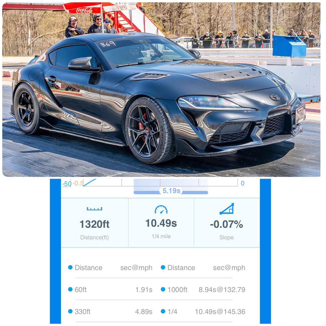

We suspect the new converter wasn’t pre-filled with fluid, and installed a new converter from Pure properly pre-filled.
That fixed the issue, just got my first passes yesterday starting to feel it out.

Awesome news,
What rpm are you launching from and what turbo set up do you have ?
