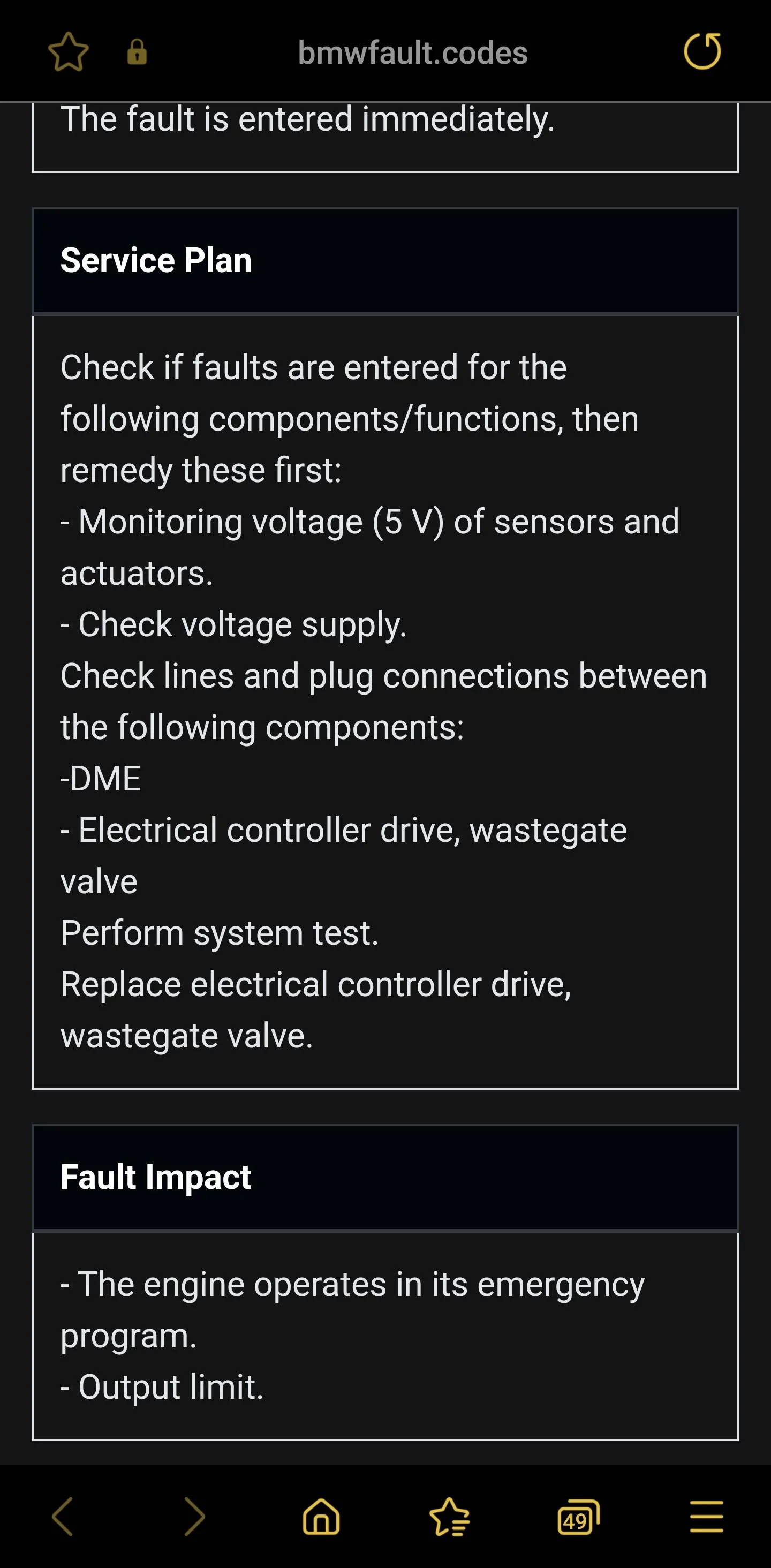

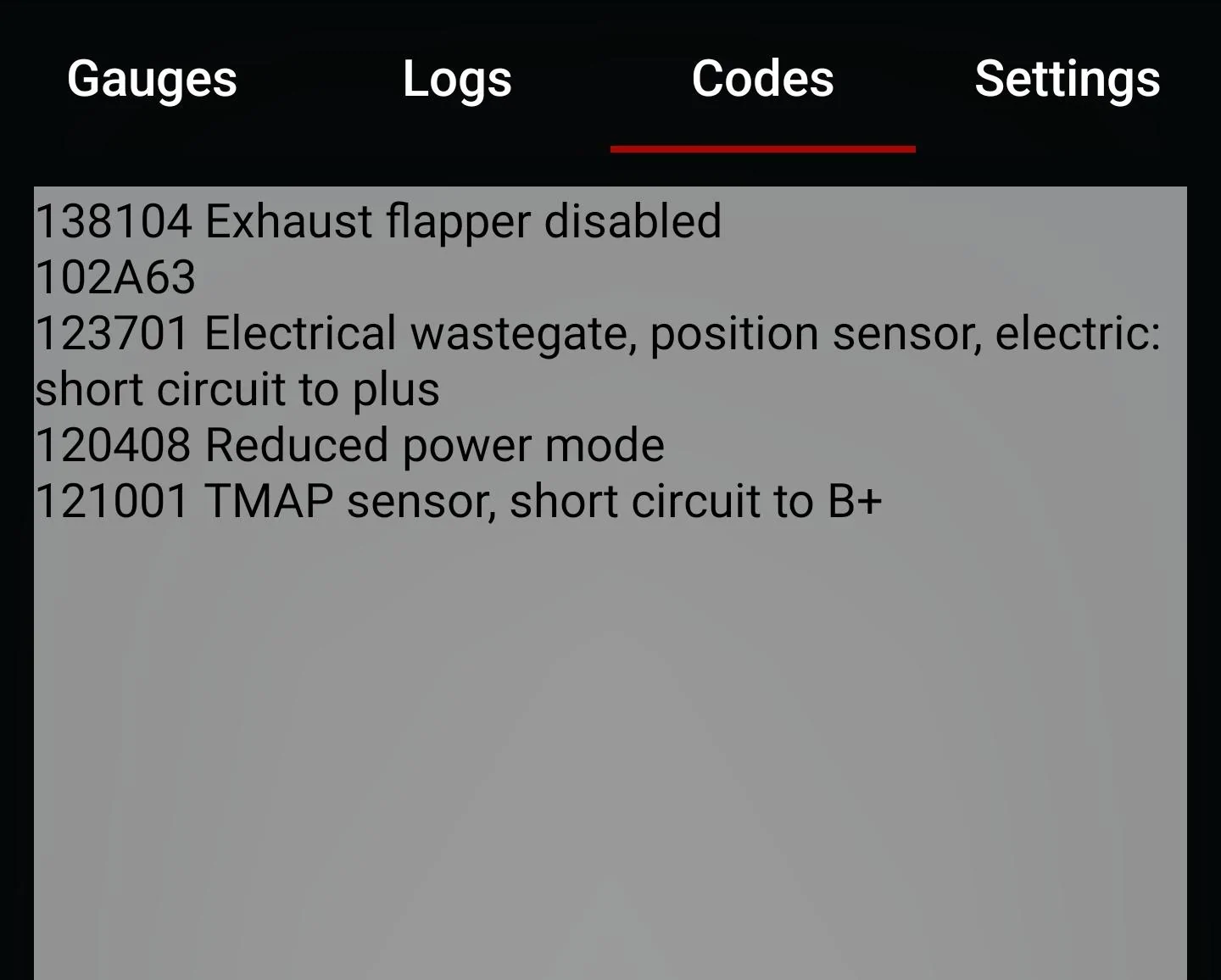

The likely problem was that the car was 'awake' when you disconnected the wastegate and the TMAP in the chargepipe.
The car registered this as a problem, and doesn't clear those on their own. You should be good to go now.

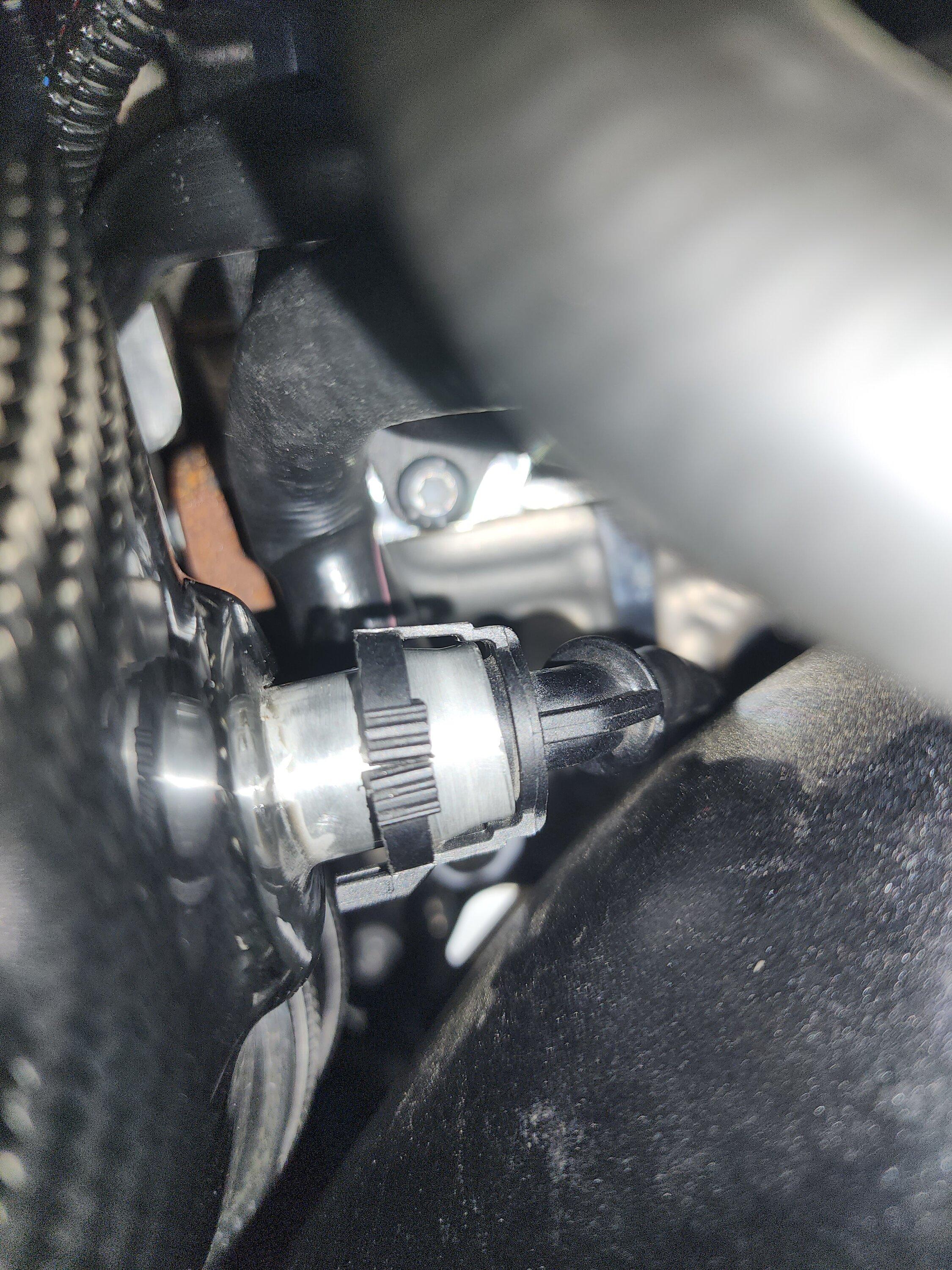

Hey just a question, @zrk I bused the PCV hose ring that connects to air intake when I was squeezing it. Should I replace it or just zip tie it? It seems like a complete pain to replace and might ask Matt at Insomnia to help me.
8,472
14,122
Zip tie it.
