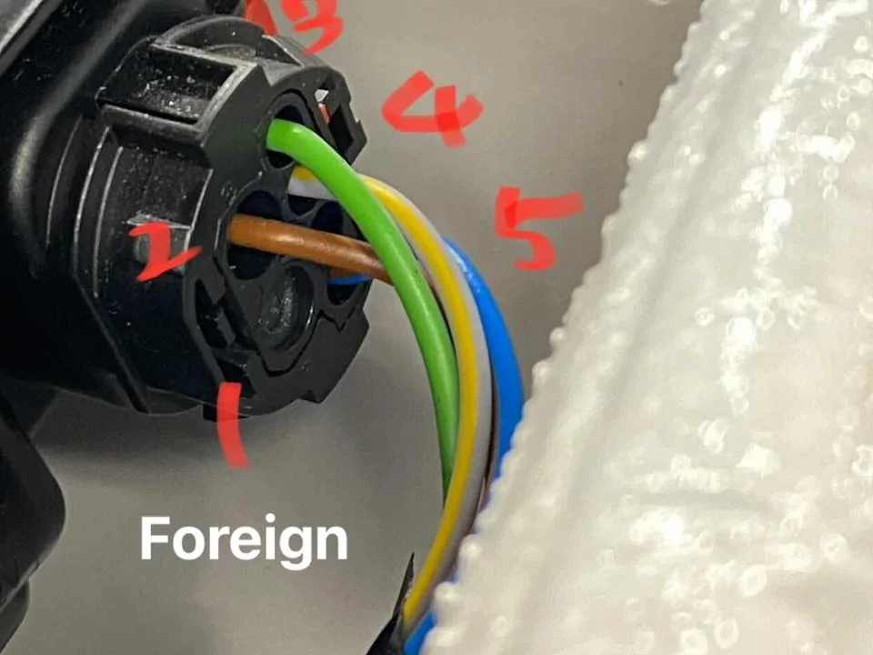

Has anyone tested the tail light wires for the EUDM/AUDM cars? Which cables represents which functionality?
I'm looking to tap the brake light. It is not for the 4th brake light at the bottom of the bumper.
I took a photo by removing the cover above the taillight but found this clearer photo in the forums.
Thank you

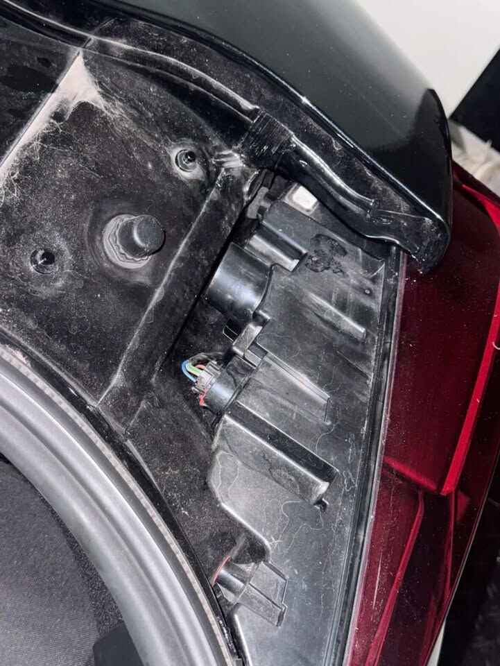

Actually, I was able to test in the extremely small space by removing the cover on the trunk bump-stop above the taillight. It is pin #3
