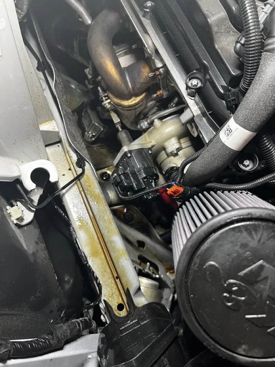

I have a 2020 Supra with CTS turbo, PI and pretty much all fuel system done. My car ran good for about 2 weeks and last knight in MX after a little pull I noticed a lot of oil on top of my turbo. After cleaning and inspecting everything I realized that the oil came from the line that goes from the valve cover to the turbo inlet. I clean everything and went for a drive and did a half pull and the same thing. This time only did 12 PSI. Anyone had this happen and how you fix it? I already ordered a mishimoto catch can. But to be honest with all that oil, I am afraid that the catch can will filled up right away. I lost over a quart of oil in those 2 pulls.
