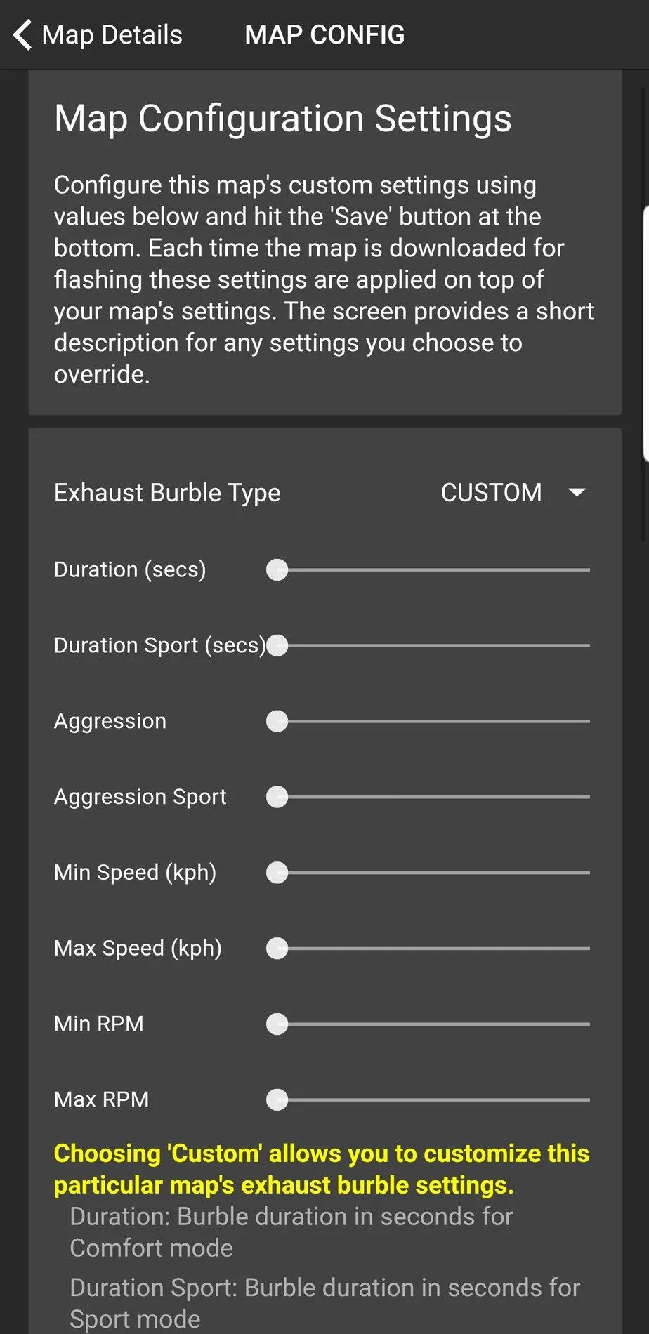

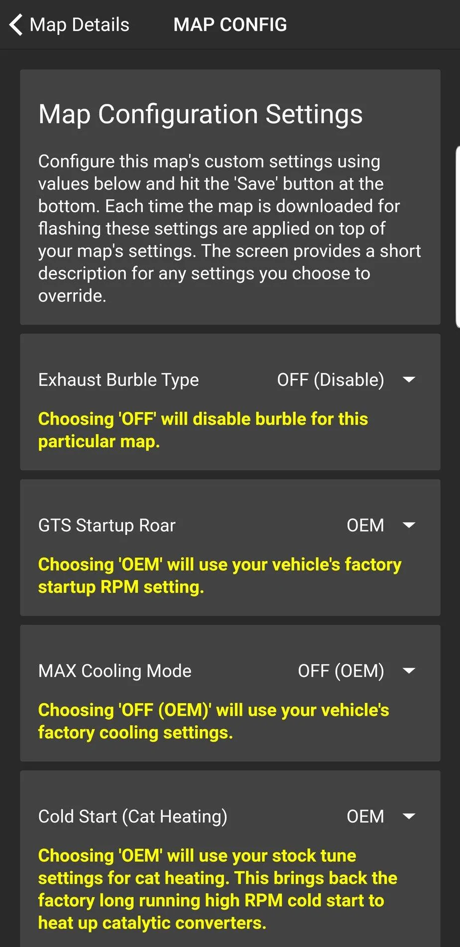

Not sure how its done with MHD but for everyone else using BM3, burble sound can be changed by selecting the config button on the top right
