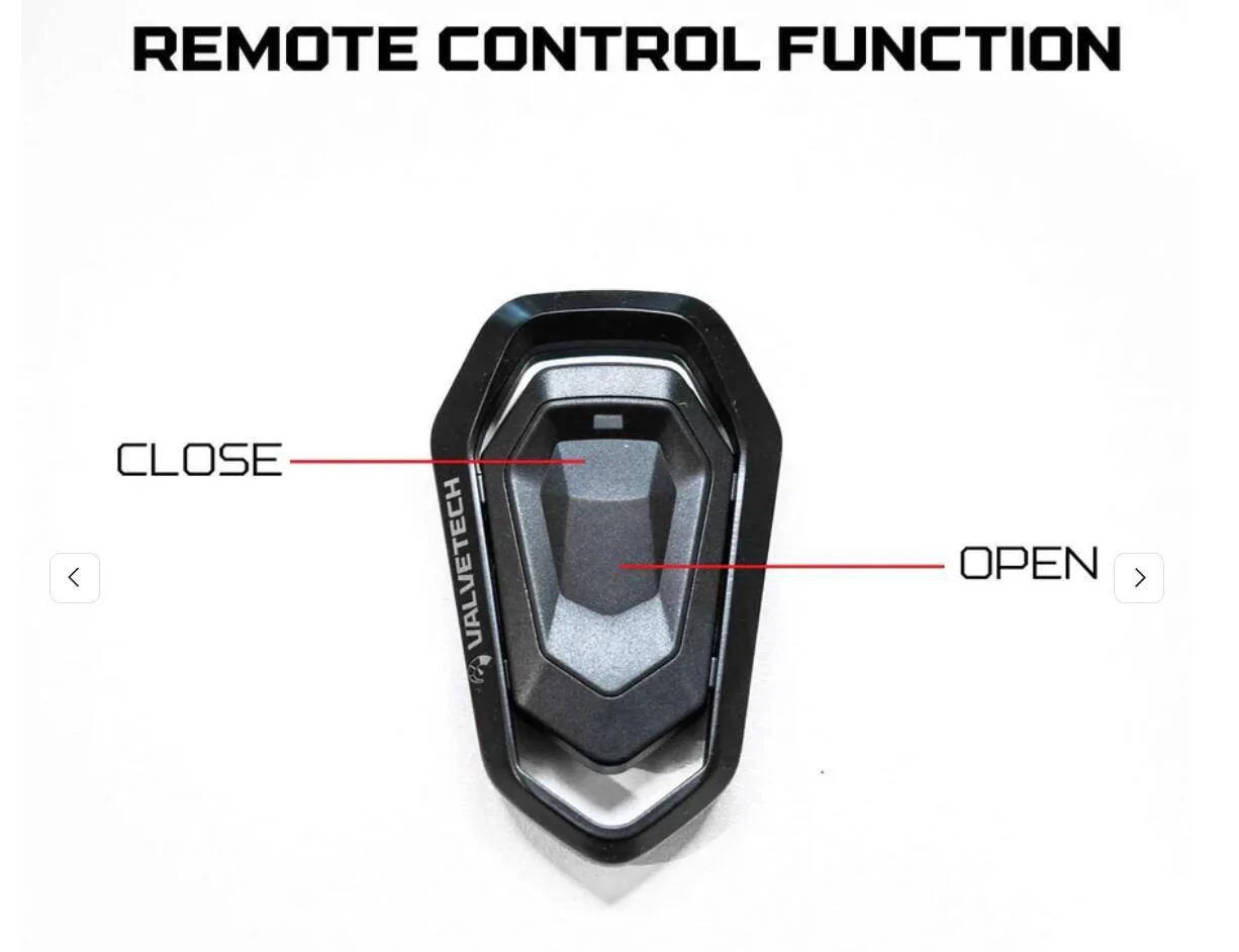

Not sure what your stock exhaust has to do with anything if you bought a new exhaust system.
The valves opening and closing doesn't rely on the car being warm, you control valves with the given controller (should have 2). If you're having issues after using the controller, then I would assume it's an electrical issue. Just a heads up, the valve can get stuck if you frequently do burbles with valves closed over time.
This is a different remote but same thing applies for Fi/Valvetronic controllers:

You can buy a Fi Exhaust without the remote and just let it be operated by the factory sport button. If OP doesn’t have a remote it might have been a similar issue to mine.
If the solenoid isn’t turning the valve at all, try swapping the left and right controllers and see if the problem goes with the controller. Mine did and once I replaced it with a new controller it worked fine.

Interesting, I know it's an option to wire valves to the sport mode button, but I assumed the controllers came regardless.
