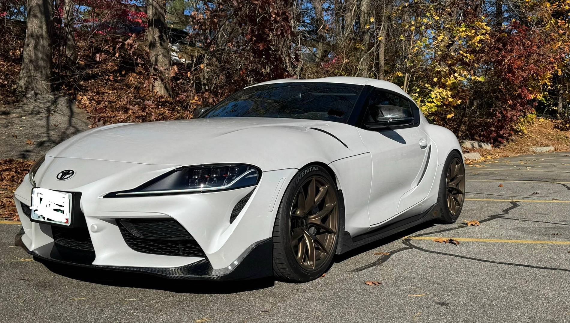

Go to the apex wheels site and read up, they have an amazing writeup on the different sizes and fitments. I went with their 9.5 front and 11 rears. You can run a small spacer if you want, but it isn't needed and you may rub the fenders a bit.

Would you rub if you were on stock suspension? Thanks
