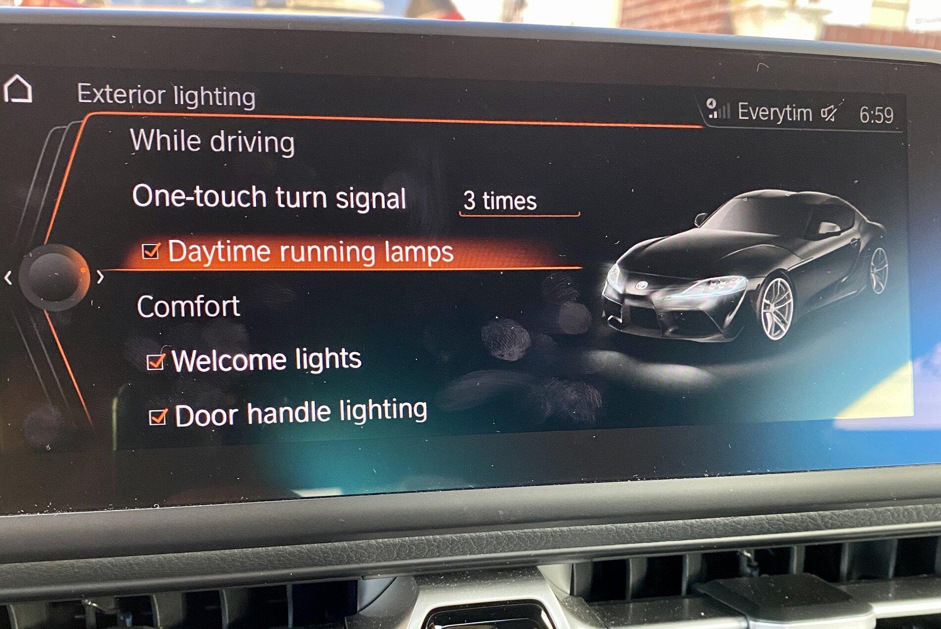

I had to use Bimmer Code to turn on the ability to turn on or off the daytime lights. Now it is working like I want it to.

I’ll try to look it up tonight. I know I had it turned off at some point but then ended up preferring the look with them on. Hopefully I didn’t dream this up
I have them off now. Used Bimmercode. With how much I drive it and the expensive replacement and knowing how my FJ Cruiser that did have the constant on went through lights, I can't see it. Also, the safety it provides is a low %.

I know you turned them off already through coding but maybe for the benefit of the search. This is what I was talking about, I had this unchecked so everything stayed off til evening obviously:
