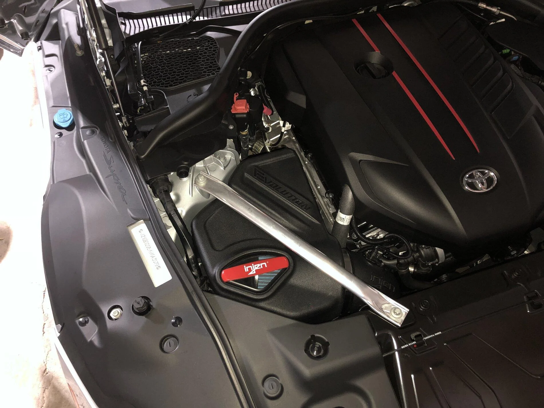

Anybody have clearance issues with the 2021 strut bar? Installed my Injen Evo2300 Evolution intake and the strut bar hits the airbox near the hump in the box where the filter fits in. I can bolt the strut bar down but it pushes down the airbox about 1/8" due to the strut bar interference. Anybody else have this issue?
TIA

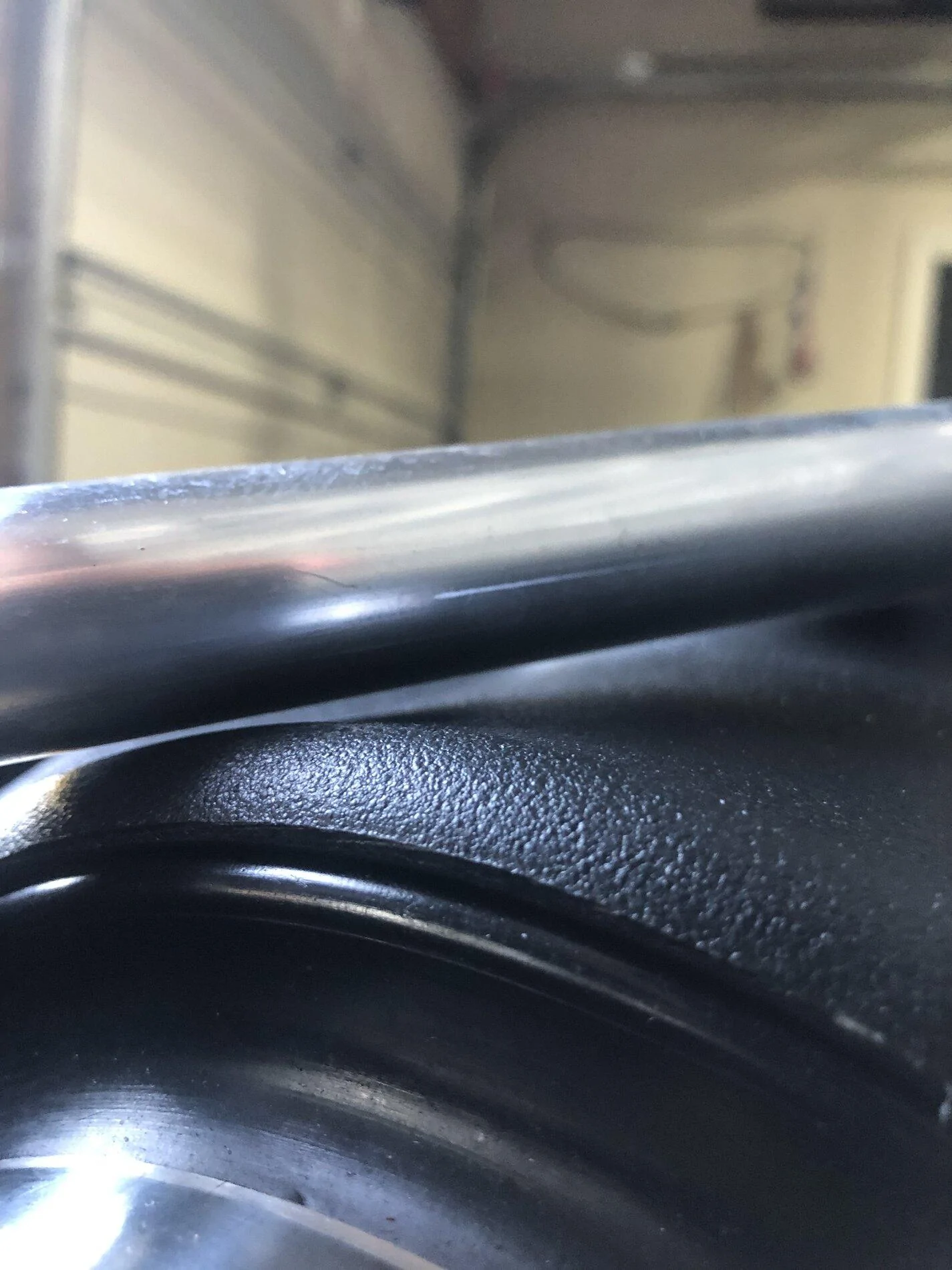

I have a ton of room where the bar bolts to strut tower, but on the end of the bar near the bumper where the bar goes over the filter itself is where I'm hitting. I've pushed down in that area with all my weight and the box just flexes. There is a grommet by the inlet to the airbox. I'm seated there fully. There just isn't enough space there from the grommet to the strut bar. Can you put your finger at the centerline of the filter where it goes under the strut bar and snap a picture?

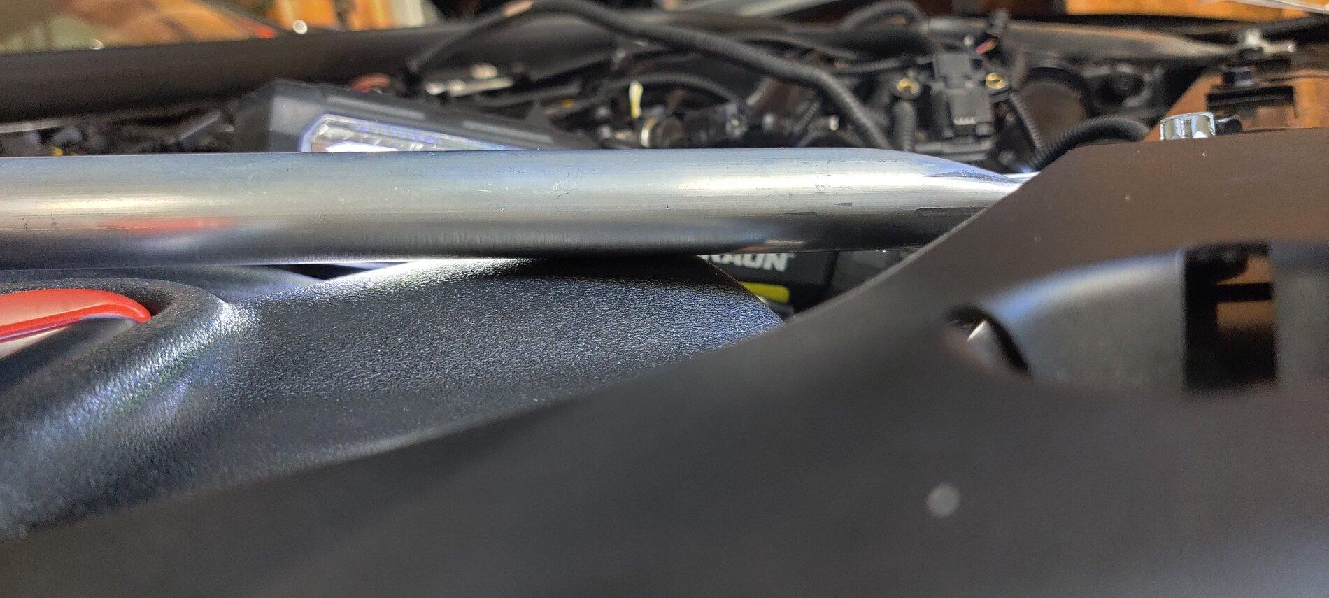

?? So it’s much closer than I remembered it being, but there is a small air gap.
