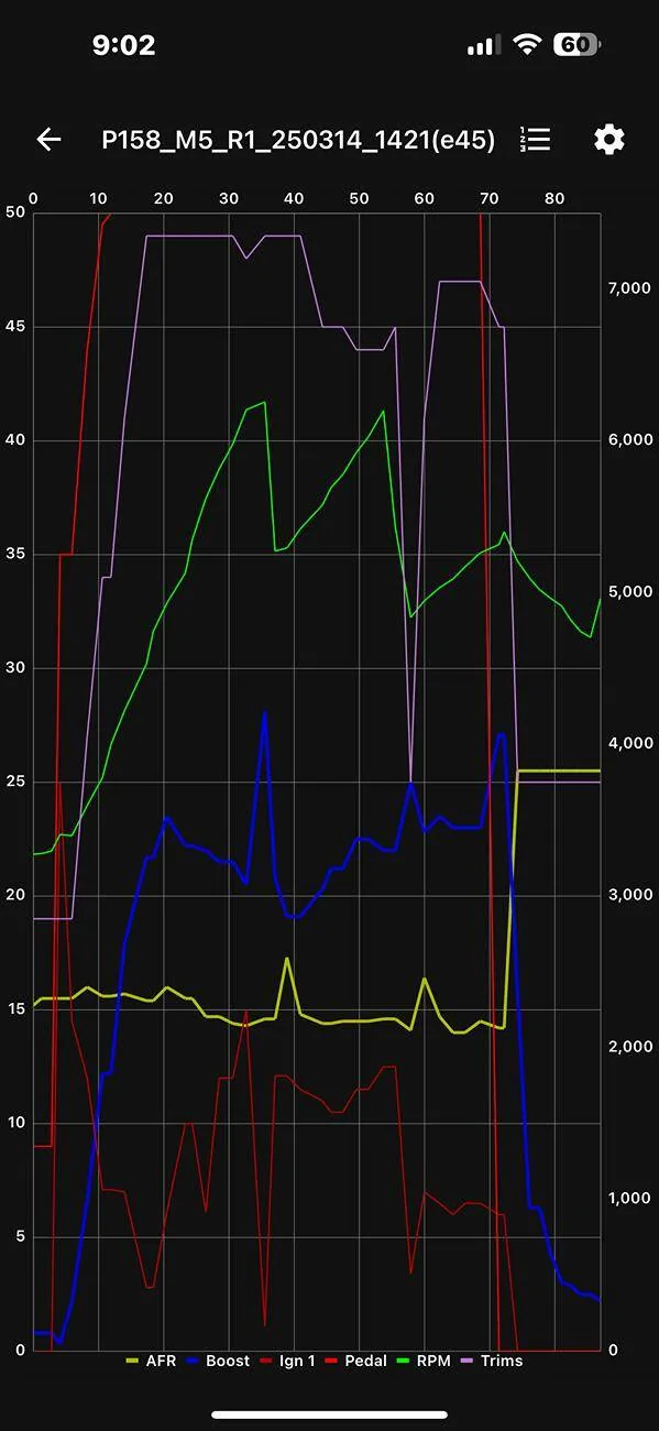

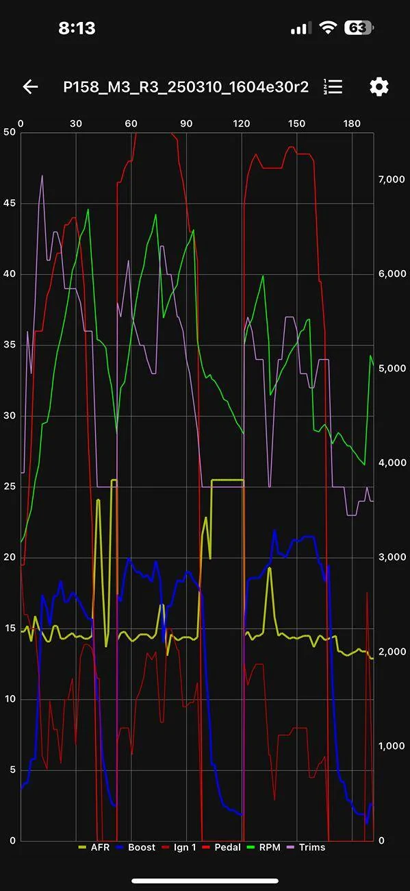

Recently got a JB4 installed. Most noticable and best map was 3. 93+e30. Would getting a custom map be worth it? If so does the boost levels stay about the same as map 3?

Map 3 is known to blow the stock turbo. Be careful

That’s the only map that has e30. The map with 26psi absolute and (e30+) was producing beyond 26 so I turned it back to map 3.
Right, but it still blows stock turbos. Get a custom tune before you start running e on map3
also map4 is e30 with absolute target of 20 instead of map 3’s additive 6lbs
