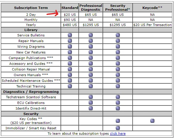

"The Technical Information System or TIS is your service support source for all Toyota produced vehicles marketed in North America."
I'm from germany. Thank you anyway.
Maybe someone can just tell me the correct wiring without a TIS.
Would appreciate another help.
Aug 8, 2018
2,992
3,269
oh I didn't see that.
I don't have active subscription.
There seems to be an EU version, but you'll have to try that.
https://www.toyota-tech-uat.eu/euro5search/euro5search.aspx?PUBTYPE=EWD
Yeah, so, I don't know if there'd be wiring differences between US & EU, nor between the model years. There could be if you followed naked man's instructions to the T and ended up with issues. Yet, Bob doesn't say if he has errors on his dash or not. so.. :)
Everything else working properly? not that you can check if your airbag is wired properly.
So you could spend the $20 from US and try..
