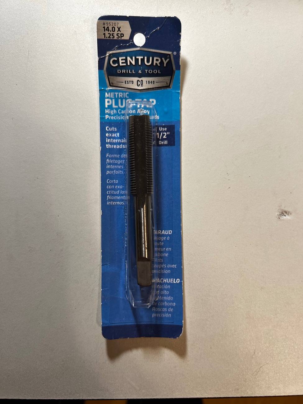

Vcme09
David
Oct 8, 2024
New Jersey
2021 Supra
Had my tires changed on a 2021 Supra GR and the tire shop cross threaded a lug stud. Bought a tap but have not used it. Wondering if this is the correct one. Has anyone ever had this issue before and what was the resolution?
BimmerGuy
Michael
Nov 30, 2024
146
175
Cary, NC, USA
MKV Supra m/t
I was going to compare this size to the one that I used on my M4 when I did the same thing, but they may not have the same thread, so I'm not going to say yea or nea.
What I will suggest is that you use the tap on a non-buggered bolt hole and see if it works. If it screws in with no resitance other than normal, then it's the right size. If it doesn't, it's not.
You should (if you haven't already) also buy a new lug bolt.
Vcme09
David
Oct 8, 2024
New Jersey
2021 Supra
Good idea! I will try it soon and let you know. Thanks
