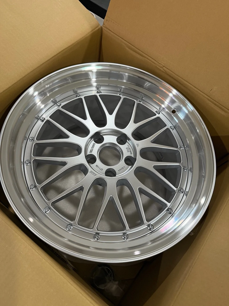

Just received my wheels today (pic below) and I’m looking for a stud conversion kit. I want to get closed end lug nuts, similar to these BBS ones
My question is, will 75mm studs be able to fit these? Most of the conversion kits are available in 75mm or 90mm. Also, if anyone has recs for M14x1.25 to M12x1.5 conversion kit.

no, they will be too long and require an open lug
8,846
17,343
is there a particular length that I can go with that will allow me to use closed end lugs?
You will need to measure the exposed length from the wheel and the depth of the lugs.

And then measure the internal depth and thread length of the lug nut.
And then make another thread asking if anyone can recommend a lug nut long enough for it.
