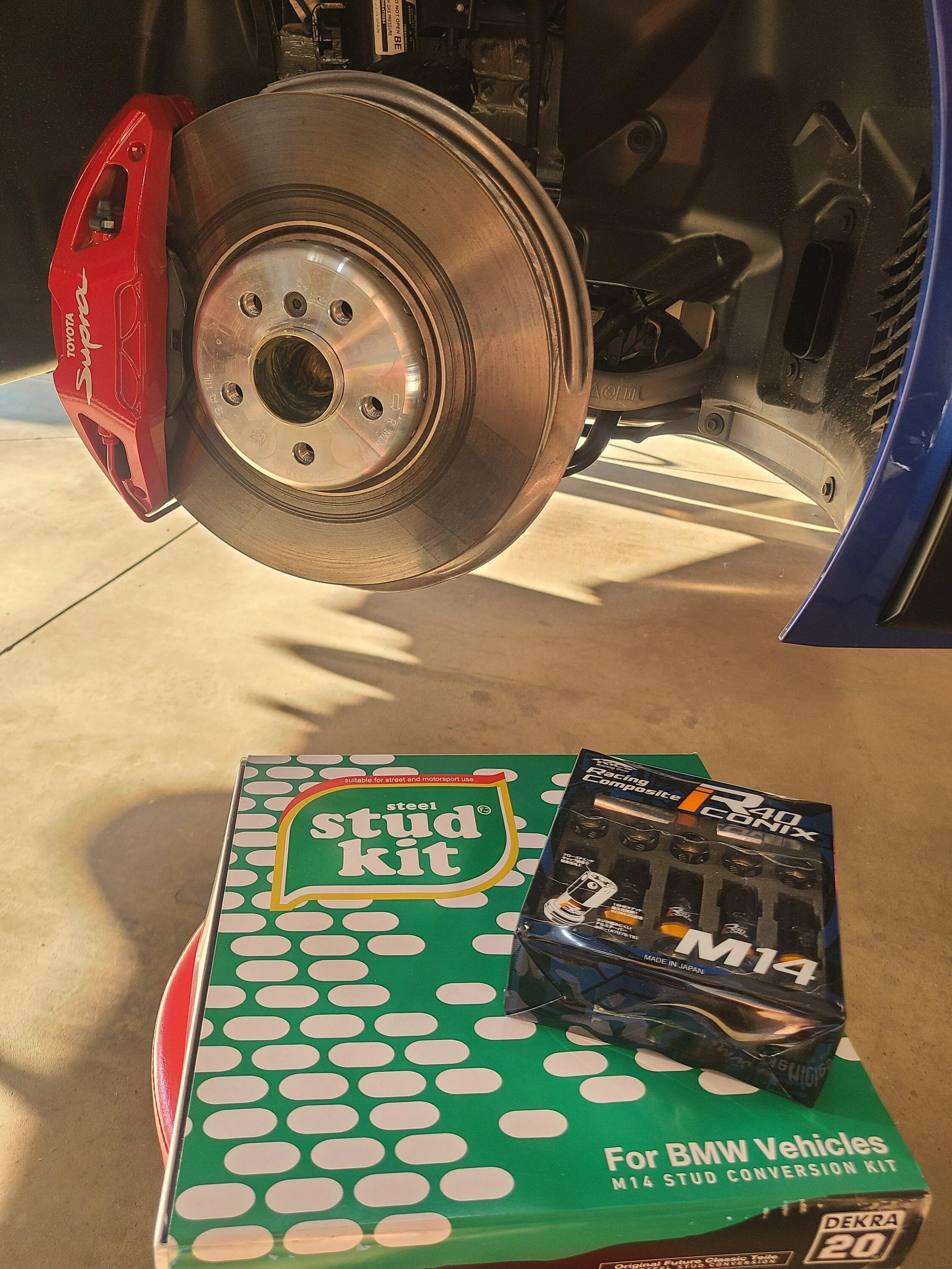

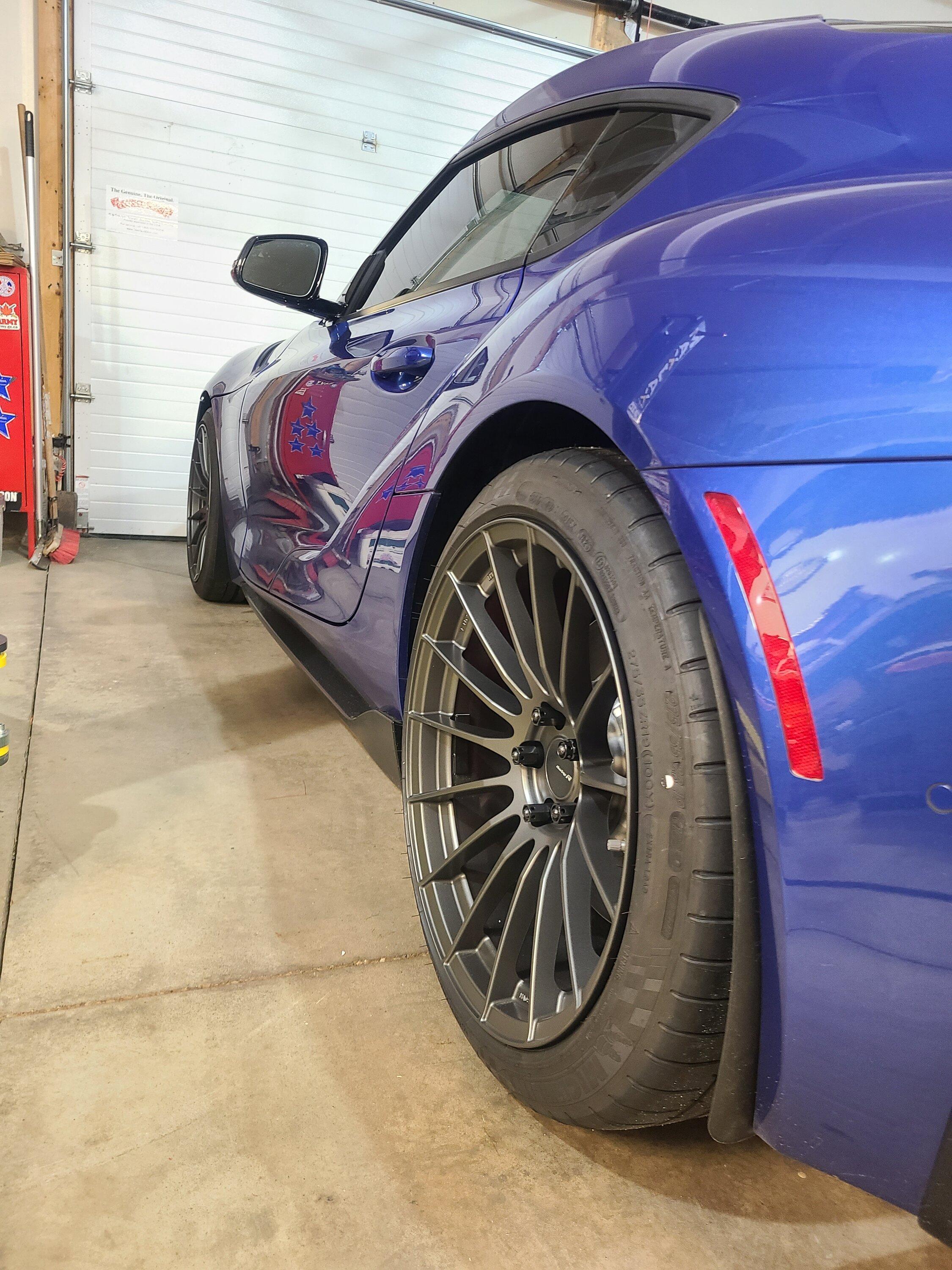

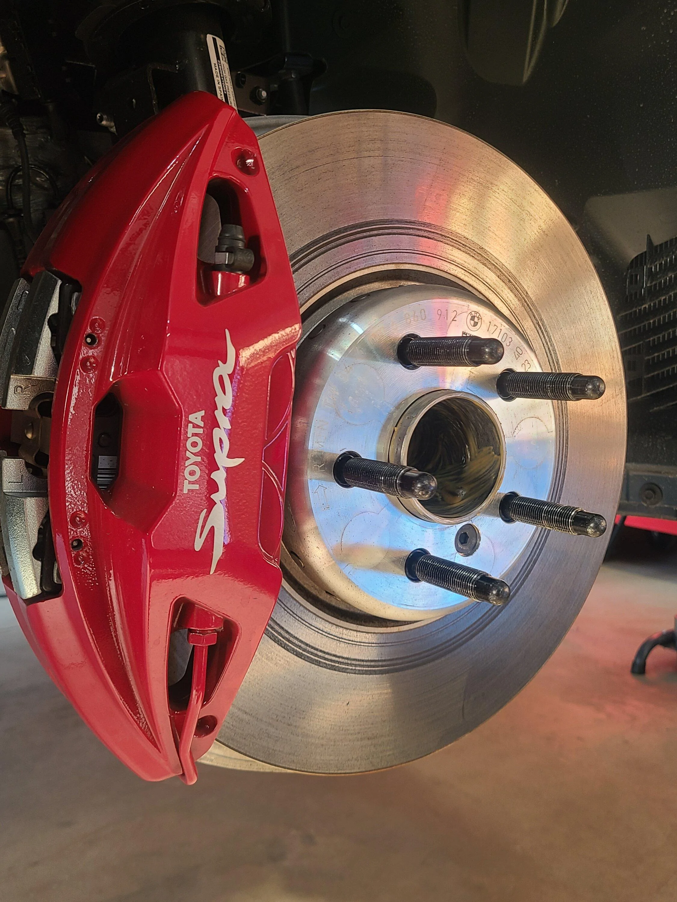

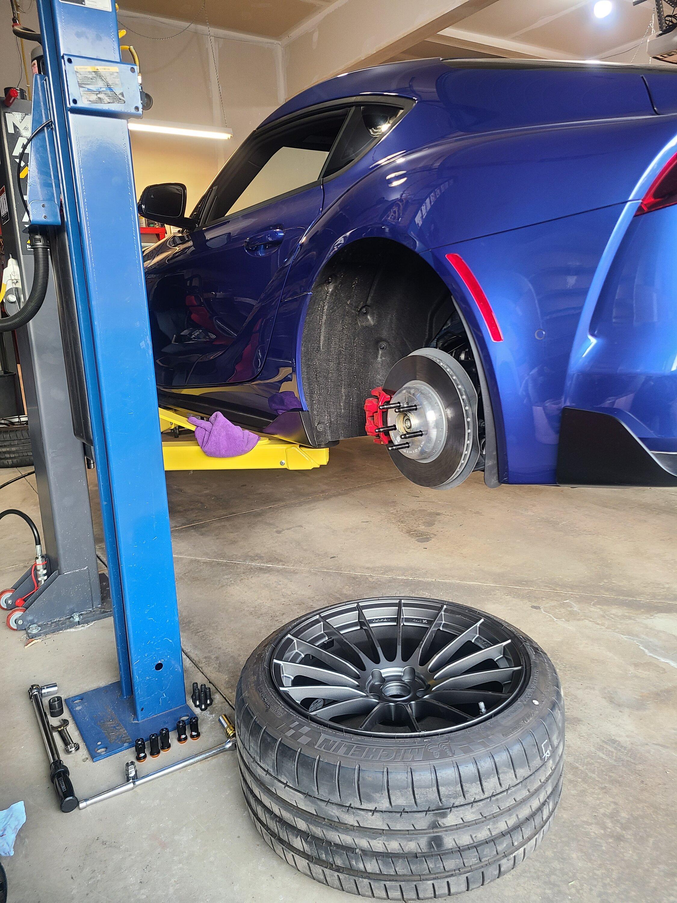

I just installed the Future Classics steel stud kit. The included nuts wouldn't thread on by hand all the way because there seems to be some mis-forming of the threads. I didn't want to ugga dugga them on and potentially ruin the threads on the stud, and I wanted some longer ones so I went with different nuts.
They installed nicely and look good, the double nut method of install got a bit tedious by the end, but it was effective. The included loc-tite was only enough to do about half of the studs, so make sure to have some extra on hand if you get them.
