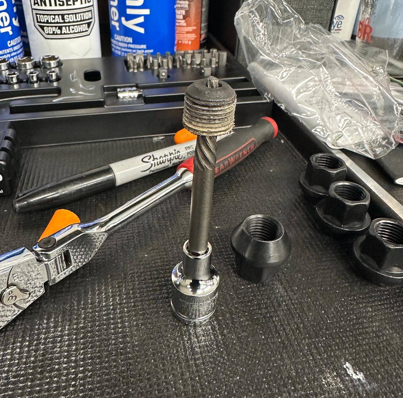

Nothing will last on the studs if you put any heat into them (track, spirited driving, etc)
I used red for the last three sets of mine. Ignore anyone saying that makes them permanent. They all come loose eventually. It's more important to check that the studs themselves aren't loose every time you take a wheel off.
In the chance a stud broke, I'd be mad if I used red and then had to try to remove it.
I had two studs break on my last set. I had used red. They all extracted without much effort using an extraction tool. Any thread locker just vanishes after enough heat cycles.
