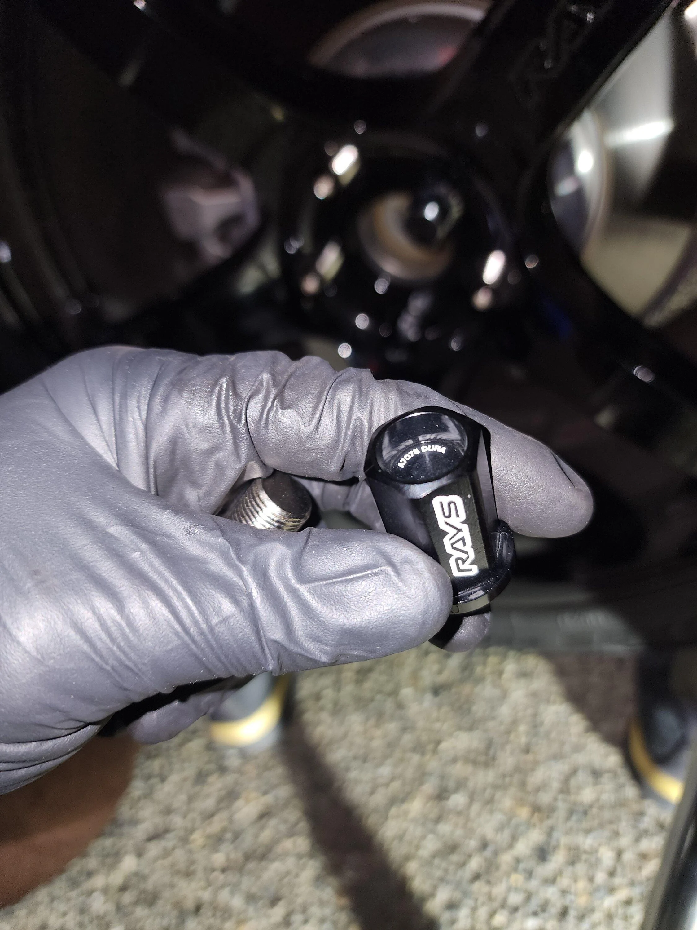

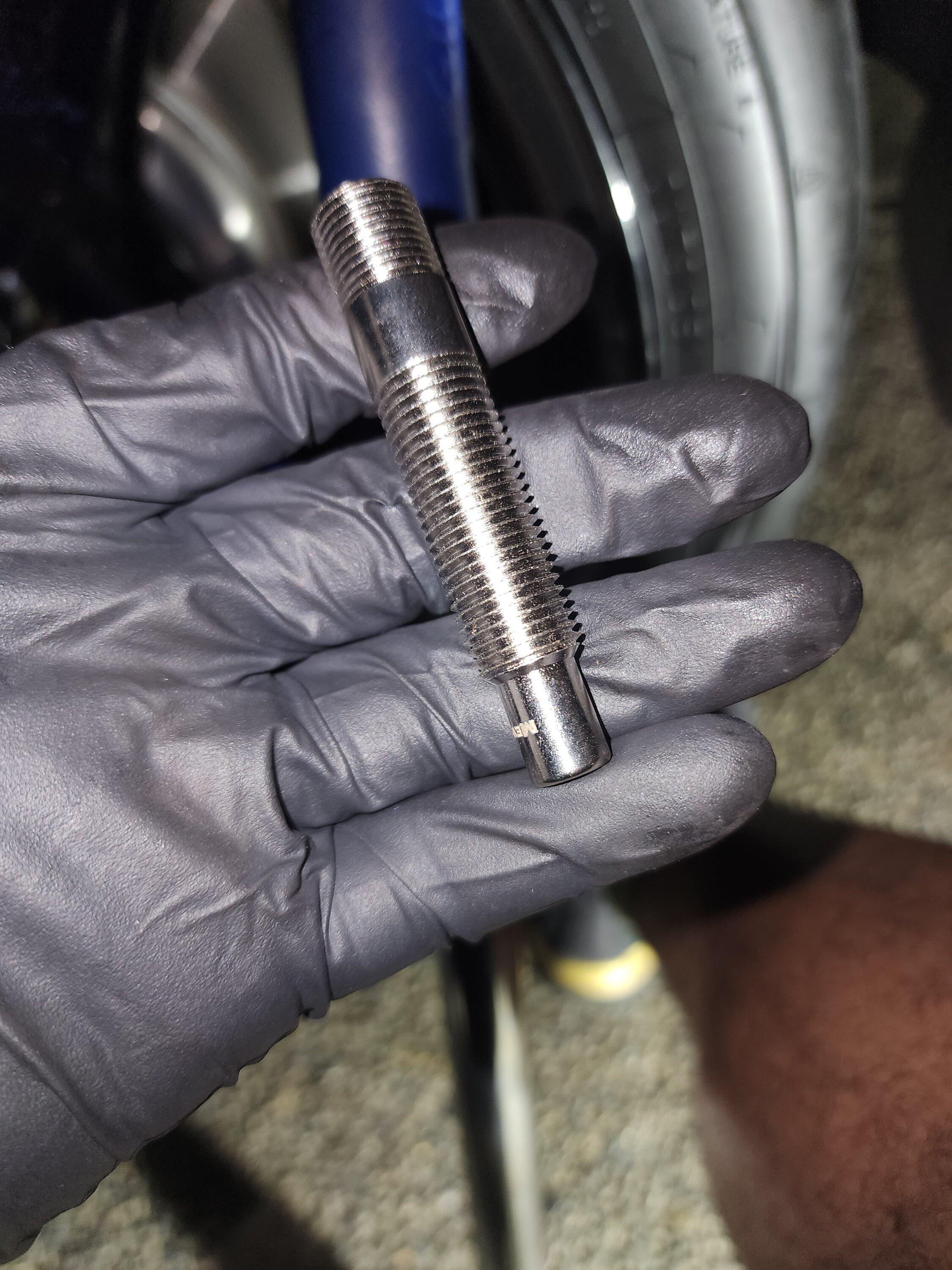

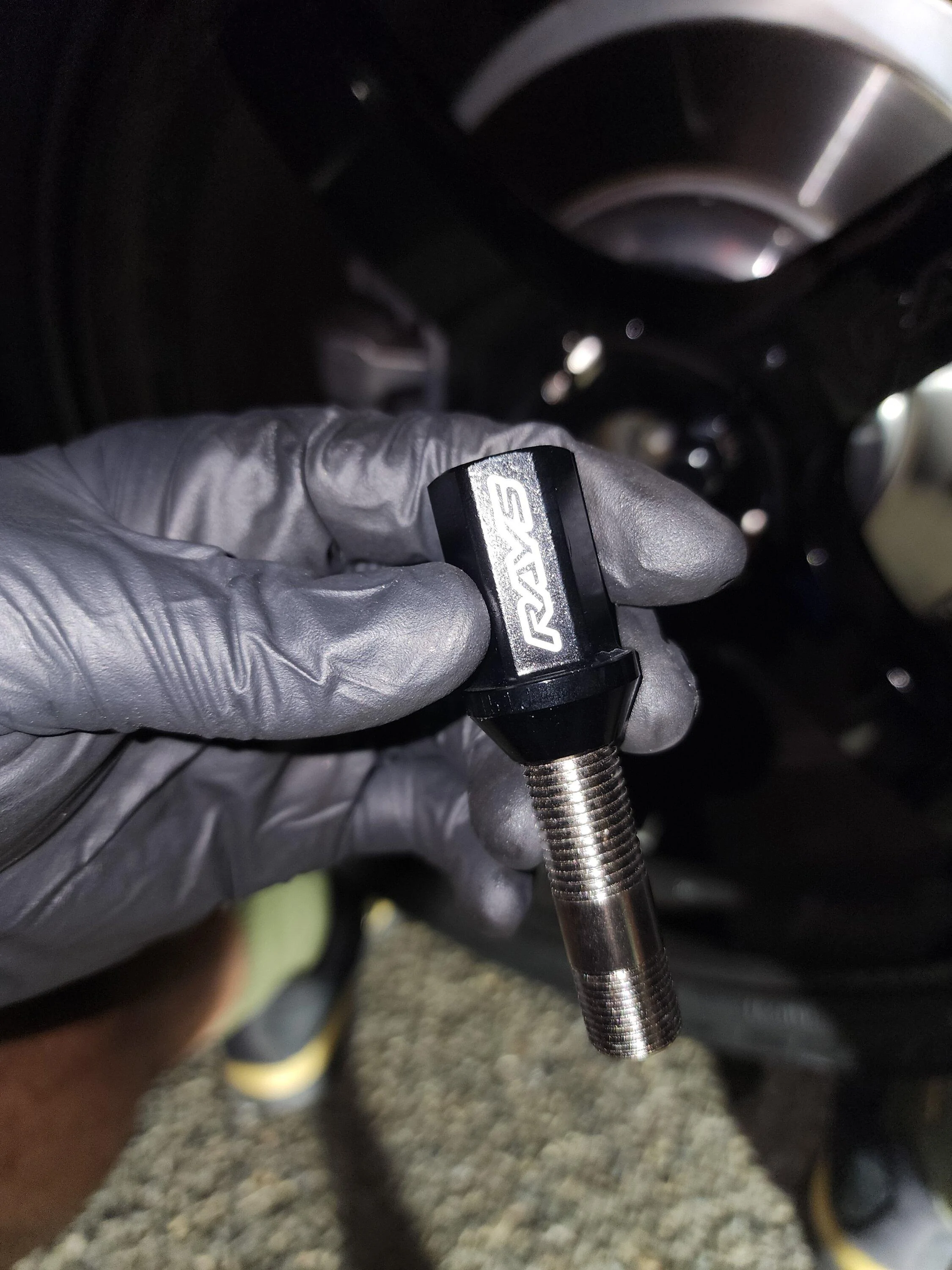

Recently got my mevius stud conversion kit, I brought the Rays Engineering dura lug kit but the bac of the lug keeps me from tightening the Lugs due to the length of the stud. What Lugs are you running if anyone is using these I'm considering running spacers now for the l9oks and to take up space

You'll need to run a open ended lug. Plenty of options out there from the likes of raceseng, project kics, etc. Or if you cant return those lugs just drill out the tops.
I've got a set of project kics monolith lugs on order but due to stud length i'll have to drill out the lock key to make it work.

Going to drill out the center, spent a pretty good penny on them, was thinking 13mm spacer front 15mm spacer Rear to take up slacc as well as get the wheel flush like I wanted but very much appreciate that. Gonna do it tomorrow.
