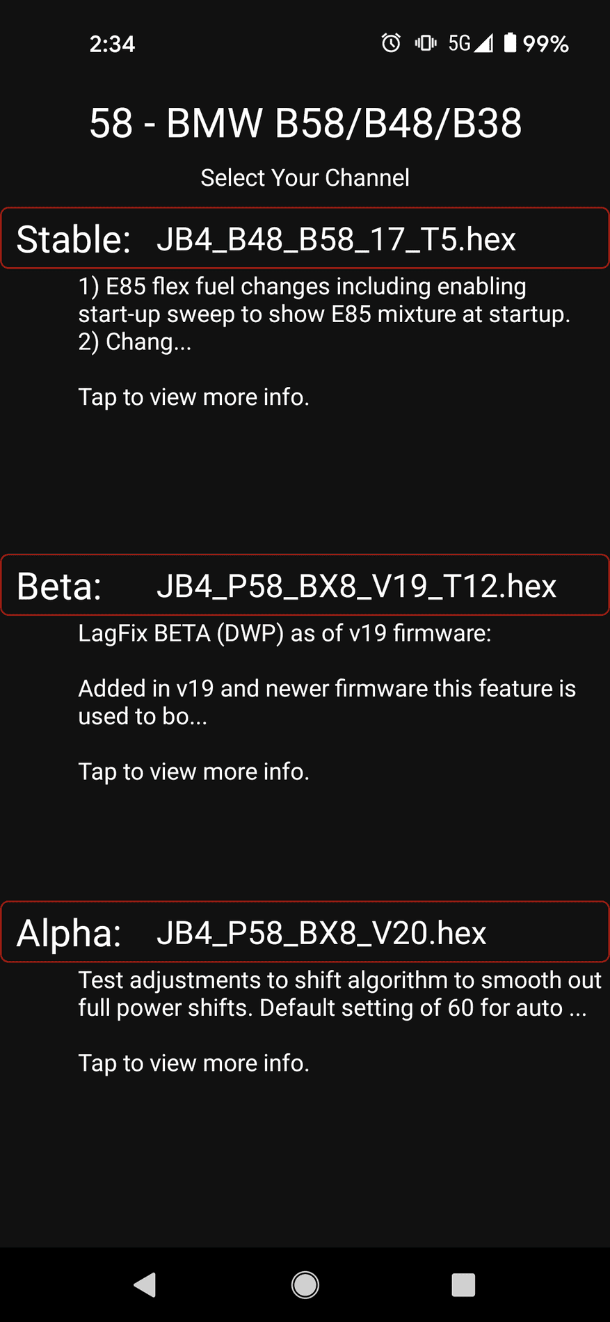

Here's my newb question of the day. Do I I stall all 3 of these firmware updates? Or just stick with Beta?
