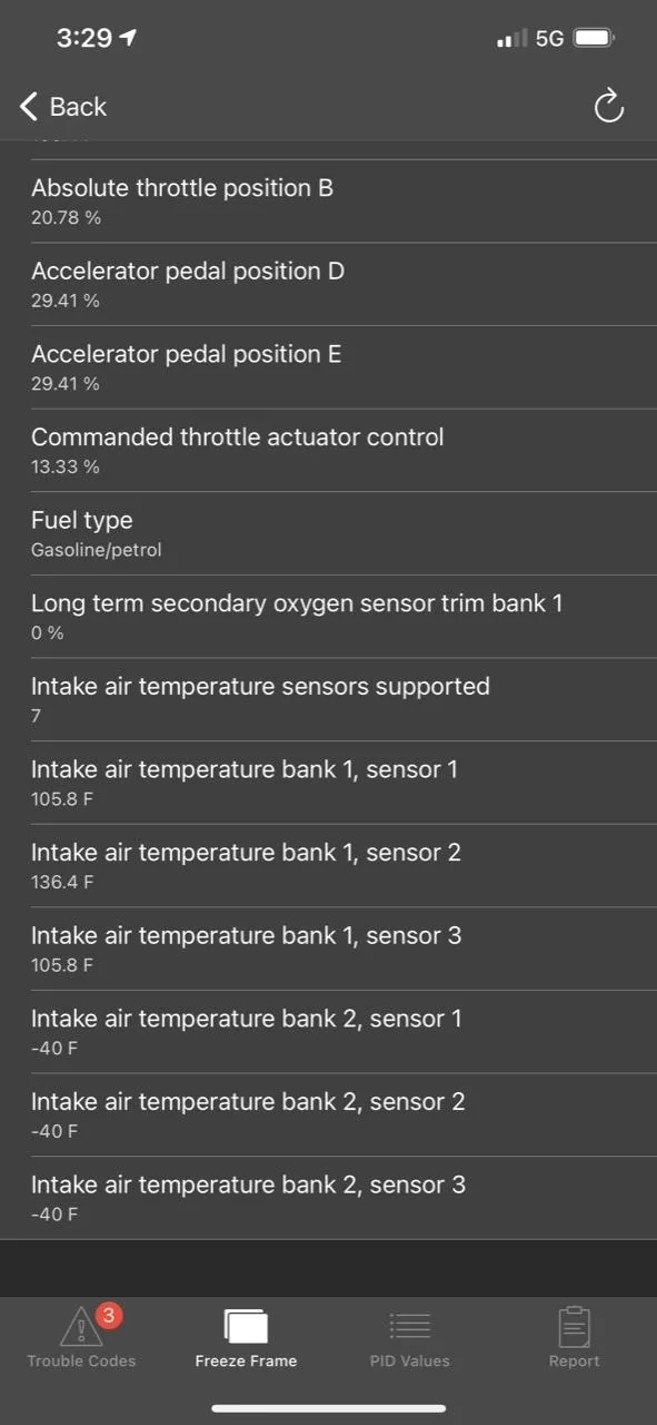

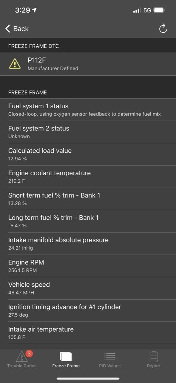

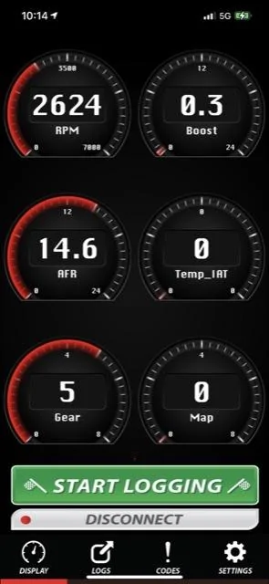

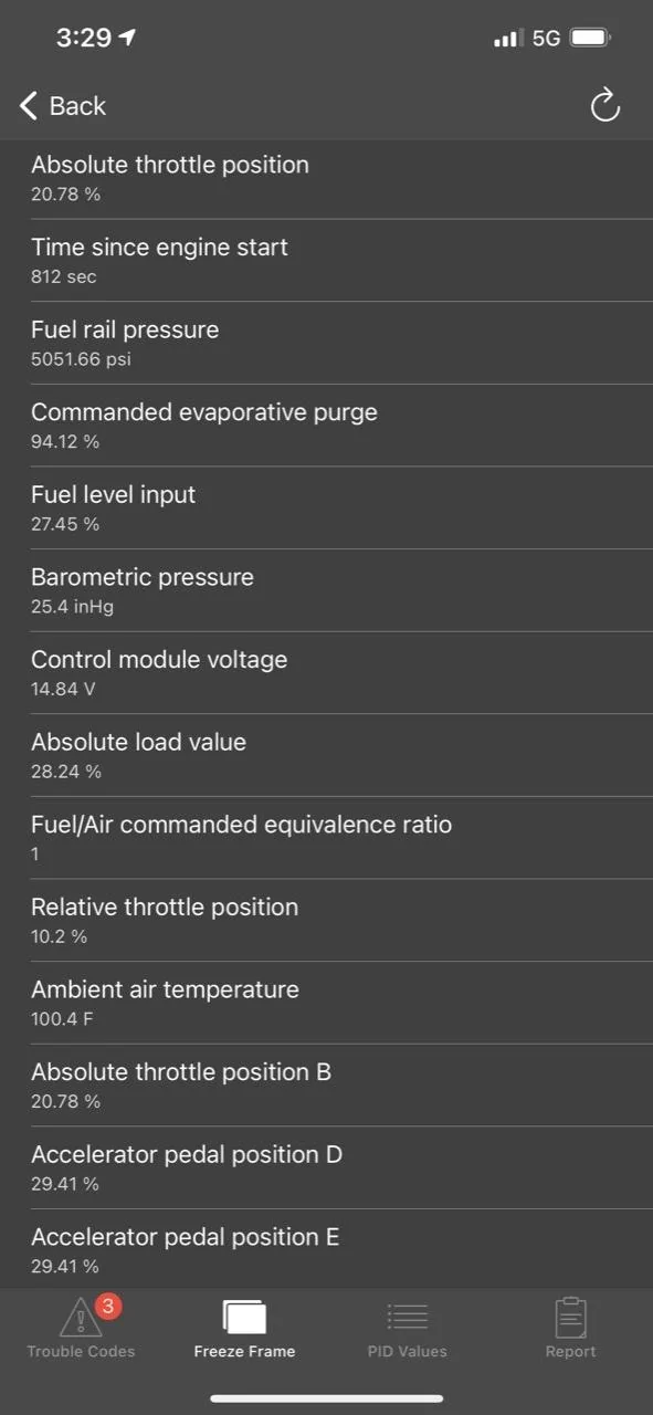

You guys seem to know a lot about the JB4 on this thread. Can you help me out please? Recently I got a CEL after installing the AA catted downpipe and after reading codes on the OBDLINK MX I got code P112F. Anyone else get that before and what is the fix? On the JB4 I got the codes in the pics I attached and I donā€™t seem to be getting a reading on the IAT gauge. Any ideas what might be causing that and what is the fix? Thanks and I appreciate any help. I also attached some screenshots of the readings from the OBDLINK MX in case anyone can see something weird there.
Did your installer or you replace the Flange Gasket? Your pipe may not have come with one. You can order one directly from speed industry Alex told me they always stock them as I had to speed ship one over when I noticed my aa catted pipe didn't come with the Flange Gasket. No gasket = leak = cel. Some have tried to replace using their old gasket but the best route is honestly to just order a new one.
JB4 can't clear it and its not JB4 causing it. The Flange gasket can be found here:
https://speedindustry.com/oem-supra-gasket-turbine-outlet-2
Hope this helps

Make sure all the connections on the JB4 are secure and the main connector doesn't have any pins that are loose. The CEL isn't the JB4, but you should definitely be getting an IAT reading.

Any and all AA catted downpipes should come with a new gasket nowadays. I got mine months ago and it came with a new flange gasket.
Hope this helps
Thanks for the info but yeah I made absolutely sure the gasket was in there and since I installed it myself I was extra careful and made sure the gasket was there. And actually I was able to clear the P112F code with the JB4 but after about 40 miles it came back on. Another weird thing Iā€™m noticing is how sluggish the car is when in Comfort Mode but seems to accelerate just fine in Sport Mode, granted itā€™s been 100 degrees outside so I bet that is affecting it.
Iā€™ll check what you suggested. If the pins on the obd connector are fine do you think the sensor went bad somehow?

Iā€™ve read a thread that explains that the jb4 is tuned to perform well in sport mode. Iā€™d only drive the car in sport and adjust elements as needed. ā€˜
Yeah I usually drive in Sport Mode but it just seems to be a sign that there is a problem with the car somewhere.

Check the charge pipe. Some owners have reported that the connections on the atfermarket charge can come loose
