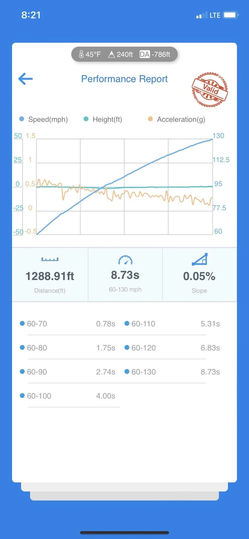

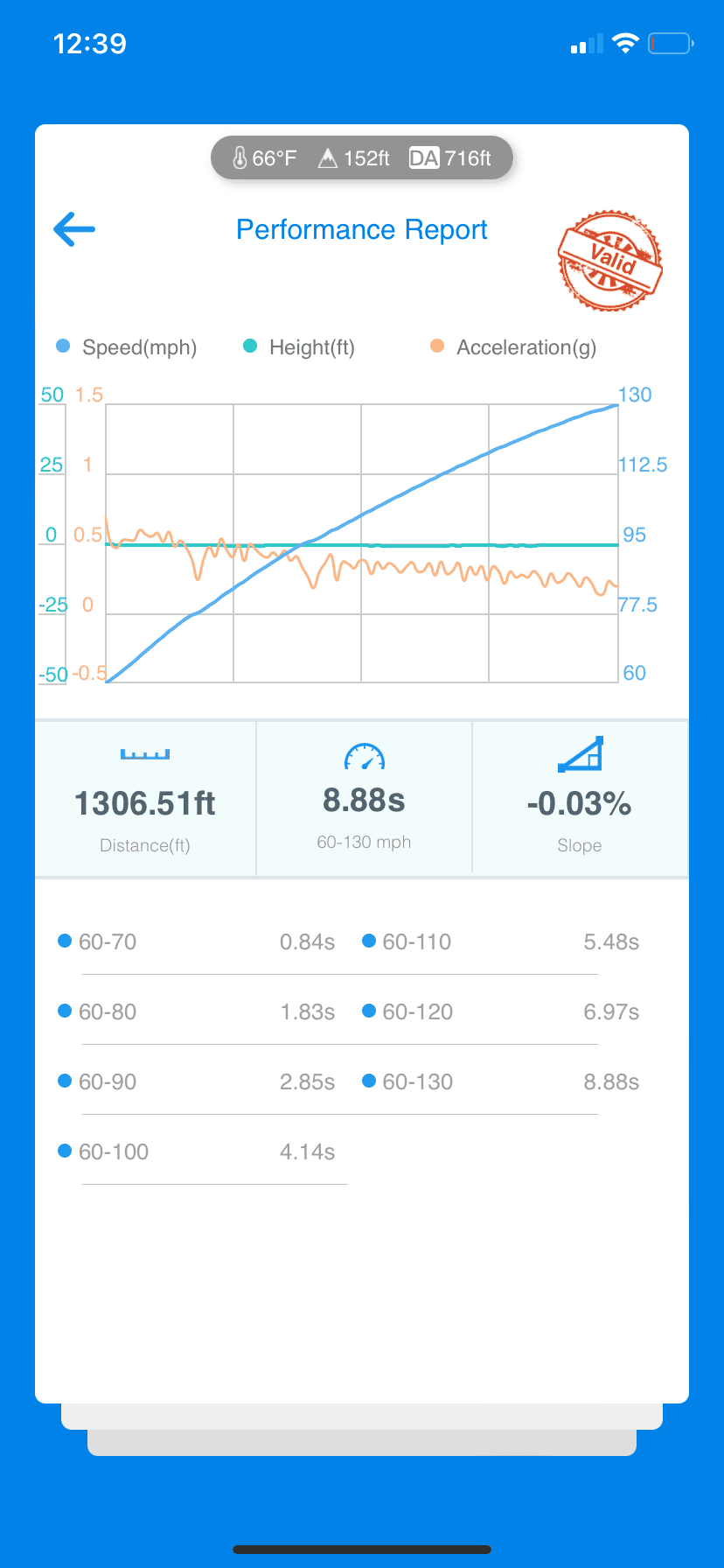

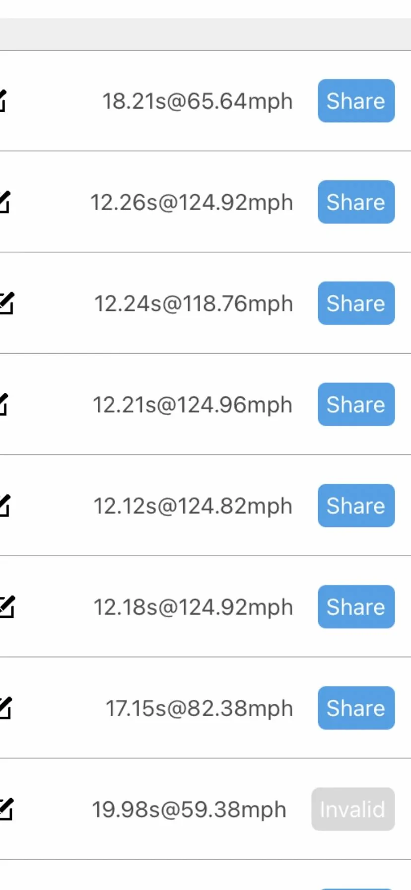

Also consistently trapping almost 125mph on the street. Of course the ETs are trash since I am on stock tires and backroads in 40deg weather :)
125 is ?? but that DA! o_O
Any results with the same mods in positive DA?
This was from last night ?? A tiny bit slower but there is some variability off the hit. The 100-130 times are essentially identical so it’s not losing any power between the DAs you see here
