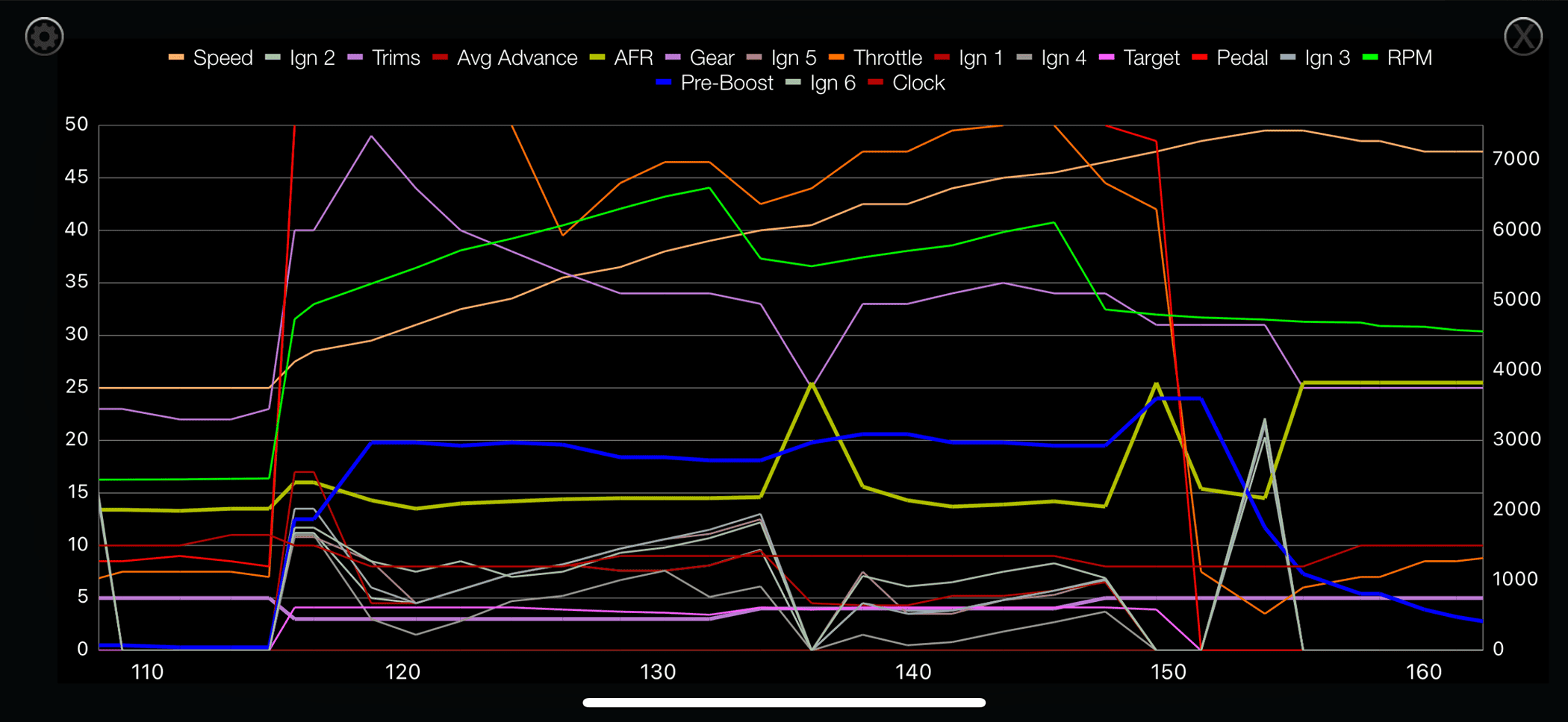

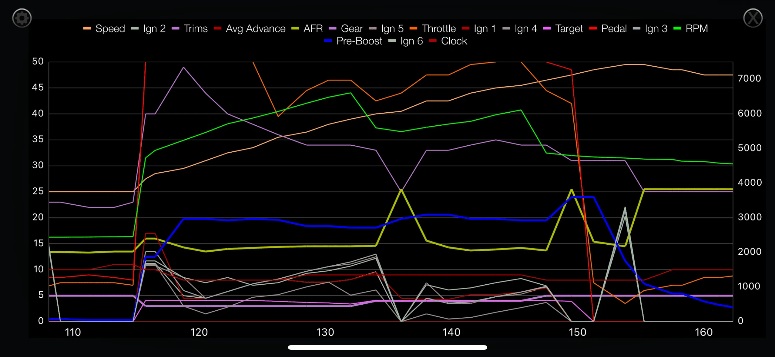

So I’m back on 93 pump gas and map 2 because so far map 2 seems to be the only map that my car runs perfectly fine on with no fueling problems. Here is the log for it. It looks a lot better to me but I wanted to get an opinion from someone more knowledgeable than me lol. Sorry it’s not a actual 3rd gear pull but I was short on time today

Also, I found out that even on 93 pump gas and map 4, map 4 still maxes out my fuel trims. So I don’t think it’s an e30 problem just map 4 and 5 do not work well with my car. Are there any other maps I can run e on?
Yeah some cars struggle a bit more with absolute maps. Send your latest Map 2 log and I'll see if there's any room for more.

Are you stock downpipe? looks like a lot of throttle activity (ie. slight overboosting)
I’m on a catless downpipe and cold air intake and that’s pretty much it for bolt ons
Ah yeah okay, you definitely need to do your duty biases then... catless will make JB4 run like shit otherwise. I really wish BMS would make this info more well known but they don't want to be involved in any emissions related stuff since they're in Cali.
start with these. get me a map 2 log from 2500 to redline (3rd or 4th gear) and one shift up.
duty_15duty_20duty_25duty_30duty_35duty_40duty_45duty_50duty_55duty_60duty_65duty_70
323232323536394855576262
by the way, this is the majority of work that is provided in a custom tune like Jesse does. It can take some time and iterations to dial in perfectly.
