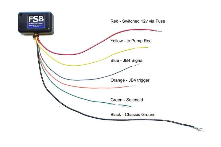

I need good write up or video on installing WMI and integrating with JB4. Found this during my search. Thanks

The installation itself is very simple. The most difficult part, which isn't very difficult, is wiring the FSB with the JB4. The actual physical hardware just goes under the passenger windshield cubby and run the lines to the charge pipe.
