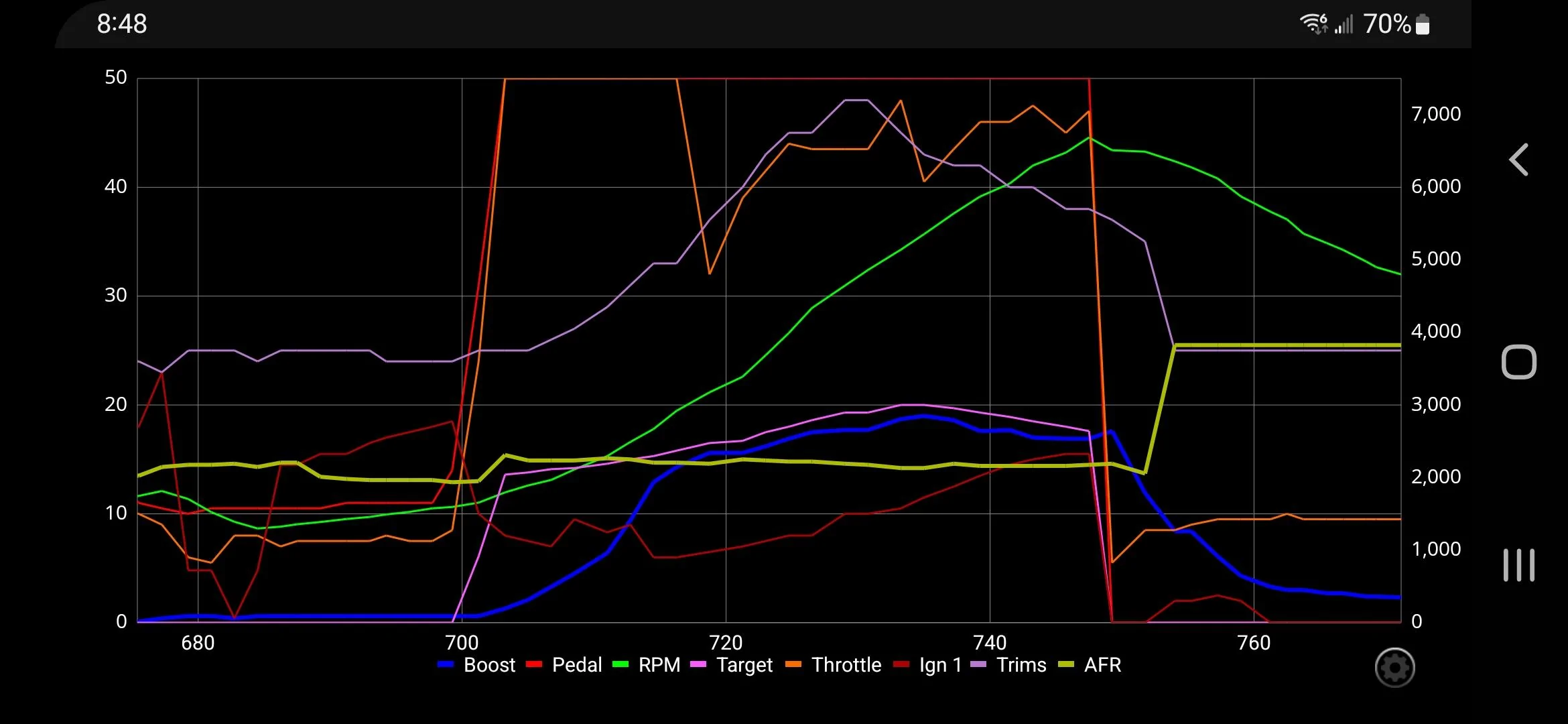

I have 30gal in my garage that I need to burn through. Lol. Then I'll go back to pump gas.
I did a few acceleration bursts and one 3rd gear pull. Didn't want to push anything until I know what I was dealing with.

Just post a picture of the graph of the log during a pull.

Zooming in to the one pull is best I can do. The log was kinda long.
It would probably be easier for me to post the data/numbers.

I don't know what that is. ?
https://datazap.me/
Create account, upload log and share link here. Bask in the joy of free 'wisdom'.
The snippet looks ok. The wacky throttle activity is what gets smoothed out with a custom tune.

Got it. Will do. I thought he was saying something like "Venmo me". ?
I saw the ECU messing with the TB. I assume it's some type of safety mechanism. Most people don't like/aren't comfortable with spinning tires.

You got traction on or something? That looks rough.

I'm 99.9% sure I had TCS off, but it really does look like it was on. I did have DSC on, though.
I'll go try again today.

Yeah, that's what I mean. DSC.
It was but it felt like the car went straight. Though I guess that's the point ? I didn't think 3rd gear would need assistance.
I'll try again today, with everything off.

Stock tune uses the throttle for torque control. That is what you are seeing.
Lotta boost and timing for oem AFR. Just my opinion.

Makes sense. Better than bending rods. I thought that AFR was in line with other e30 logs, but I've only seen a couple.
MAP2, it is.
