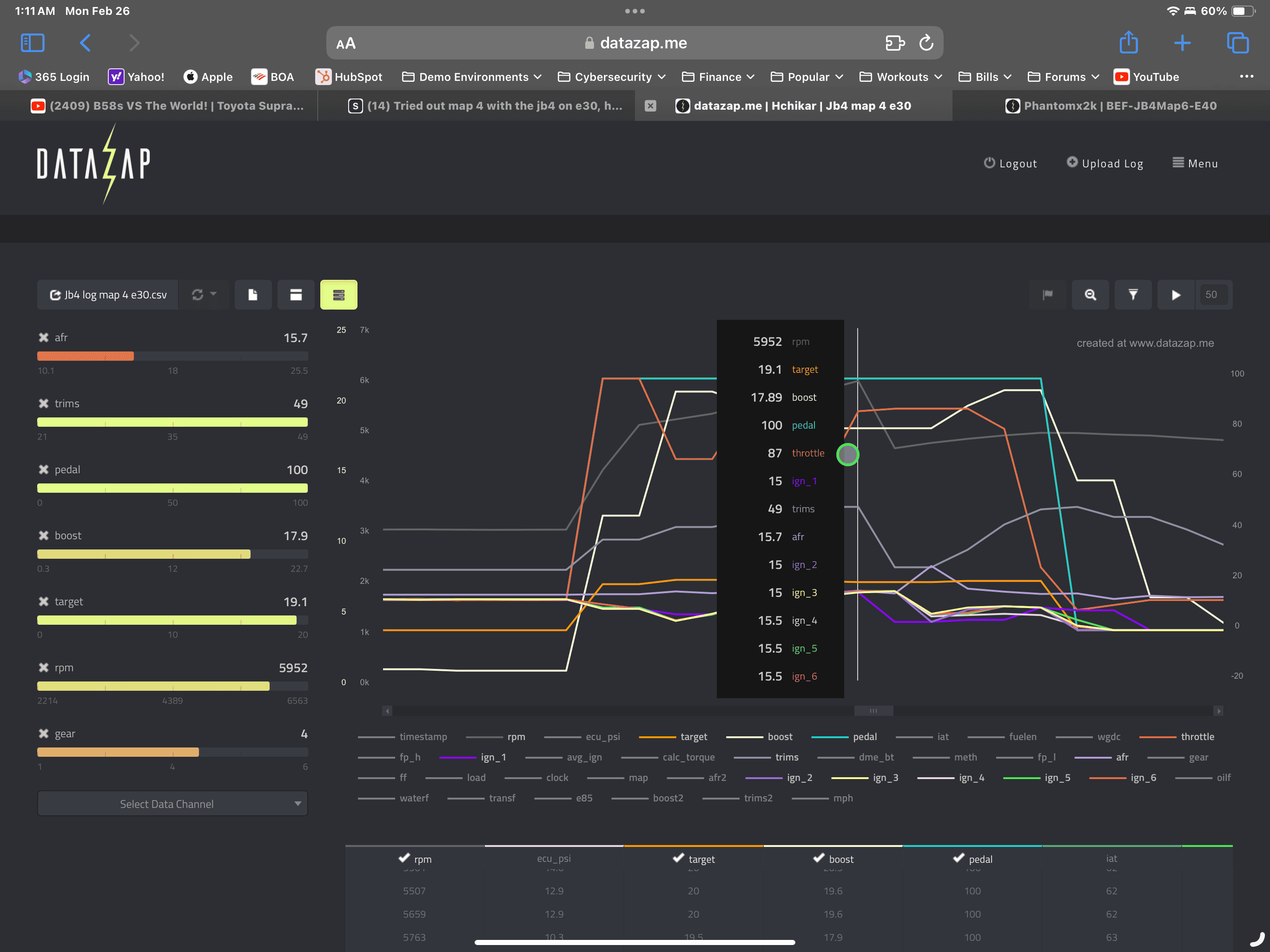

Tried out map 4 with the jb4 on e30, here are the logs…

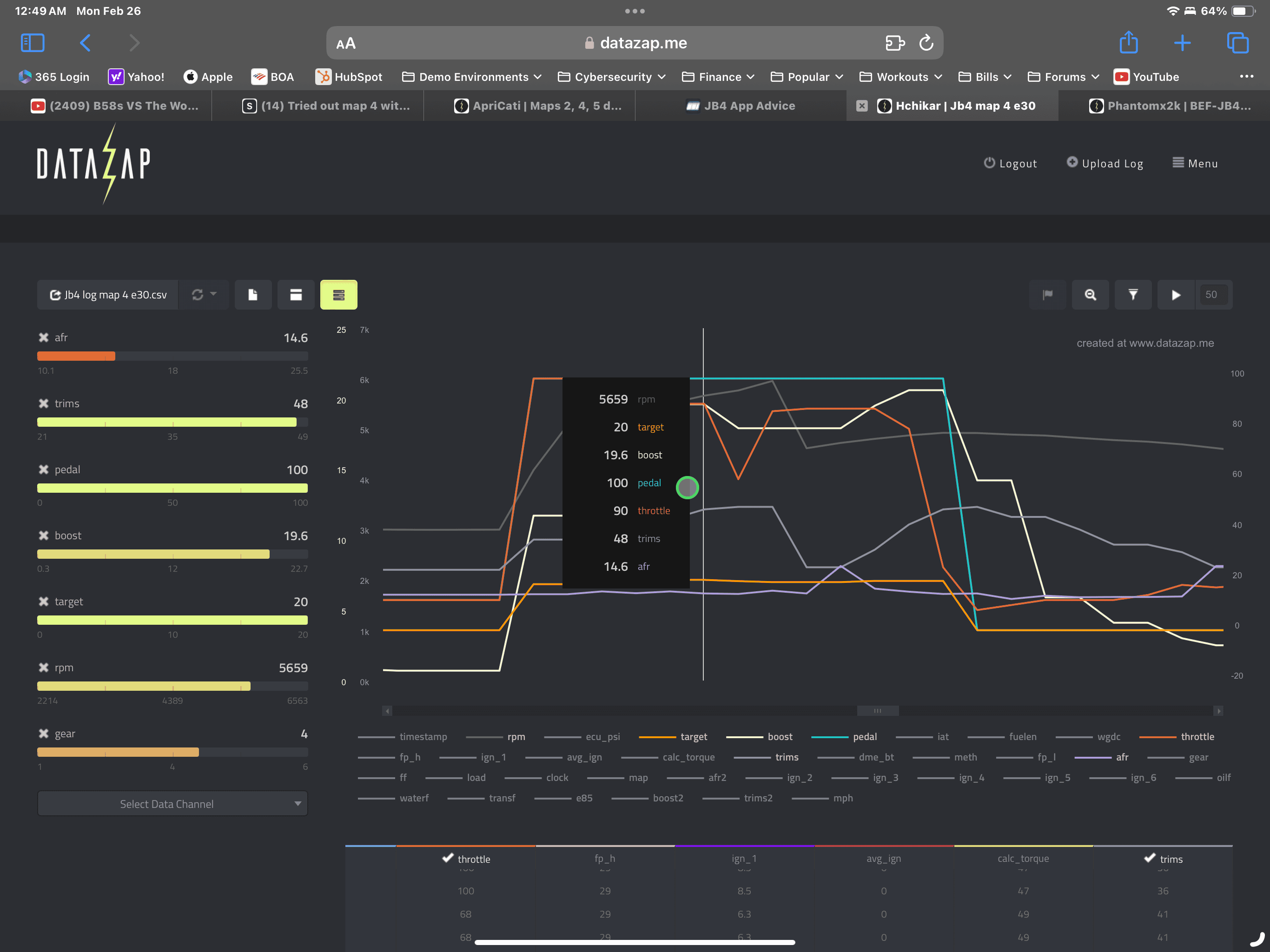

Ah yeah okay, you definitely need to do your duty biases then... catless will make JB4 run like shit otherwise. I really wish BMS would make this info more well known but they don't want to be involved in any emissions related stuff since they're in Cali.
start with these. get me a map 2 log from 2500 to redline (3rd or 4th gear) and one shift up.

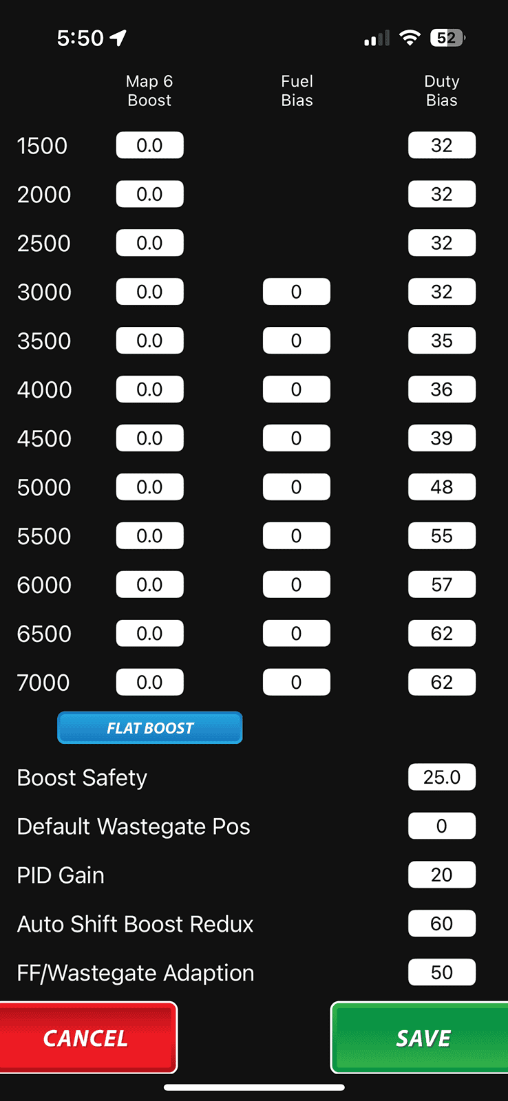

duty_15duty_20duty_25duty_30duty_35duty_40duty_45duty_50duty_55duty_60duty_65duty_70
323232323536394855576262
by the way, this is the majority of work that is provided in a custom tune like Jesse does. It can take some time and iterations to dial in perfectly.
So like this? Will this apply directly to map 2, and also do I need to change anything else? Sorry if these are dumb questions

Getting better. Try it at with FF set to 40 and log again
Gotcha, will do tmr, cops are really active around where I’m at at this time lol. I really appreciate the feedback and advice

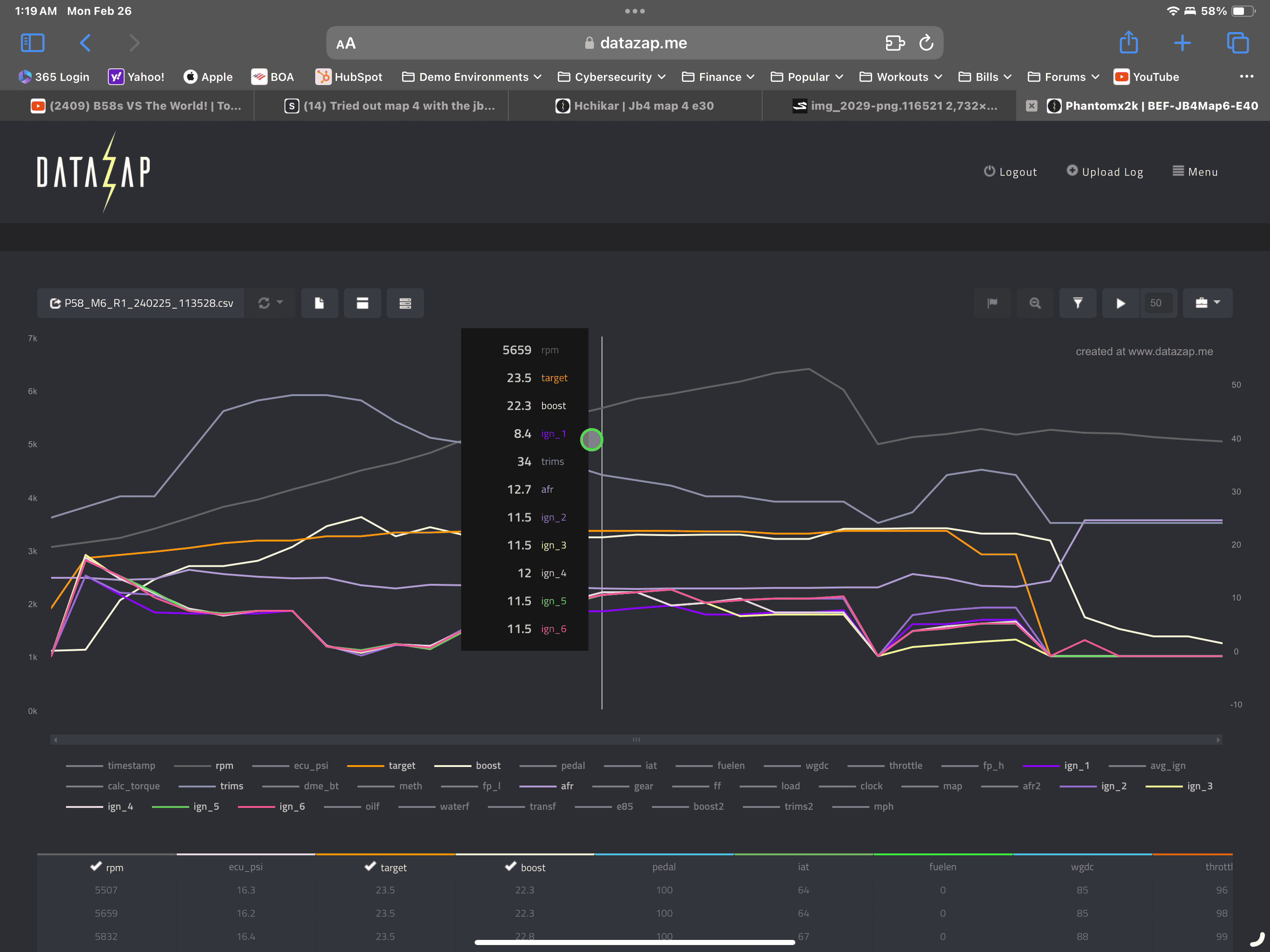

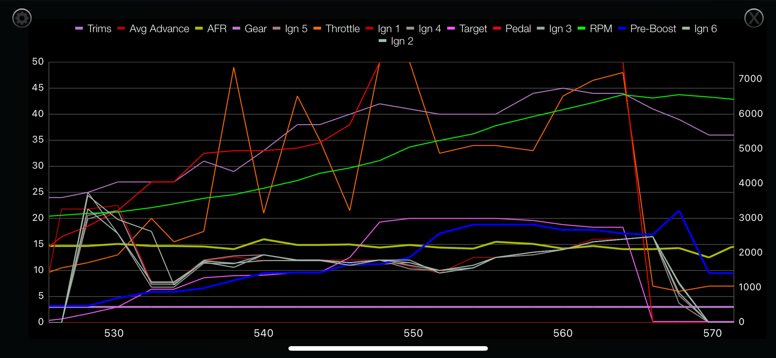

cleaning up, yeah. just keep dropping duty bias by a couple in areas where there is closure until its pretty minimal. excluding during spool, normal.
It just looks to be too much boost. Your car wants to run a lot of boost already, so 21 psi is just too much without ethanol. So either swap to map 1 or put a gallon or two of E85 in
You want to see ign1-6 climb linearly to redline. usually at least 10 degrees or more as you get towards redline.
this is a golden log - https://datazap.me/u/coloneladama/log-1708732537?log=0&data=1-3-4-9-11-14-18-25-26-27-28
so that is what you are looking for.
So I can put ethanol in on map 2?

you can in any map if you aren't sustaining high trims. just start with 1-2 gal at most though
I’ll start out in map 2 since we got that dialed in a little better. Now if I do decide to switch to any other map am I going to have to go in and adjust the duty bias and ff again or will the settings save across all maps?

  • Duty bias values are global so they affect all maps. (absolute targeting only - map 4 and 5)
  • FF value is saved PER MAP.
