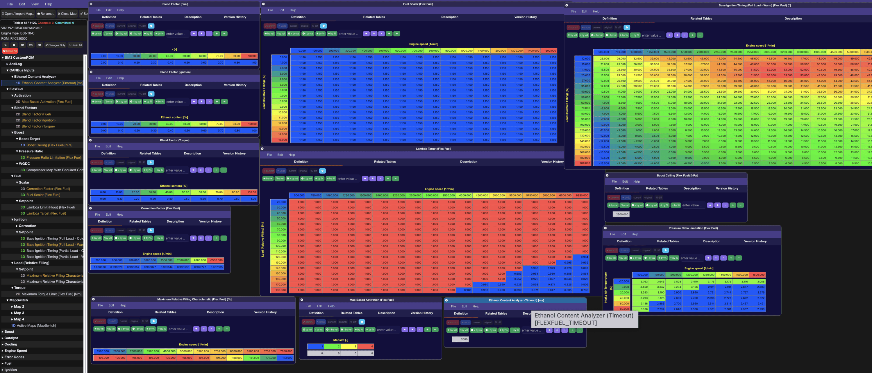

It's just like the Evos, you need an actual continental flex fuel sensor wired into the ECU and the ECU tuned/modded to have flex fuel tables properly setup. (see screenshot below)
What is *not* like the Evos is that you have to also add port injection to run full E85. Things get complicated quickly.
The OEM ECU calibration can run up to E25 no issue as the fuel trims basically have enough latitude to compensate. Think of it as OEM flex fuel but only up to E25. ;)

So nope on e85 lol. I'm assuming car runs like crap on anything north of e25. I don't feel like playing that guessing game, anyway. I'm actually relieved to be sticking with pump. SO much easier and no more transporting 20gal of fuel to the track. ?
8,817
17,303
It would start leaning out once the fuel trims max. Since the Supra runs 14.3-13.8 already at WOT, running leaner is really running leaner…
