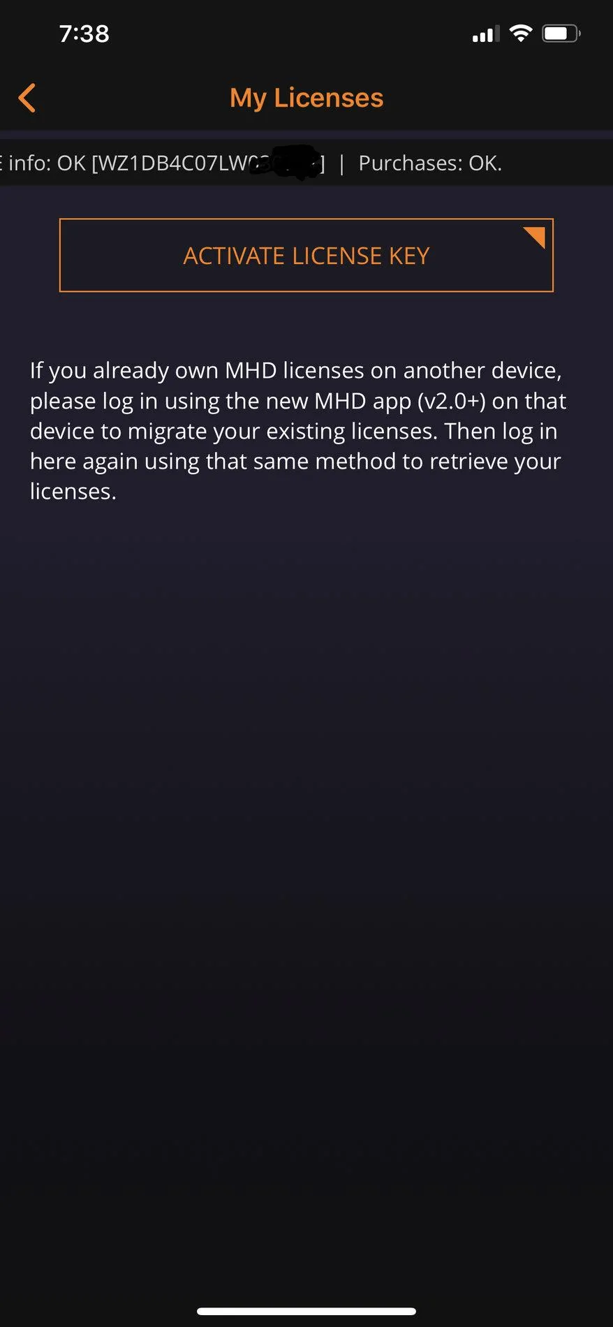

I connected my MHD Flasher tonight and read my DME via generating a backup. I was able to generate the backup so now it shows my DME under "My Licenses" but the only option is "Activate License Key". I don't have an option to purchase any of the licenses or go to a license store.
Anyone run into this issue? What am I doing wrong?

This is what I see.

I originally tuned using an Android device. When IOS became available I had this problem. I think I had to install new Android version of flasher.

I'm just about ready to buy the modules from MHD's website and see if I can do it that way.

Figured it out. So, since MHD's Andriod app is setup to pay through the Google Play store you can purchase from inside the App. it appears they don't have anything setup through Apple's store to do this. I ended up going on the website and grabbing the licenses I needed.
Edit: Confirmed. I'm all good to go.
