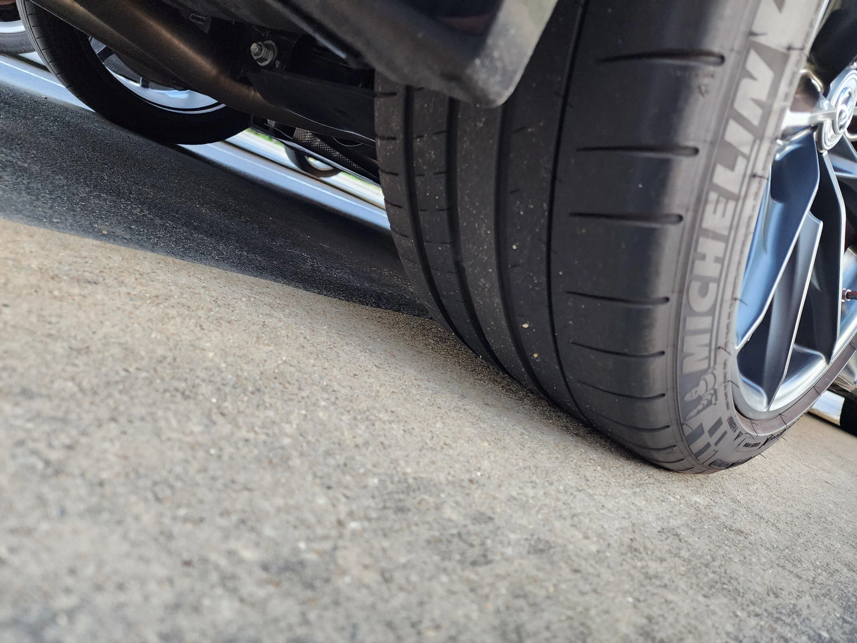

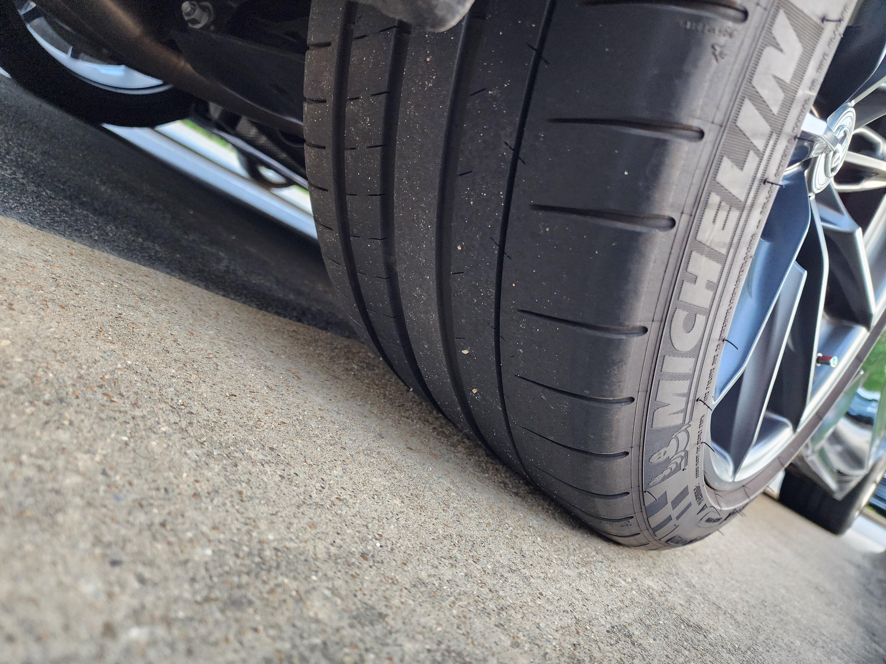

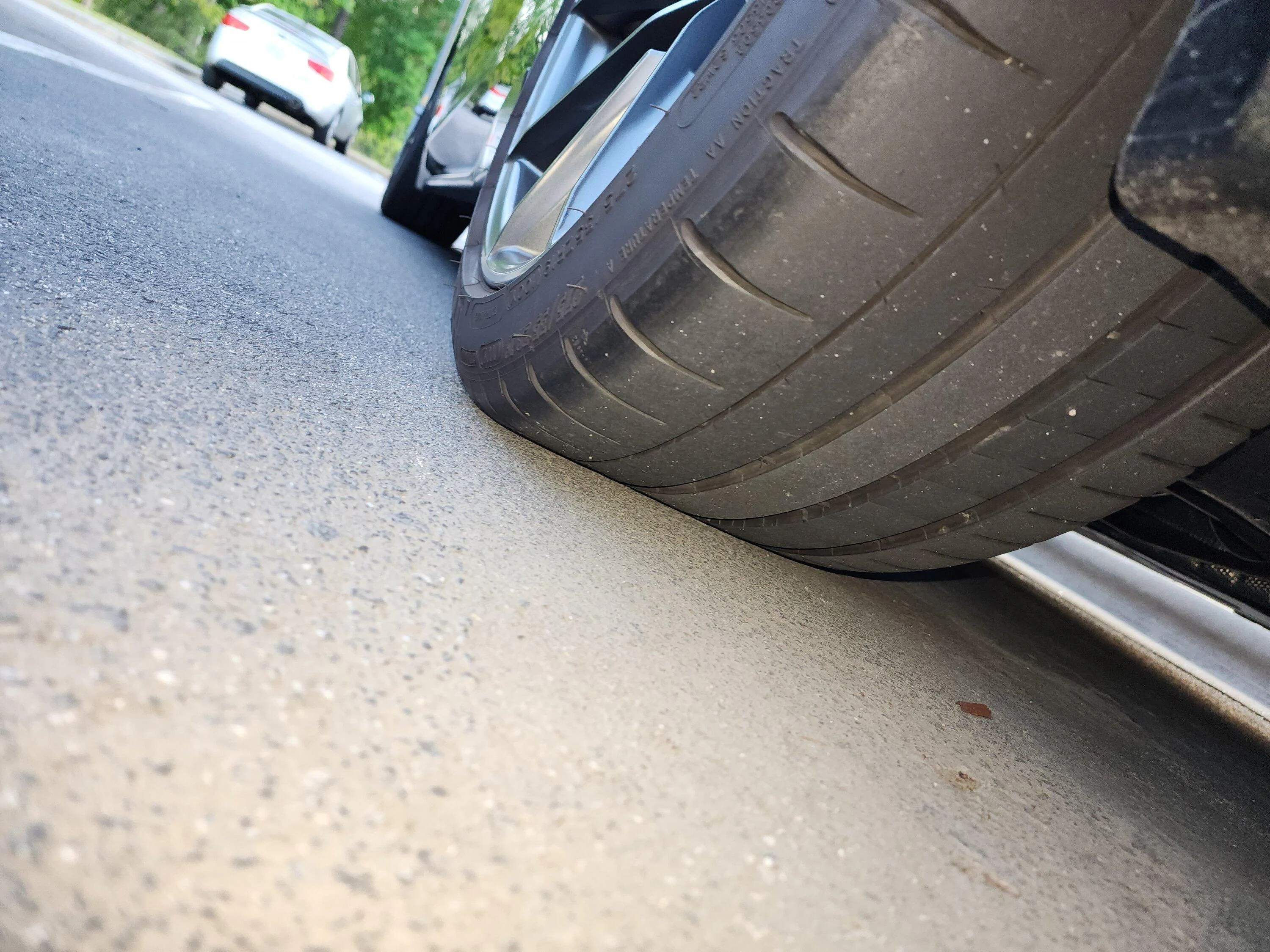

Hi guys, I have no idea about a lot of things with cars yet. So one of these things is my tire tread. Can someone let me know where my tread is currently at by looking at it? I don't have the thing to measure it yet!
The car is at 9000 miles and I daily it. Moderate to hard driving at times. Should I replace the 2 rear? Front looks fine.

Agree with @cbring, not needed but at least start searching. Maybe not a bad idea to even order with how long some have waited for certain tires.

As mentioned, it's time to start looking into new rubber.

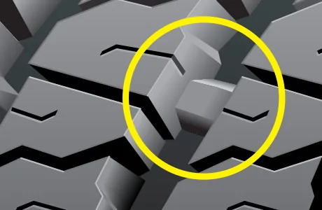

You can also gauge the tread depth by referencing the tire’s wear indicator bars. Most tires are built wear indicators moulded into the tread grooves, as seen in the image below.
These bars are raised to 2/32nds of an inch. If your tread depth is level with the tire’s wear indicator, your tires are completely worn out.

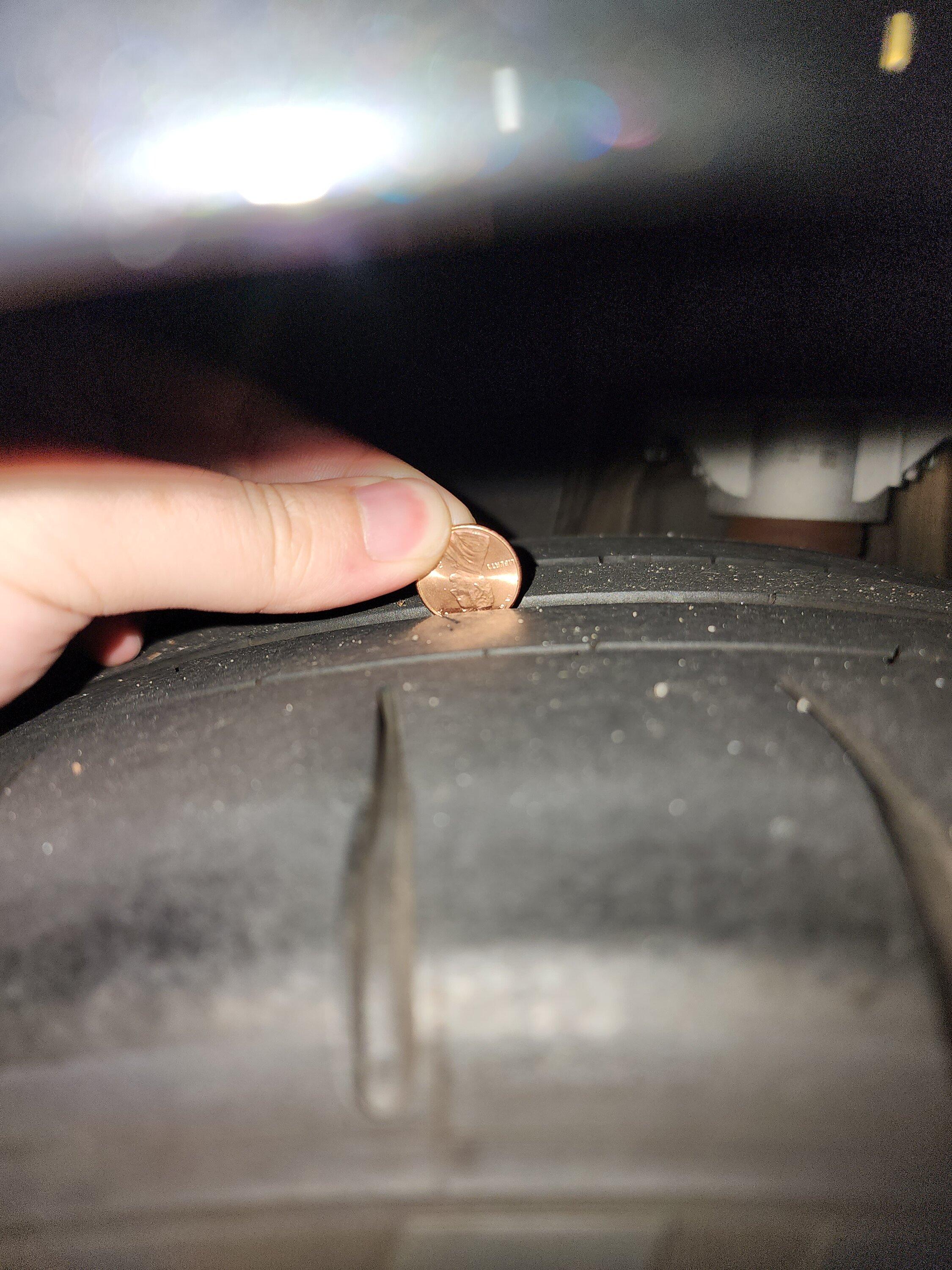

Mine are about this, def time to replace. I squeezed out 13k miles out of them
I go longer as well but… Assuming they’re not old, tire rot, worn on other areas, etc. Discount Tire is fantastic! Wife just bought a full set for my mom’s Mazda 3 and wheels from them. I wouldn’t want her driving on that. But I would. Depends on how comfortable you are with grip loss and age of those tires.
