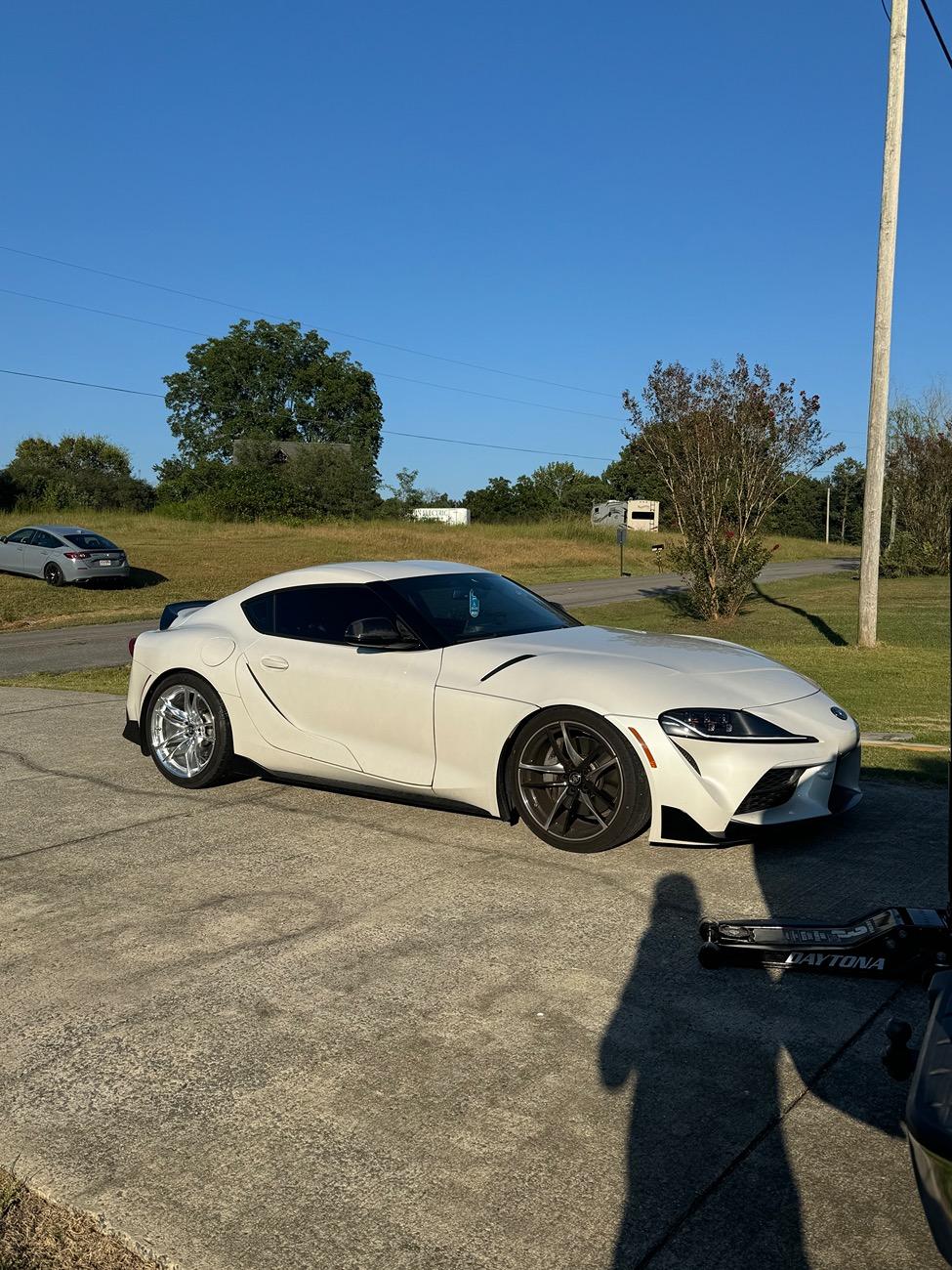

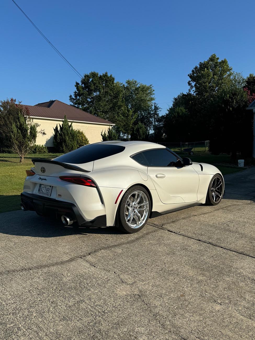

Update, it just took a LOT of coats, and an entire weekend chipping away with plastic scrapers and slowly polishing. And that was only two wheels. Maybe I’m just stupid and don’t know what I’m doing, but I’ve never tried a DIY thing like this before. Will do the fronts next weekend. Very pleased!
