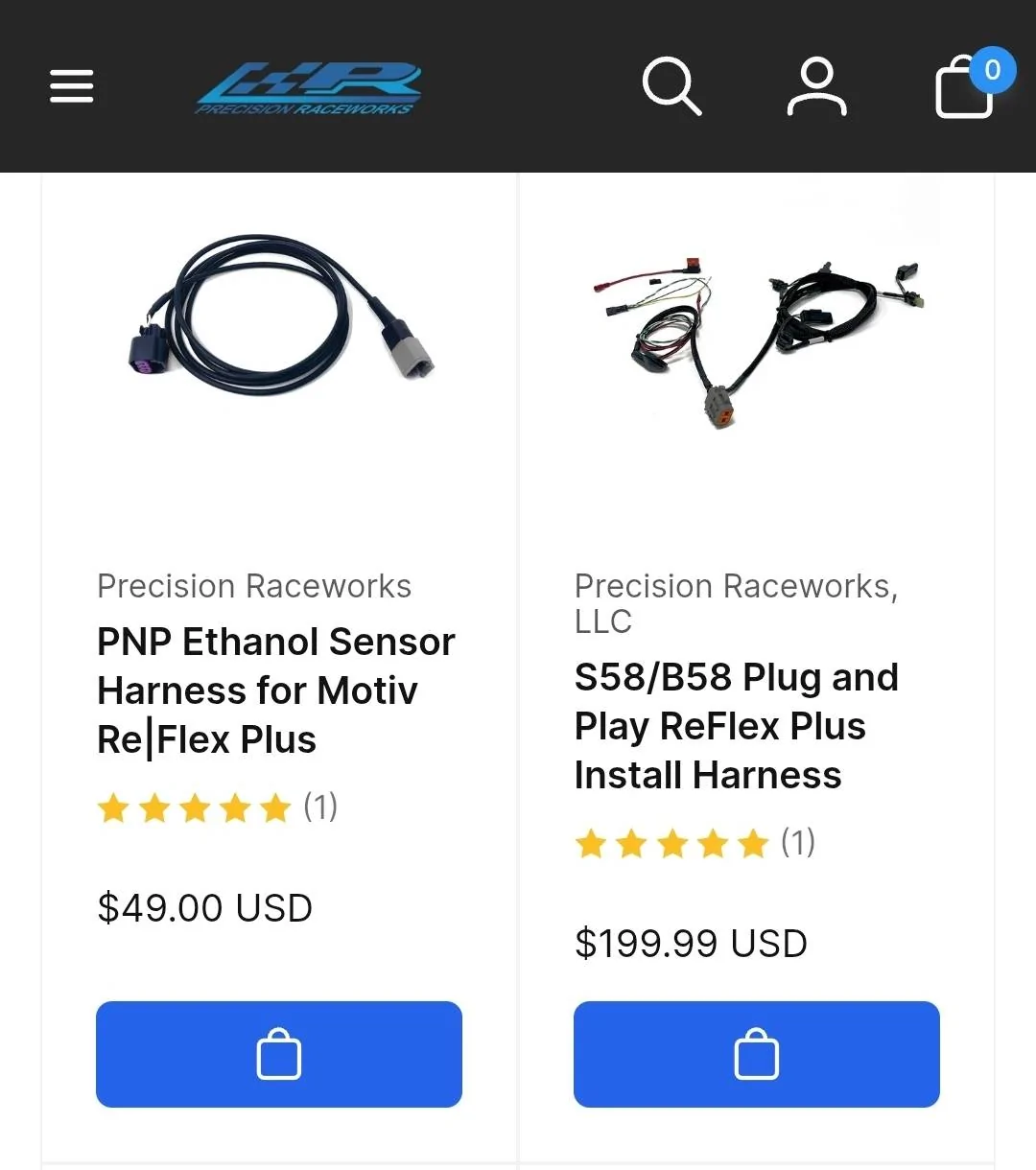

Which motiv reflex harness integrates with MHD+ flex fuel sensor/pnp harness? Most of the instructions are ambiguous. Visconti says theirs doesn't work with the non-visconti flex kits, I'm assuming the TMS one does. Anyone been down this road with input to offer?
Setup is
Big lpfp (PFS 1000hp drop in)
Pure800
Wagner mani + ID1050x injectors
mhd+flex fuel
mhd+ tuning
Just need the right motiv harness to complete the setup
It appears that the TMS race reflex just uses a standard flex fuel connector so it should work with any kit that uses that standard sensor (mhd+ etc) so that's the road I'm going to choose unless someone says otherwise.

Seems like the mhd flex sensor is overly complicated. I used a precision raceworks reflex harness main harness and ethanol harness which just plugs into the standard sensor. To view my e content I have to view in the mhd app monitor screen.
They're all the same sensor. The only difference is how the harnesses tie into the canbus.
Yes. Im aware but the mhd kit has extra wires and a special box with lights on it. The two harnesses I mentioned would eliminate all that.

All you need in this screenshot minus the actual reflex box.
