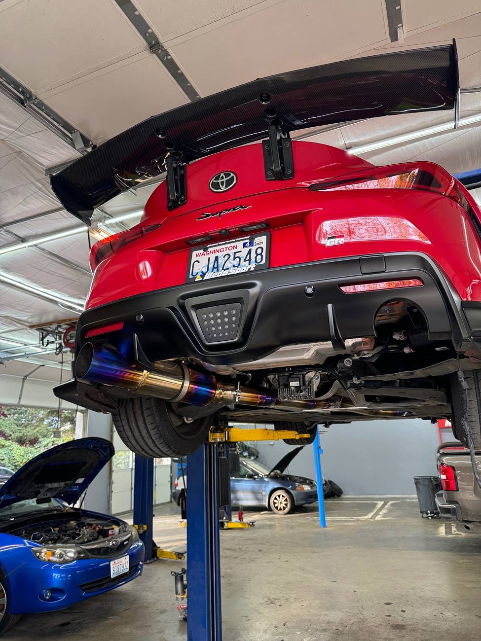

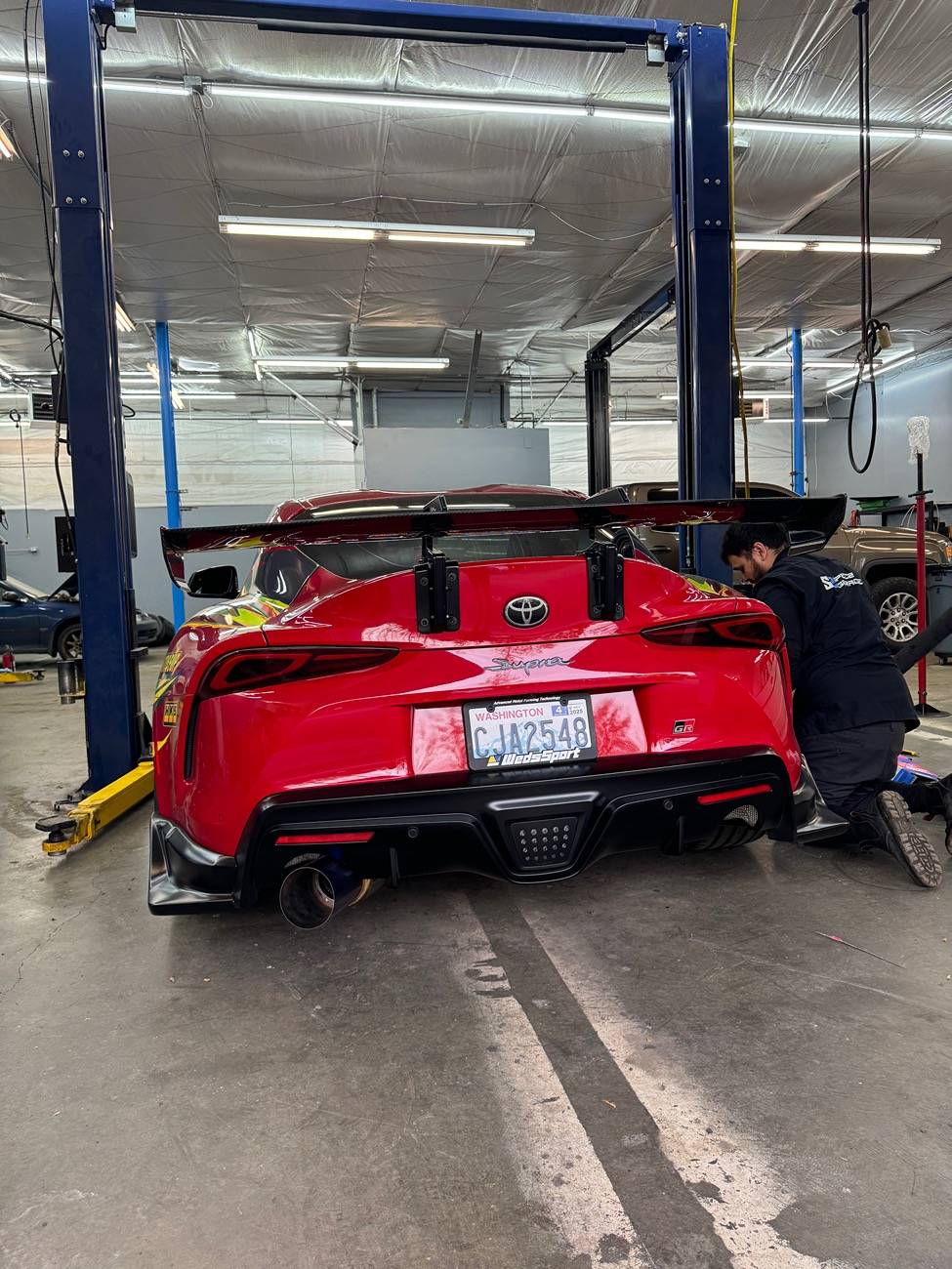

Got my SP1-R exhaust on the car and sounds excellent. I’ll have clips later when I get some time and better weather. Couple of notes:
1. Fitment is tight so be super careful when installing and torquing everything down as stuff will shift. I had to hammer some room on the heat shield to give me clearance that I was comfortable with.
2. Drone was definitely tolerable. In fact it is was better than the boost logic exhaust I was coming from. BUT my car is a manual so i cruise at 2500 rpm or higher most of the time at freeway speeds. I can definitely feel drone discomfort if my car is under 2k.
3. Exhaust gets significantly hotter compared to my old exhaust. Probably because it’s single exit but it’s important to make sure nothing touches for this reason.
