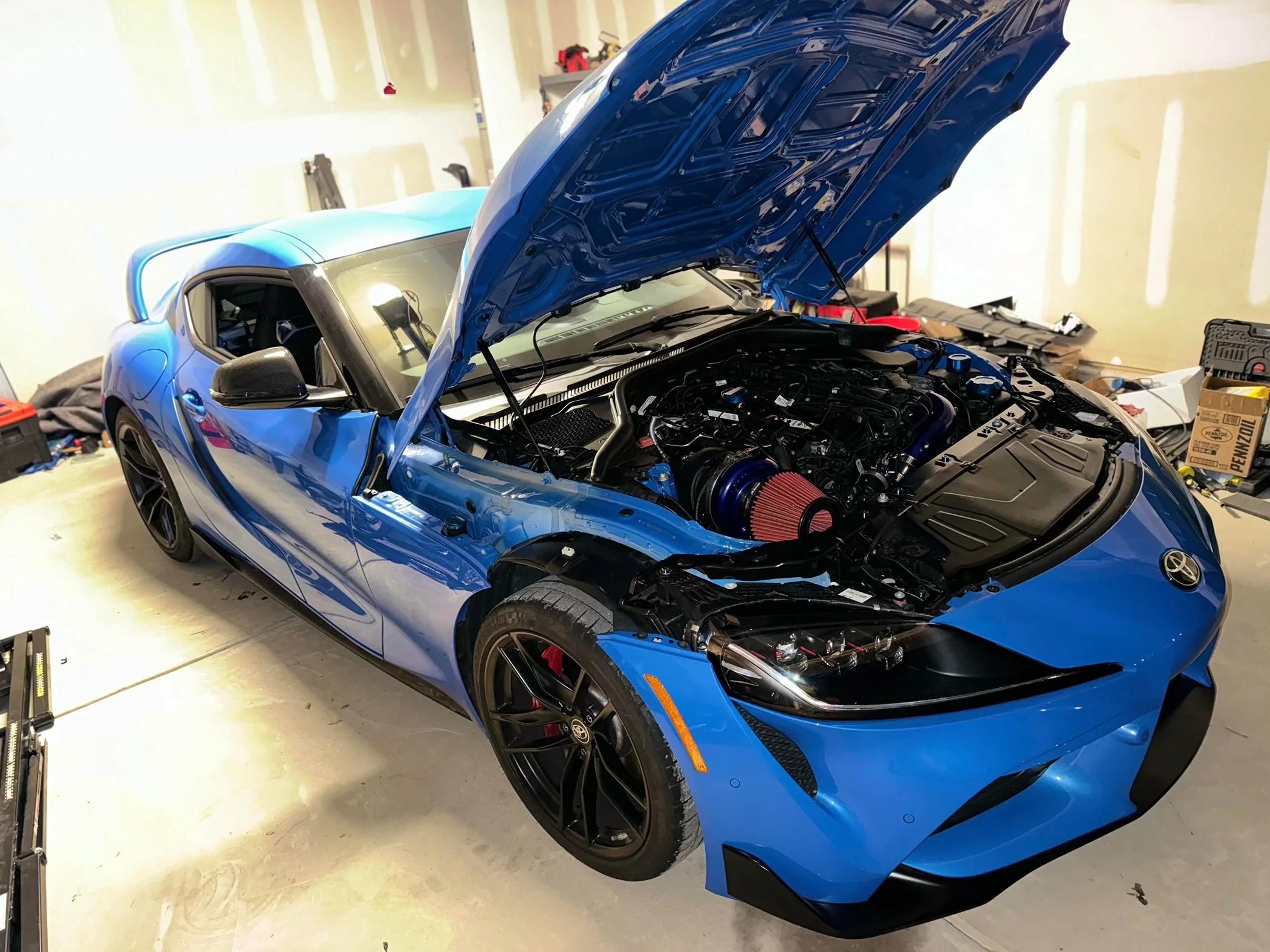

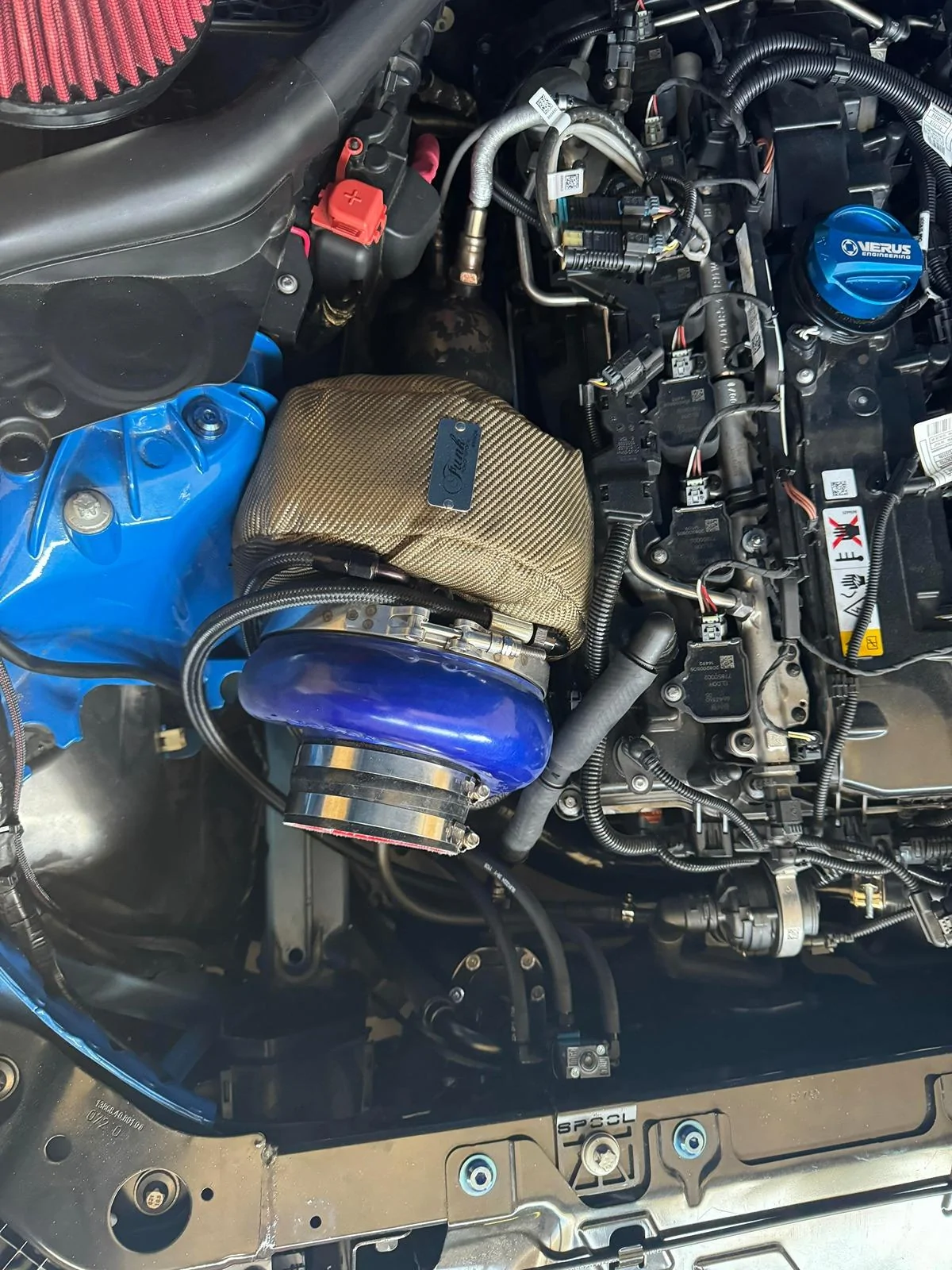

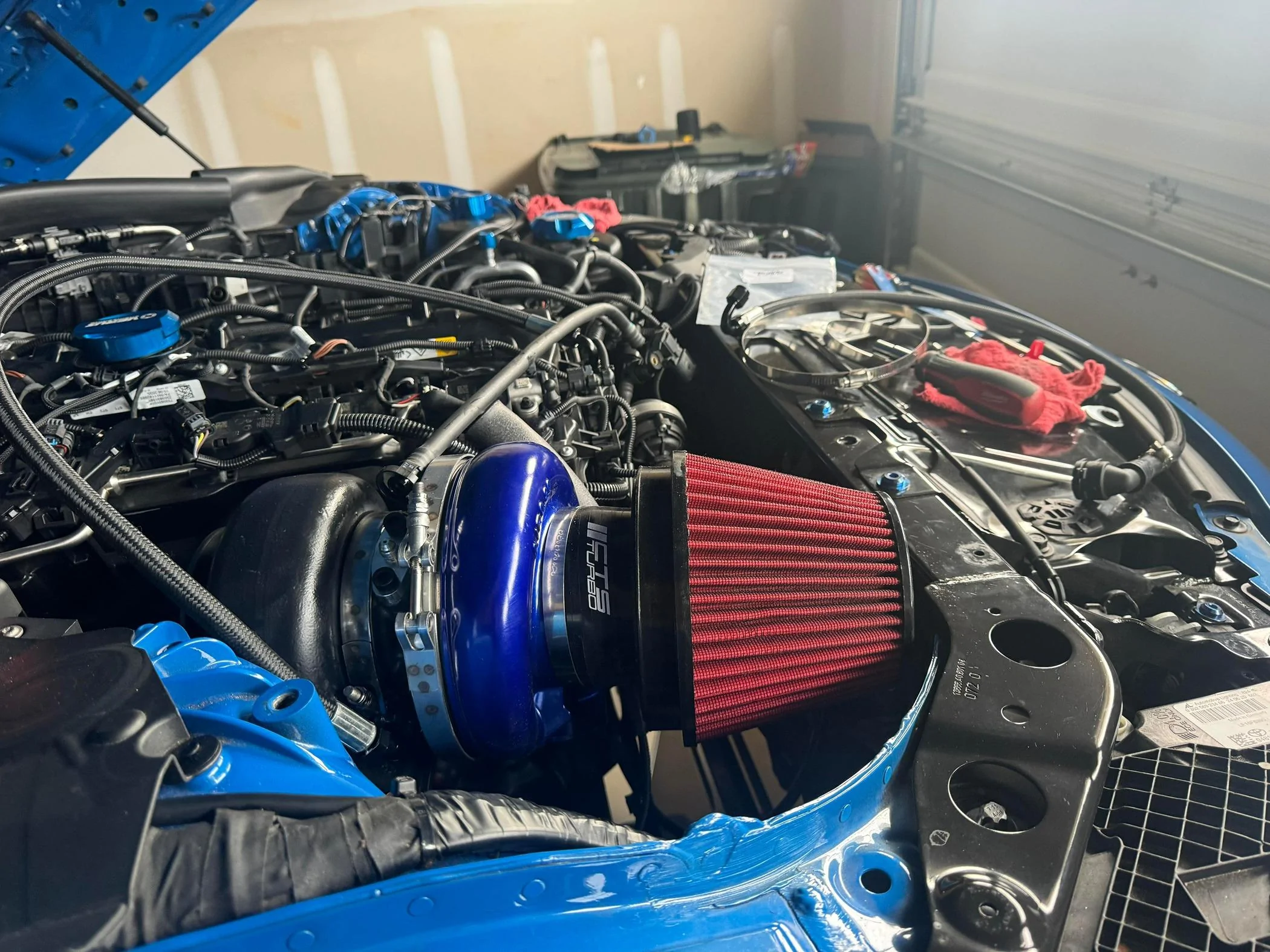

And I just noticed 2 port mentioned. Mine is 6 port.
So I have their 1200 kit with all the Visconti Fuel stuff. Its a great kit with a few little nitpicky details.
For the turbo studs and 2 of the nuts you have to slightly lift the turbo to get the nuts to start and it's in a tight spot between the strut tower and the manifold. I do have the huge 1200 kit so that may be different. I also had to take off the turbo to get my funk motorsports turbo blanket on as it was too thick to slide down between.
It's a 3-inch down pipe which wasn't that big of a deal but I have a 4-inch exhaust so I had to ride open DP to the shop to get it adapted.
The catch can just came with hoses and adapters with no instructions so I had to email them to see how to set it up and it reuses the old manifold clip. Wish that was a little better.
The oil feed line was too long. It's functional but I bought some AN Fittings and made some new lines.
Cerakoting was coming off of everything. Just scratching off super easy.
I'm still stock trans/motor. I have Botti tuning me here very soon, I am already on his base tune just waiting for him to be free.
