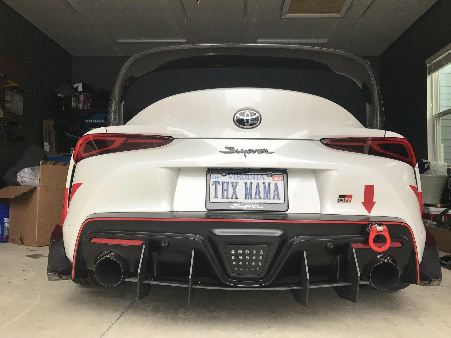

Looks like pieces of cardboard forced to fit.
they do include spacers that will help it look more straight. I was just didn’t put it on since I didn’t like the gap.

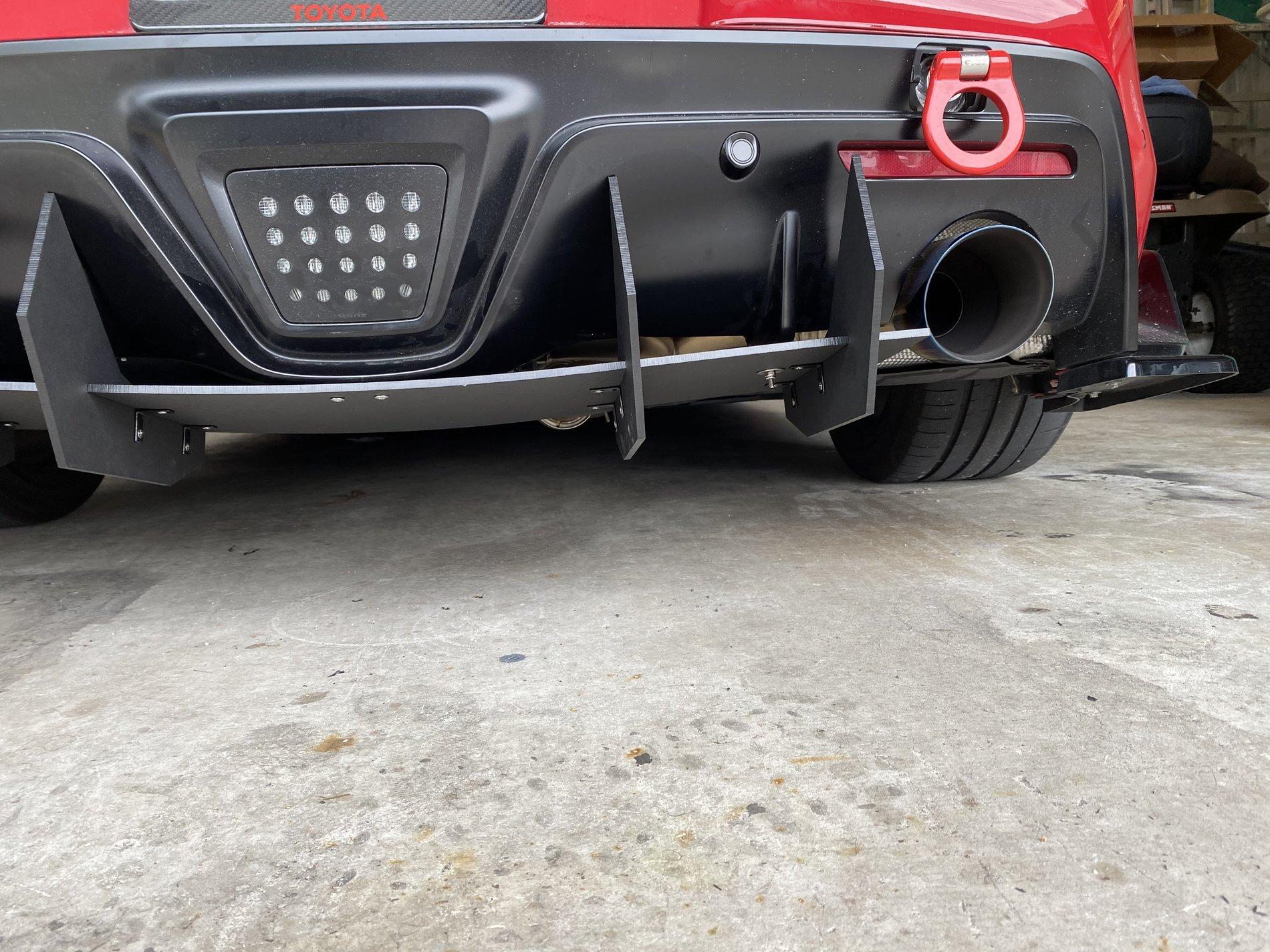

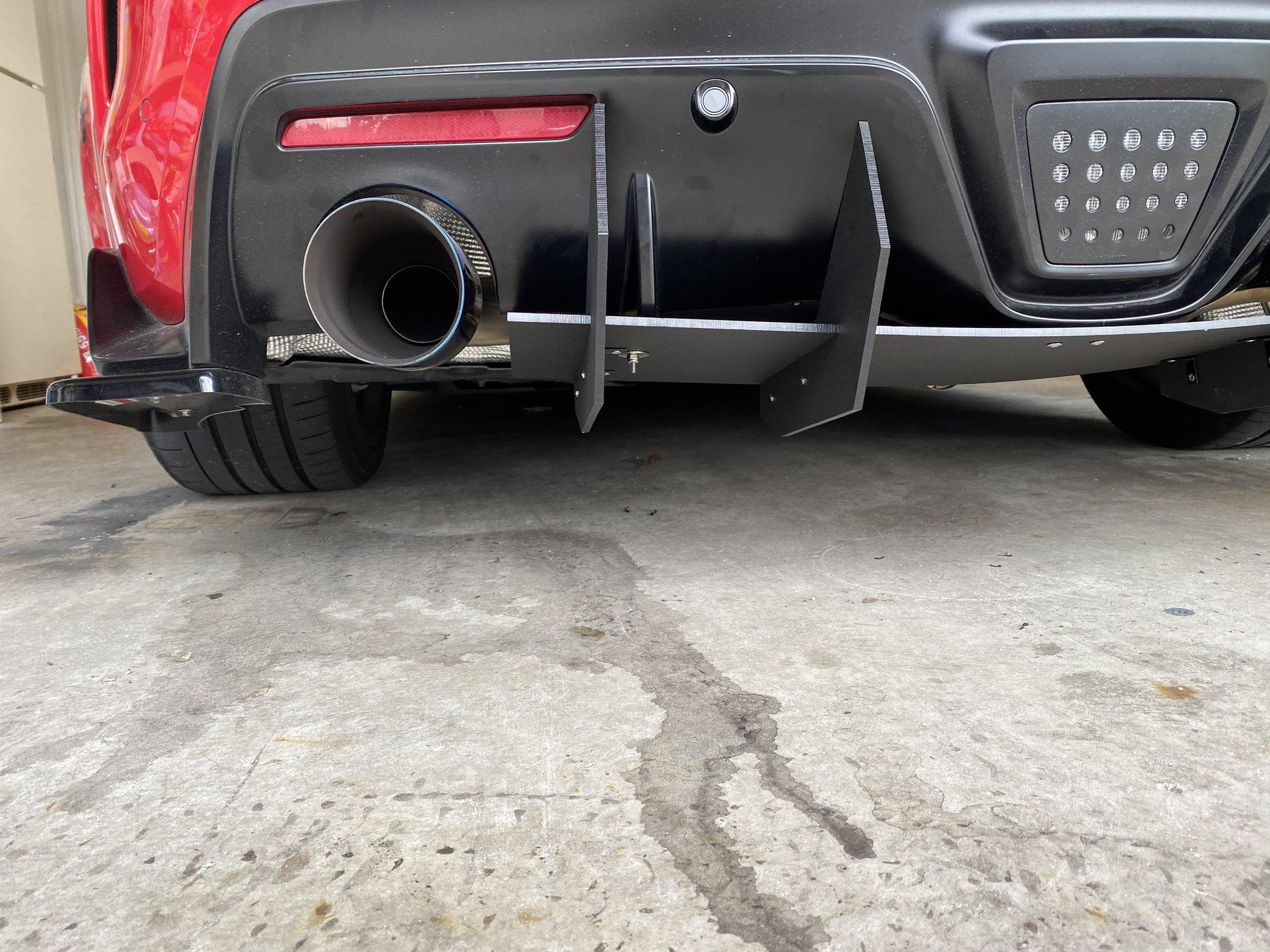

I was able to get it on thanks! Here are some pics

I have the diffuser. It was a simple install. LMK if anyone have questions or need photos.

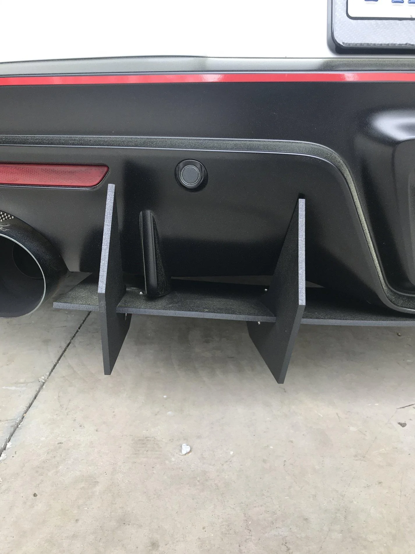

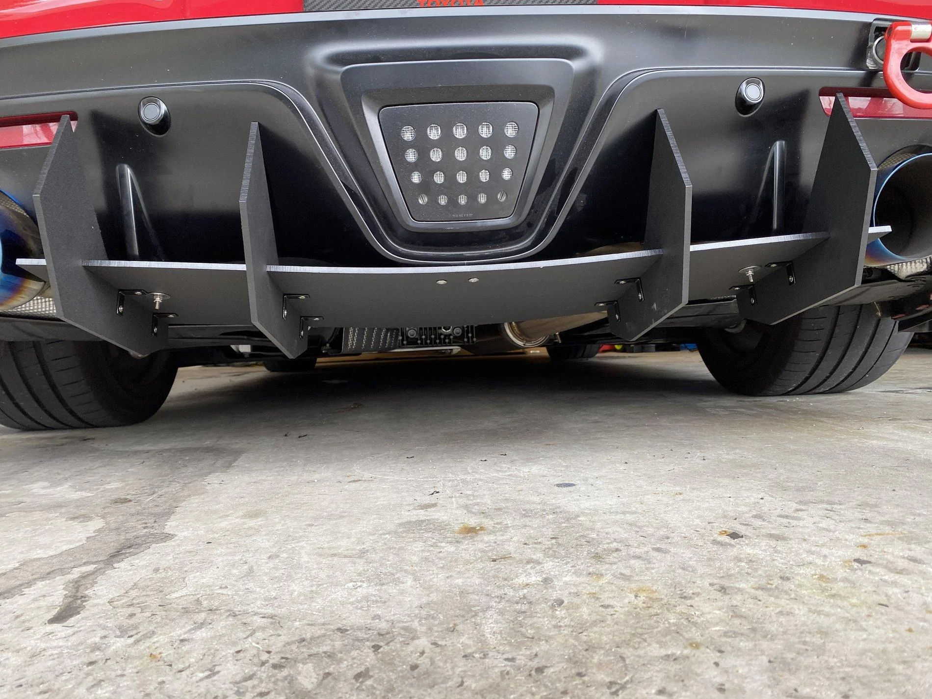

Yes! So it’s actually not that bad to install. I will say having no instructions doesn’t help lol. But I do recommend having an extra pair of hands helping you. The installation is pretty much up to your preference. There’s no wrong way as long as it’s even. I suggest using the oem fins for placement of the bolt on screw. I used the most lateral fins as u can see in the pics. Simply align your preference on the diffuser and drill your holes. It’s optional to use the bolts with spacers to avoid the curvature of the diffuser but again that is up to you as most here didn’t seem to like the bend. Also optional to place one or two self tappers in the middle like I did. And that’s it!

Oh! Sorry! I forgot to mention the self tappers are included in the kit :)
