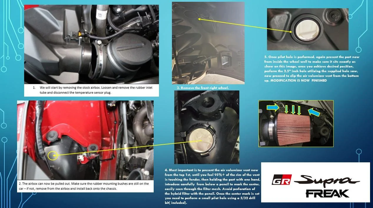

I dont have the tools to do that, BUT 1st lets just for a second compare the distances the air need to travel from both apertures to the actual filter ,2nd size of the apertures and 3rd and most humble lets add a little common sense to the equation. ORIGINAL OEM filter/BOX its basically designed to breath through that small aperture while all components are connected in a pressurized enviroment. Once original air seal/design is compromised, you have an air filter that not only struggles, but will also sucks hot air thats abundant specially in the engine bay, hence the reason for cold air intake manufacturers to add a heat wall, to claim and achieve their marketing/bragging results. REMEMBER THE SPEED THE AIR TRAVELS through THAT WHEEL WELL WHILE IN MOVEMENT AND FROM HOW MANY OTHER places the same feeds from REAL COLD AIR @ LEAST AMBIENT, ADD THAT YOU WILL REPELL any WATER AND THAT WAS THE LOGIC for creating THIS MOD. If you know someone in or close to Tampa Fl. That would offer me a free run on their dyno,that has this tool needed to prove my claim, I will bring my car for test run,Im willing to be embarrassed by the results and will also offer a full refund on all customer claims.Just the extra sound from the Turbo speaks for it self, Im actually more inclined to think and believe deeply, that once the mod is performed, that filter will actually breathe more air from the same than from the original design!
