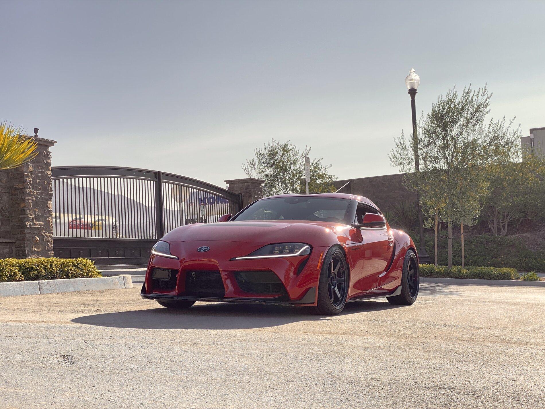

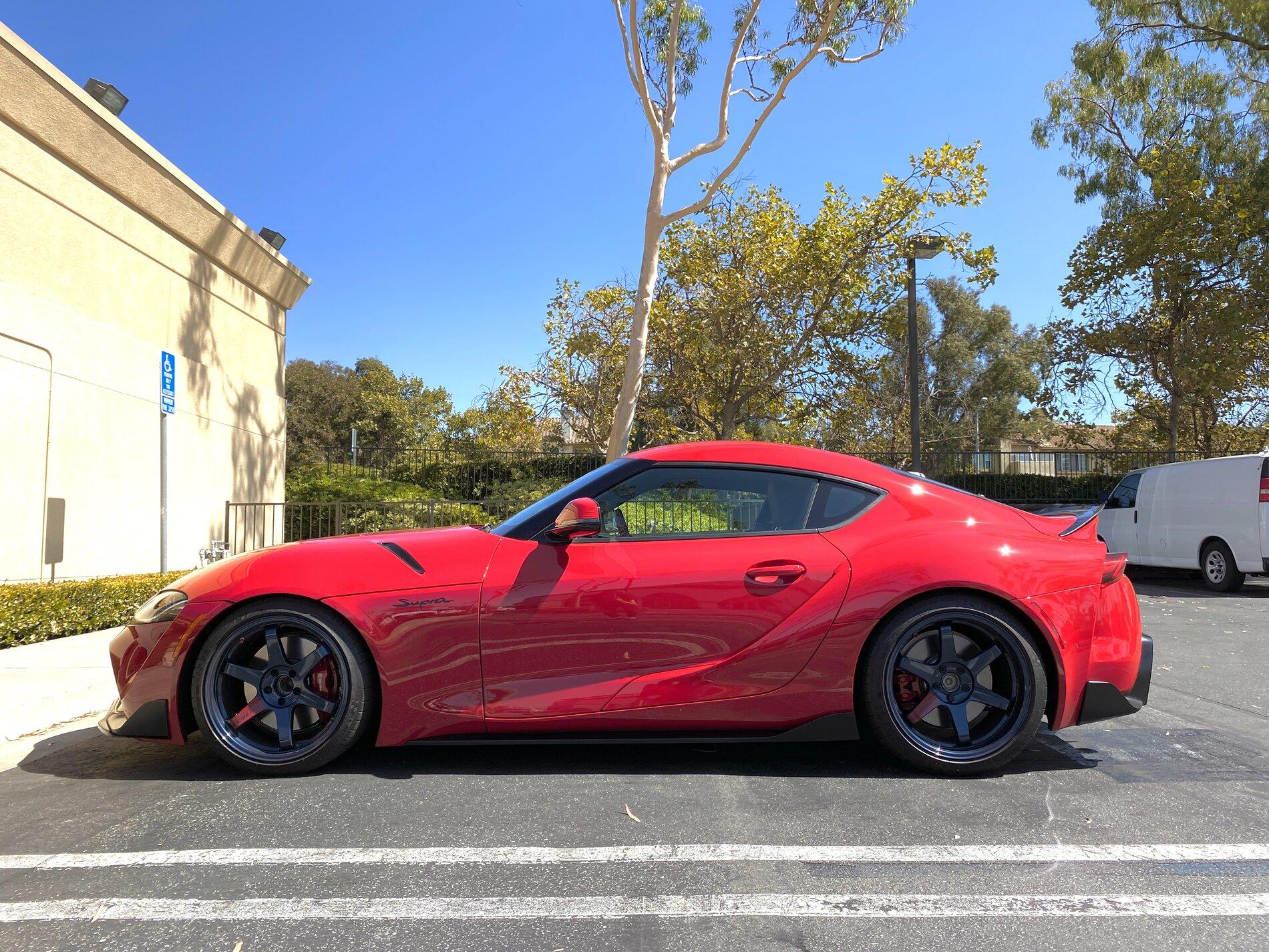

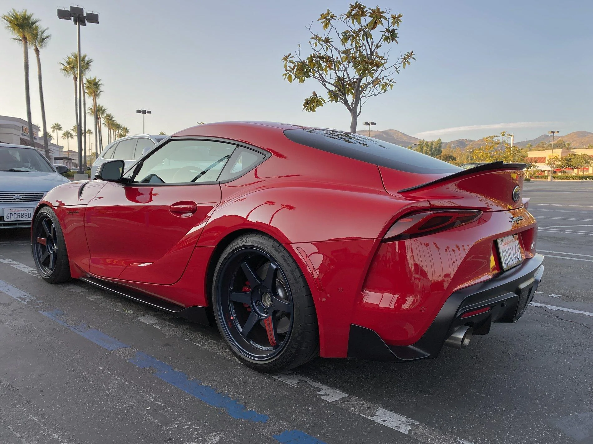

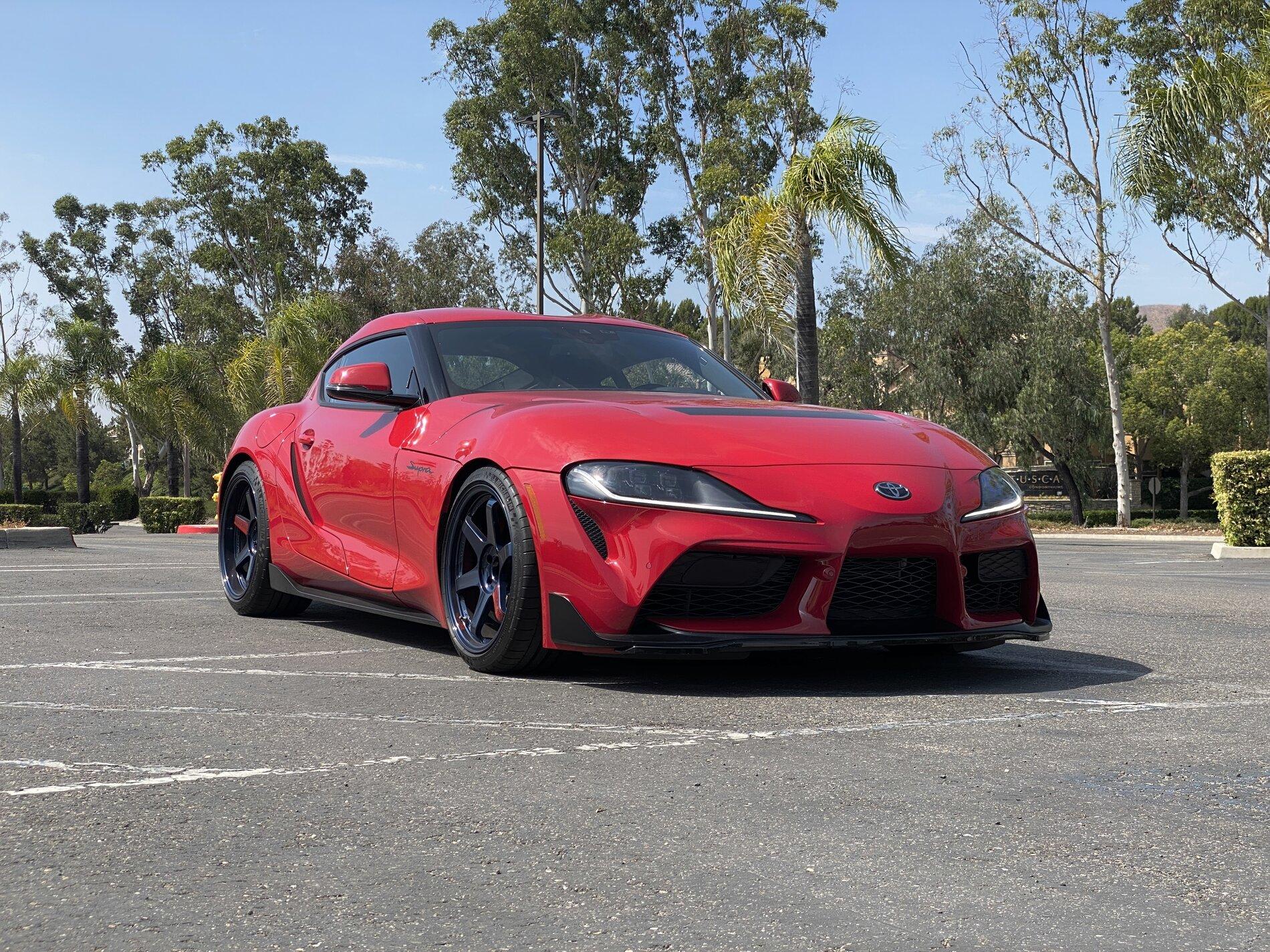

These 18s or 19s? Look amazing.
19”s in 19x9.5 et22 and 19x10.5 et35
The rear is sinking in a little too much, because Rays anticipates you to install a wider tire in the rear, thus eliminating the sunkin-in look and filling up the rear fender, but with stock tires I might add a spacer on the rear.

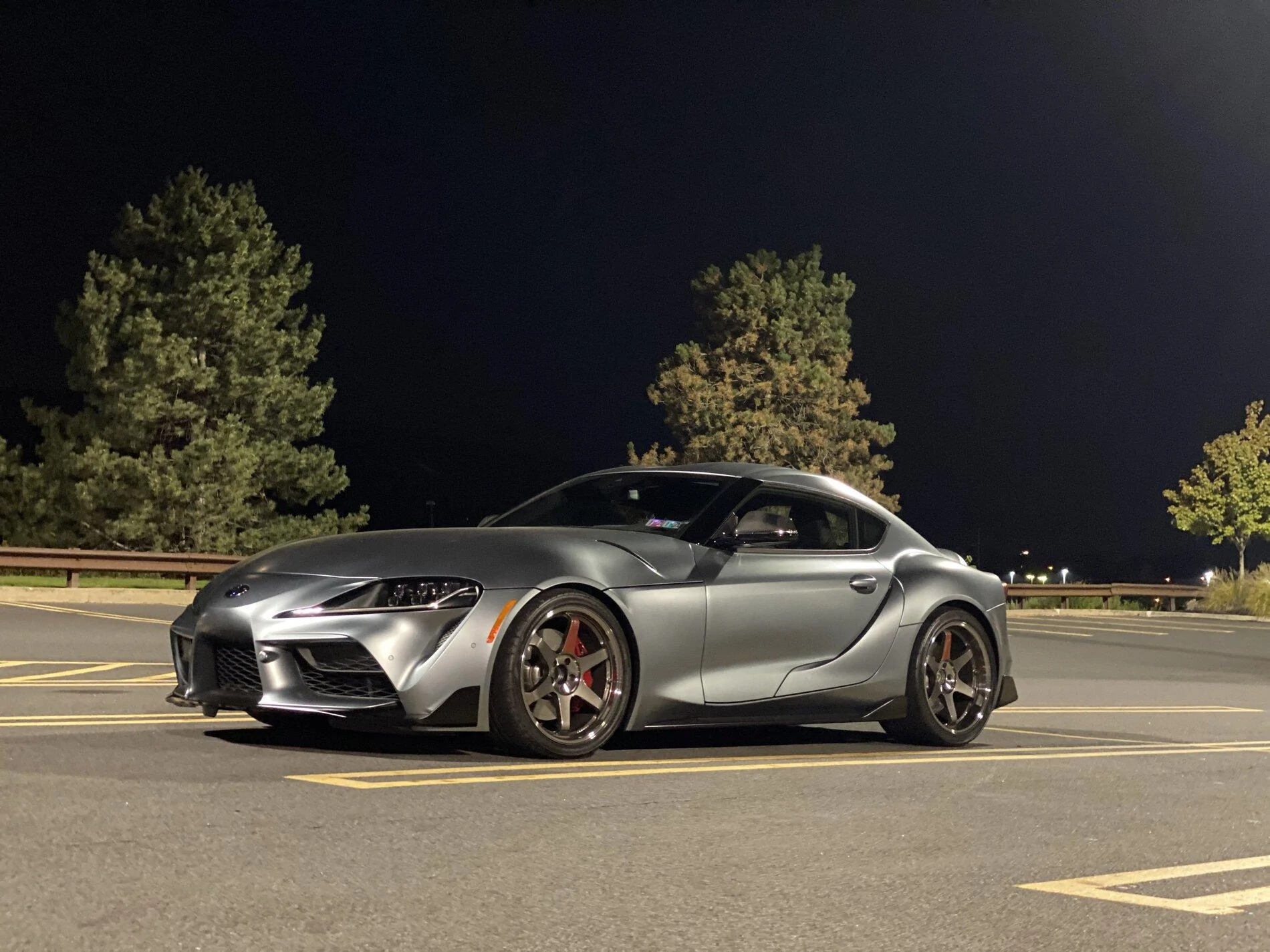

I had Rays Engineering share my car ! Pretty cool I think it’s the only Phantom Grey on pressed graphite TE37s
