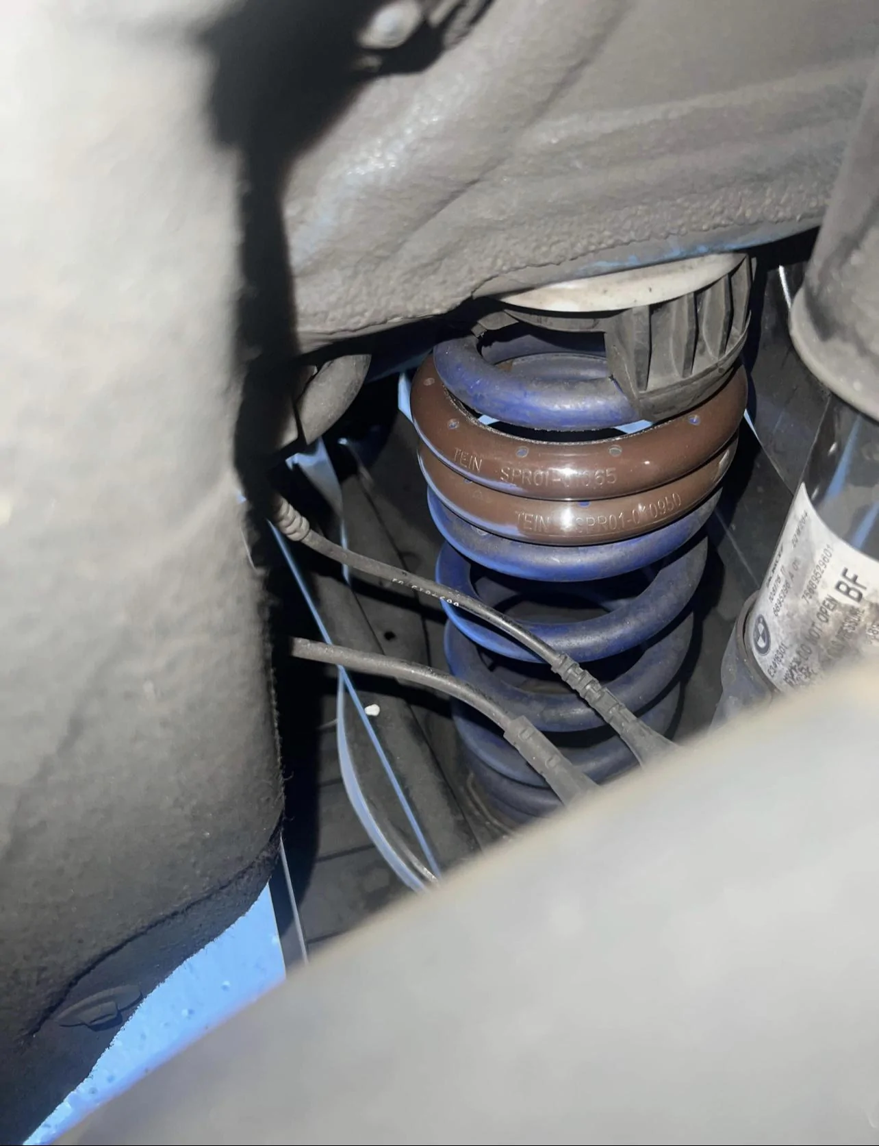

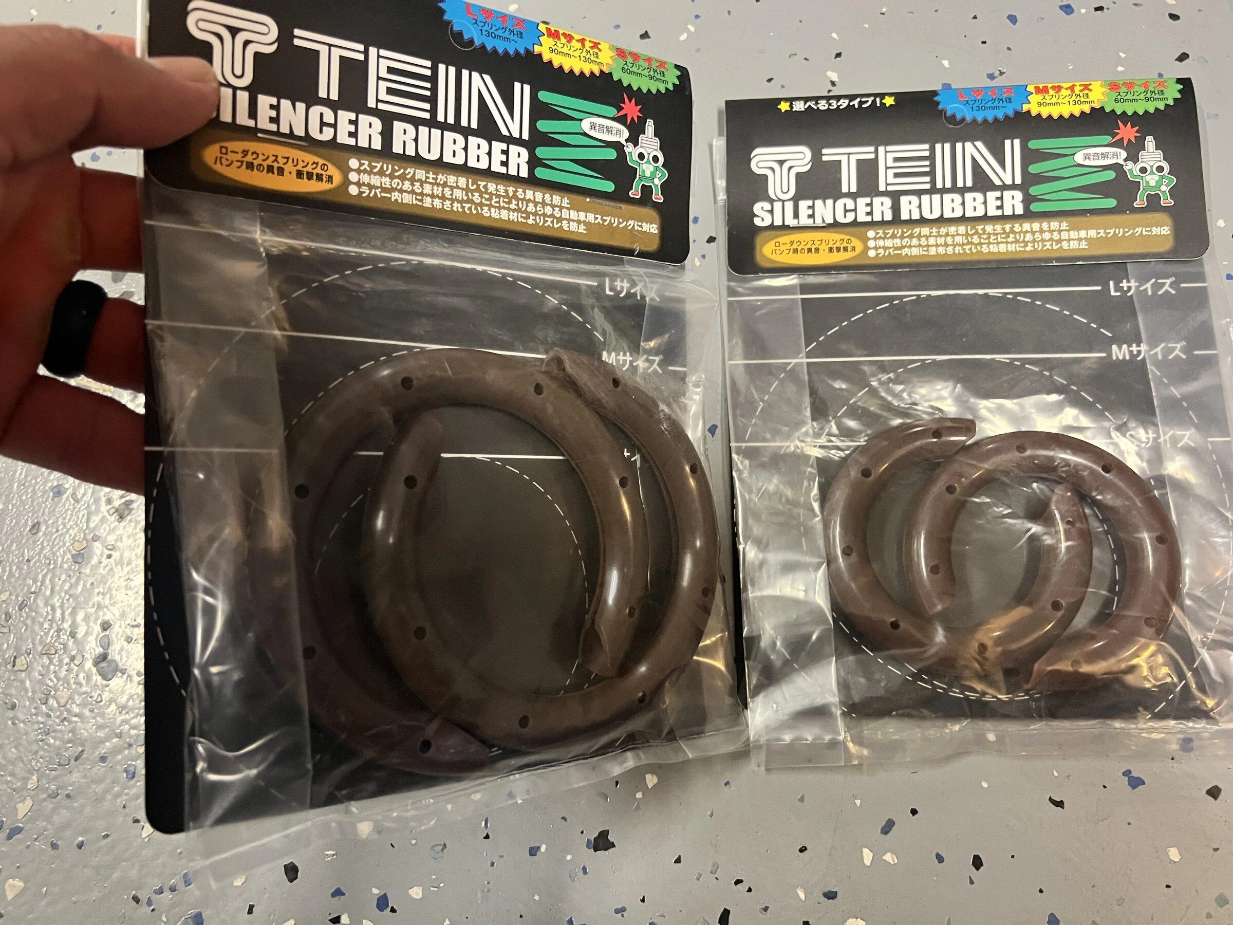

If you lowered your Supra on H&R or Eibach springs and have a metal on metal click/clunk when you drive on rough roads, this is your solution!
I bought 2 extra sets (can’t return them) since I didn’t know how many I would need so these are up for sale.
These $30 rubber sleeves have finally silenced my car.
I installed one small and one big sleeve on both sides of the rear springs and now my supra is quiet. I should have done this a year ago.
New. $30

curious to know what part of the springs does these sleeves go in to?

Did you need one set per side? I'll take them if still available. PM me. If they are sold please tell me where you bought them. Thanks!
i used one set per side. I bought one of each size medium and large (since I didn’t know which would fit better.) the large size fits easier imo. On the pic above, the top sleeve is the medium and the bottom one is the large. Car hasn’t made a sound ever since.
Amazon: search for “Tein silencer” about $13 per set (buy 2)
