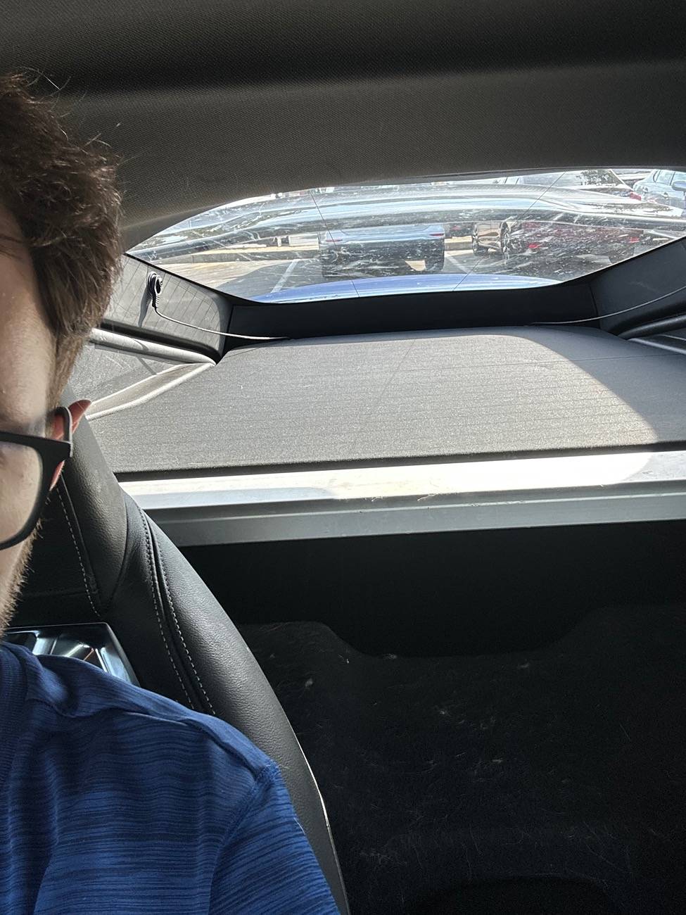

Planning on getting back under it and triple checking the contact points. I can say though that a small thing I tried that I was surprised by is I was originally running without the trunk cover because I wanted to maximize trunk space, upon putting the trunk cover back on it removed the worst of the harshness.
Assuming I don’t find any bad contact the next time I am under the car, I think the simple answer might be that the harmonics of this exhaust system weren’t really designed with having the trunk cover off in mind. The fact that putting in this cover helped so much, to me indicates this might be less of a physical contact thing and more of an acoustic tuning thing of the cabin thing. Will let you know if I find anything else.
