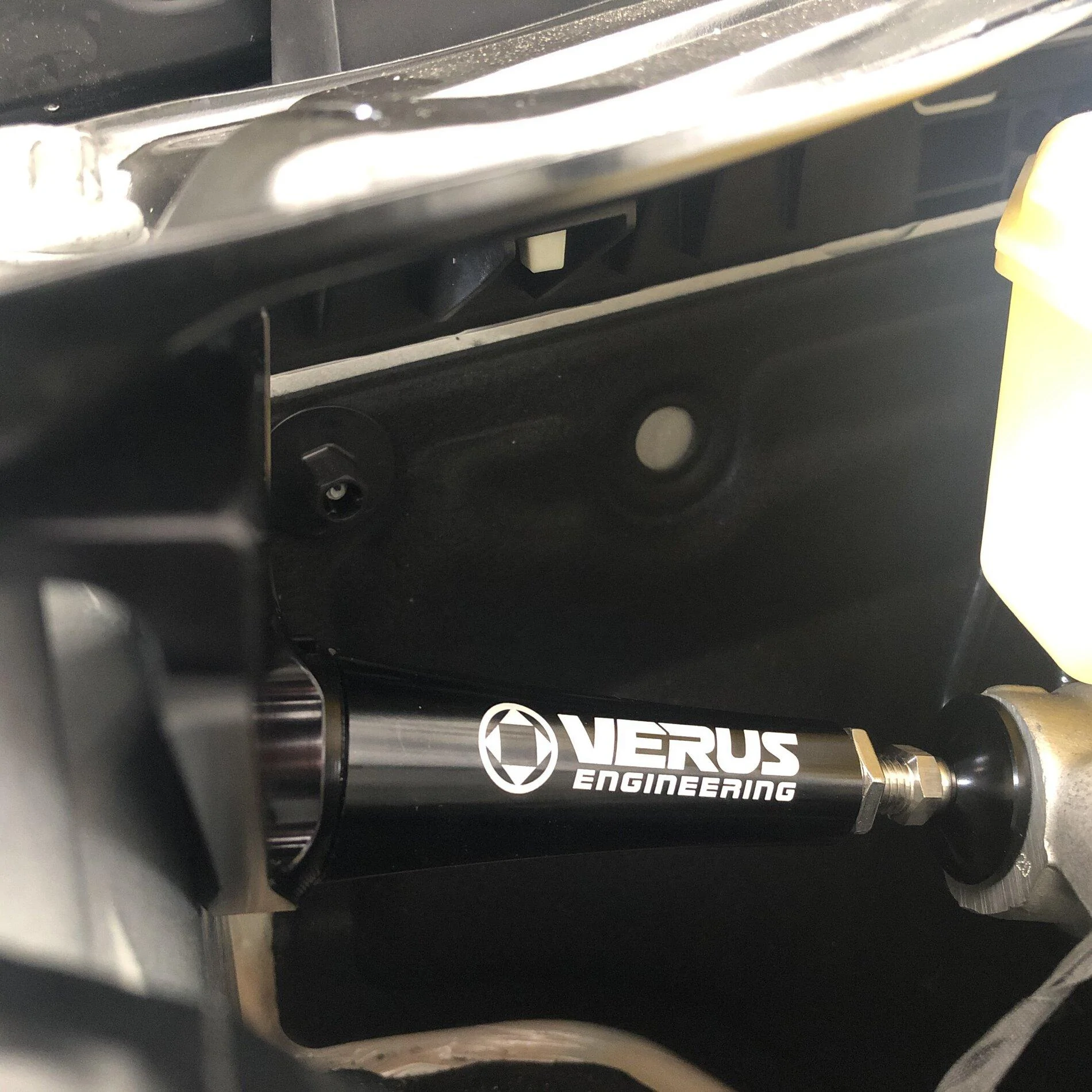

Quick 15 minute install. I added a little low strength thread locker to the 3 button head cap screws that connect the bracket to the arm. Perfect fit and probably won’t feel any difference on street but it makes me feel good knowing it’s there

Have you noticed any firewall flex on the Supra?

I wound up installing this kit myself and then I forgot that it was there until I did my first hard braking stop. It was instantly apparent to me that the master cylinder brace was there and doing its job. Removed a lot of ambiguity in the brake pedal.
I wouldn't say it was a mushy pedal before, but after the brace was installed, the "springiness" of the pedal under hard braking disappeared, which I'm now guessing was firewall flex.
Well worth the small investment.
