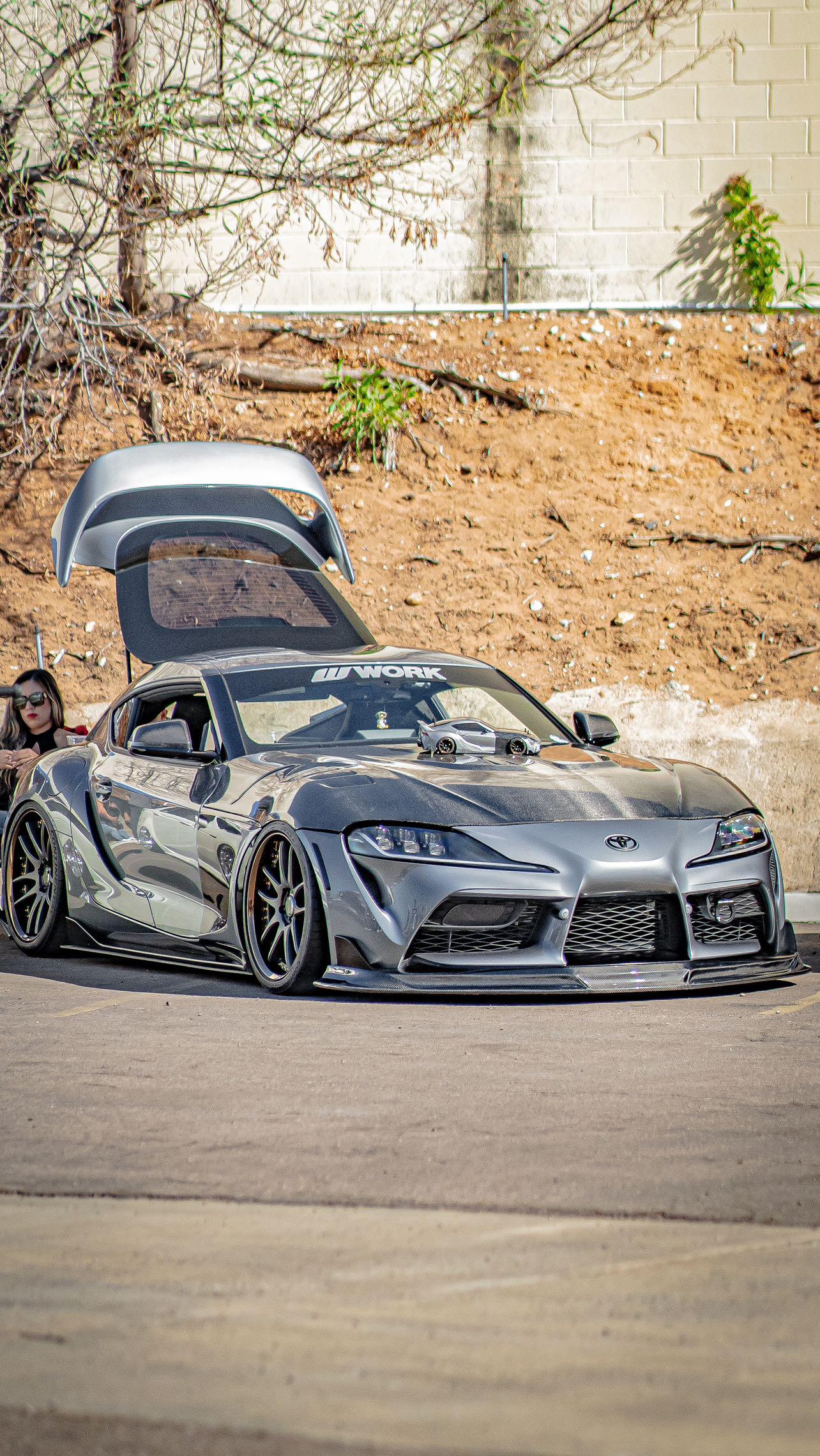

I’m running those sizes with et+21 front, +35 rear rims. Rear will clear no problem. Fronts on the other hand, can only clear not even half the sidewall of the tire which is fine with me. If you’re looking to tuck all the way, prob want to go with a less wide tire or a rim with a little less offset.

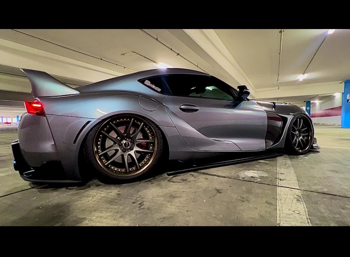

Shot off the rear aired out almost all the way.
