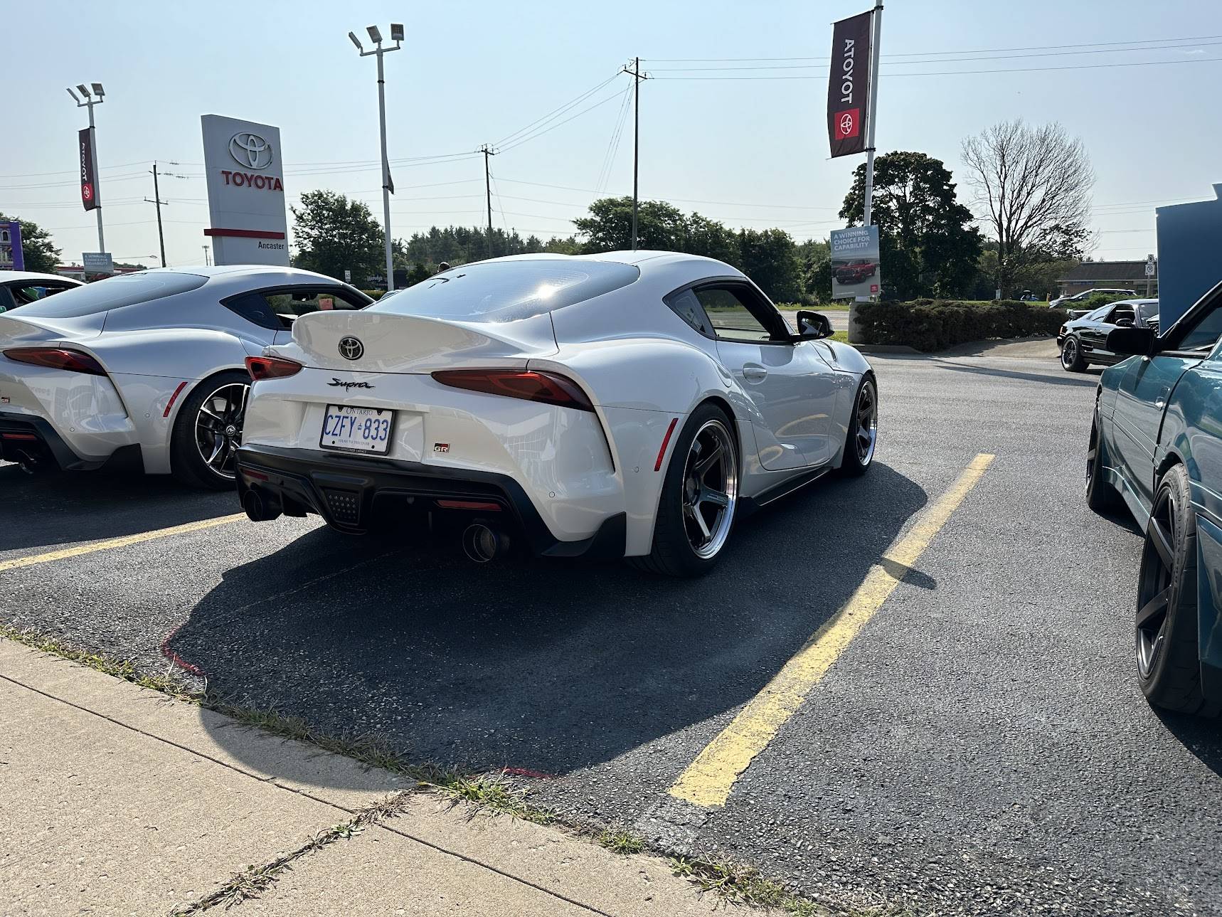

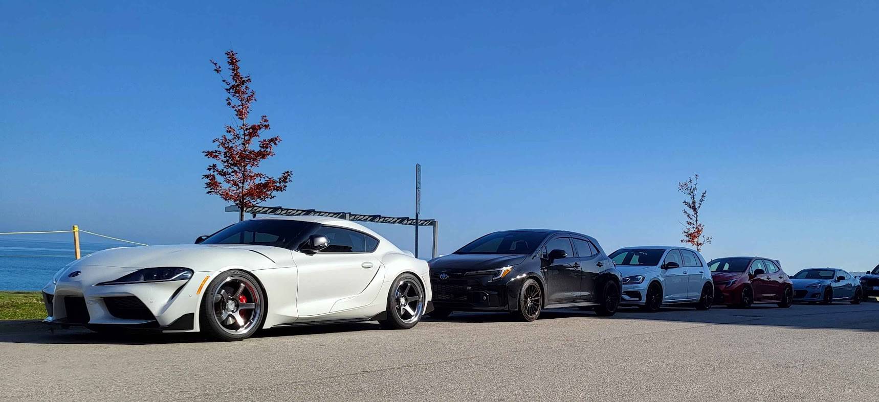

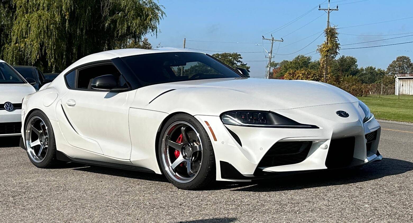

I have Advans in those spec on 265/35/19 Front and 285/35/19 Rear using ECS02's. I'm also lowered on Eibach springs, no rubbing issues here.

Plenty of options available in 265/285, at least in the 300TW class. Stock wheels are 19x9 and 19x10 with 255/275 so adding a half inch of width front and rear just seemed natural to add 10mm wider tires.
It also means that the diameter of the tire is very similar to OEM and the front/rear ratio is very similar to OEM. At least with ECS02's it doesn't look stretched at all imo, it looks pretty OEM where 275/295 looks a bit chunkier
Nothing wrong with either sizing, both work perfectly well
