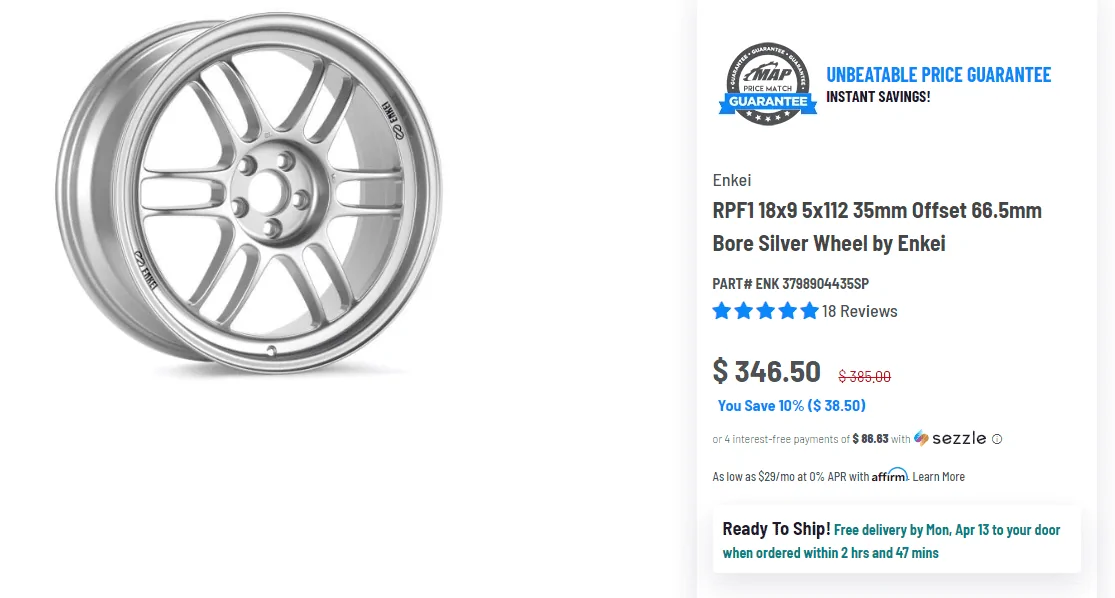

Anyone know if the 18x9 Enkei RPF1s will fit over the front brakes? They're the correct bore size and bolt pattern.

They didn't fit over my STI Brembos without a small spacer. So if the Supra calipers are similar in size, I'd say no. The spoke design got in the way. See if a local BMW/VW driver has them and test fit.

If you can't find someone with them locally you could always purchase a single wheel, test mount carefully, and sell on ebay/CL if it doesn't work. Sure you might lose a few dollars in the process, but better than on a whole set. I've done that in the past and it wound up being less than $30 to know for sure. It is a real hassle however.

I am pretty sure it will fit with that offset and width. The front Supra brakes are large, but not big brake kit sized. That model is also aimed at BMW M-spec cars, some of which have identical brake calipers to the Supra.
Also, Supra stock wheels are forged and quite light for OEM, they are probably not bad to have banged up on track before looking for alternatives.

It's not about the size of the caliper, but the width. They hit the spokes of the wheel (on an STI with Brembos)

If I remember correctly, the STI needed a 3mm spacer up front to make them work.

If you are moving from 19" to 18" the length and height of the brake caliper affects the fit as well.
