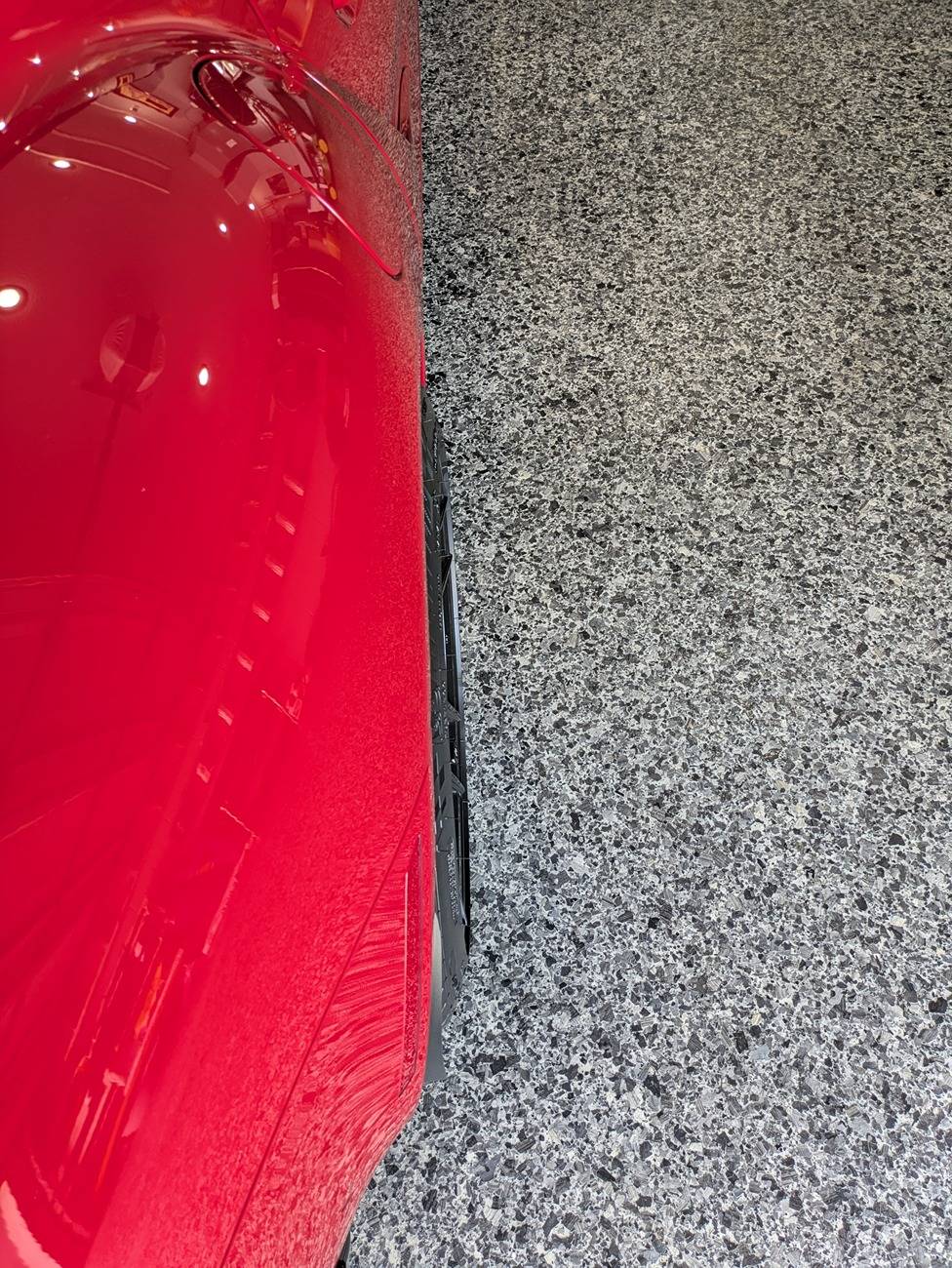

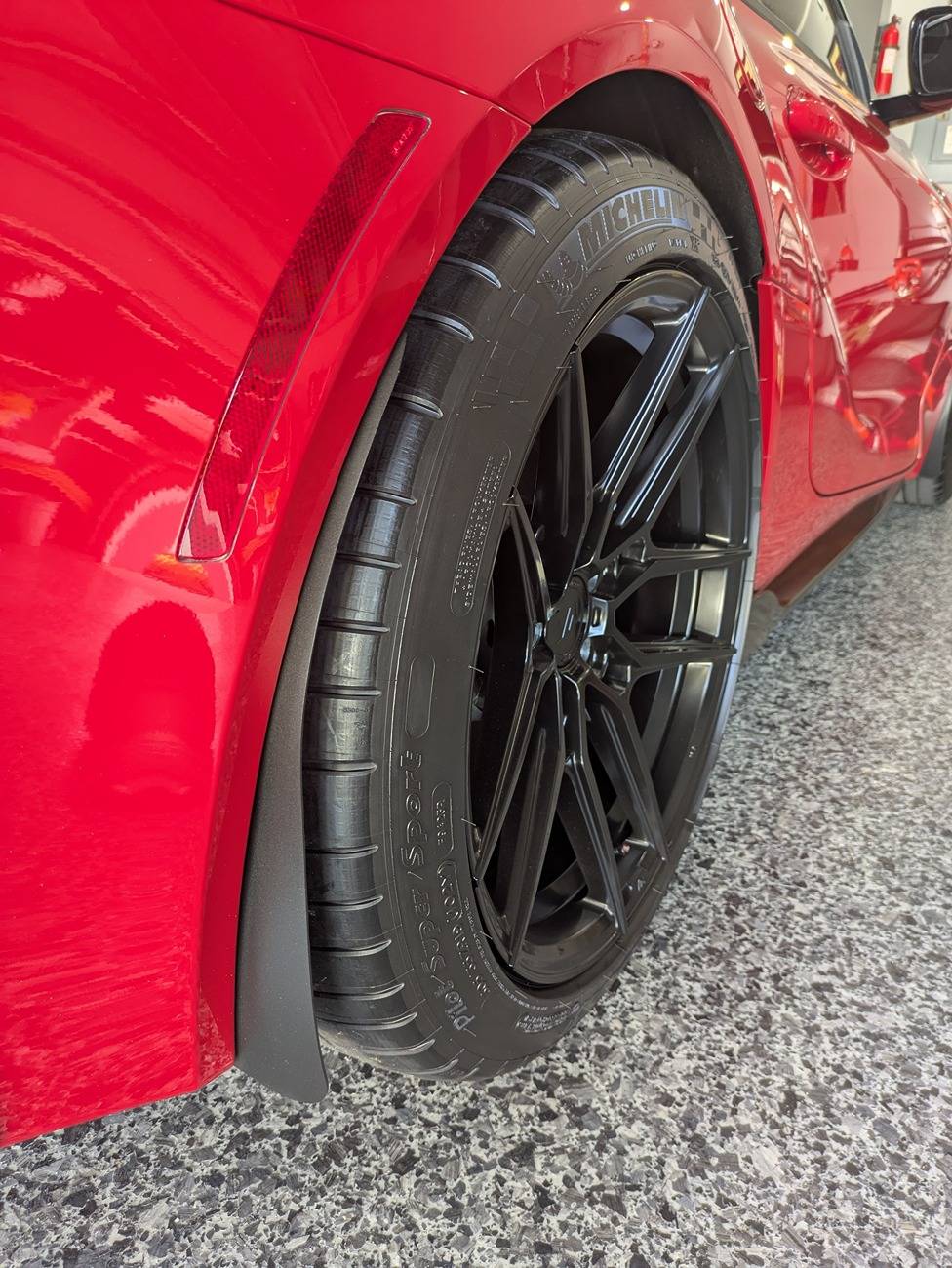

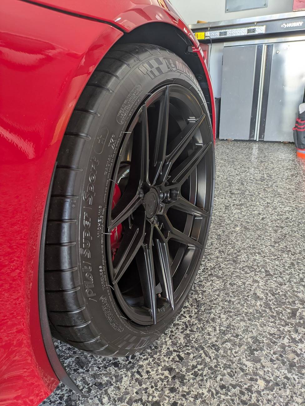

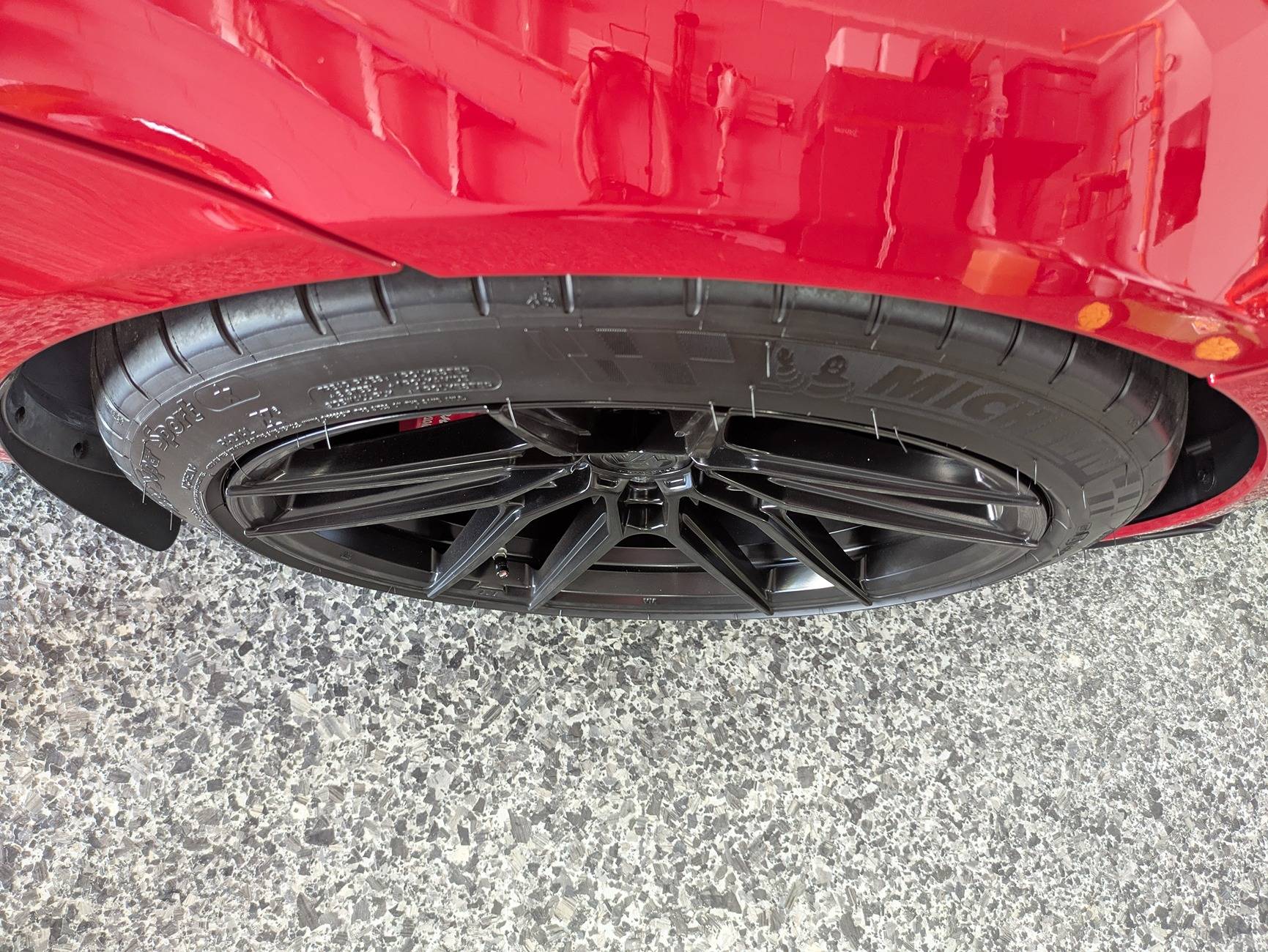

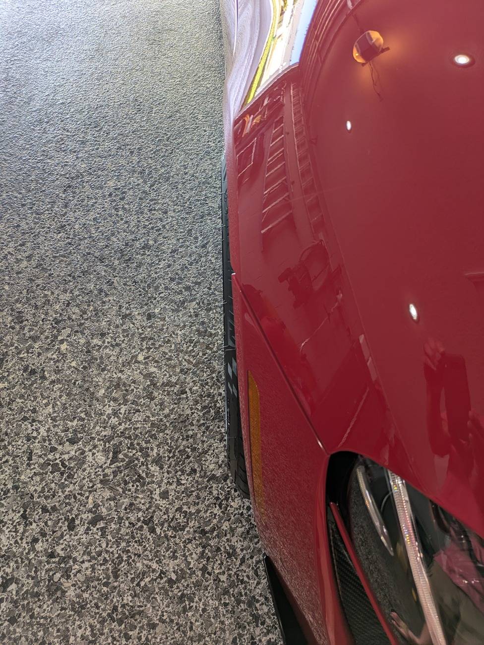

Just installed on stock suspension
19x11 +37 305/35/19
19x10 +26 275/35/19
No rubbing issues
