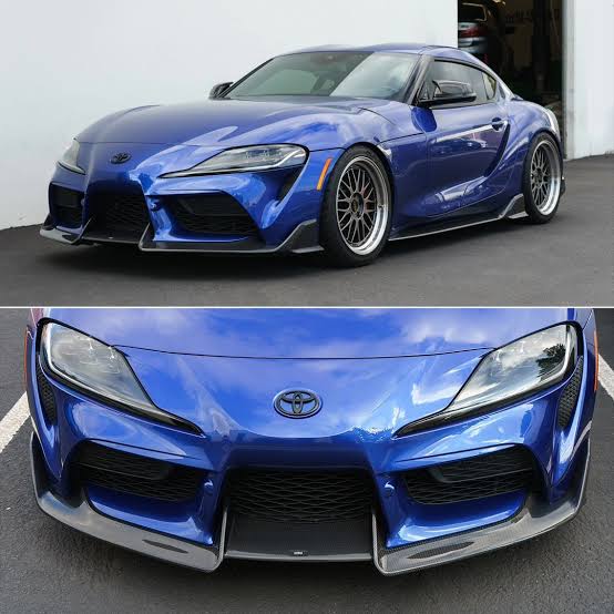

Would it be possible to mount the Verus front splitter to the adro v1 front lip?
Roy
Jul 14, 2025
Orlando, FL, United States
2020 Launch Edition Supra
I'm looking to get a new front lip since mine has eaten some nasty scrapes and rock chips over the last 2 years, and I love the look of that adro lip.
My only issue is that I know the downforce is questionable at best and I'm planning to eventually go verus or something for better performance down the road.
Would it be possible to get the best of both worlds? 🧐

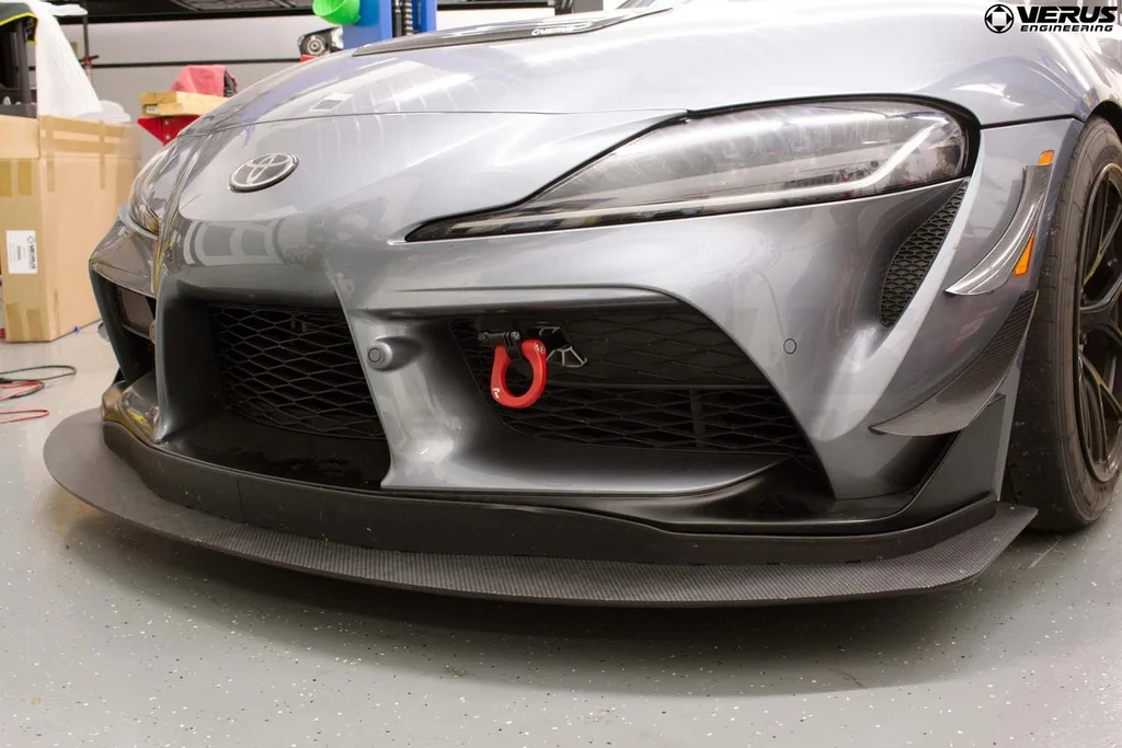

I assume it could be done .. how much lower is the adro lip? The only adjustment to the verus splitter would be to the airdam unless you plan to space the mounts or make new ones.

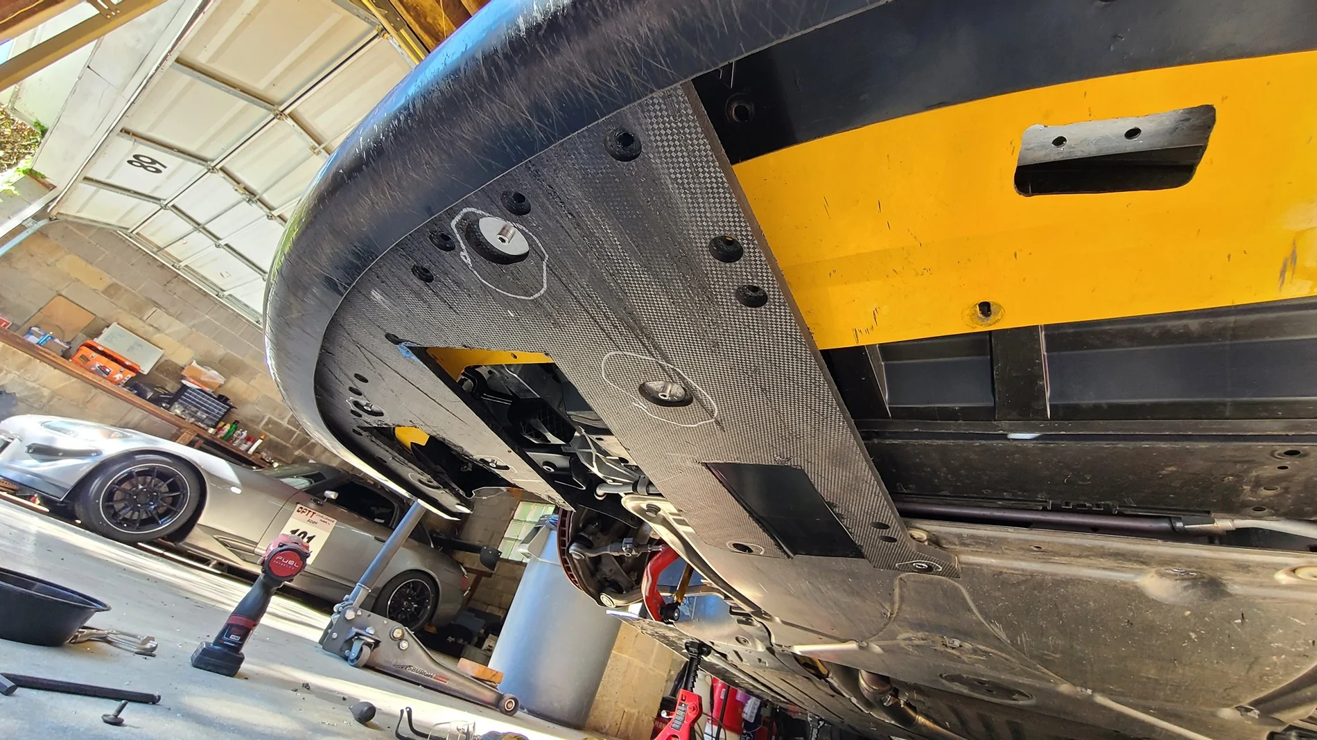

Something to note, the verus splitter fits perfectly inside the gt4-style lips.
You can see here the standard verus splitter (albeit cut up for vents) fits in the gt4 lip. Aero wise it maybe isnt the best cause you'd need to smooth out that transition from the lip to the splitter, but better than nothing.
